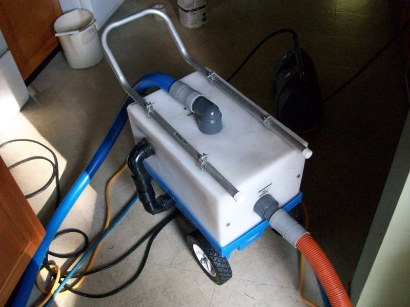

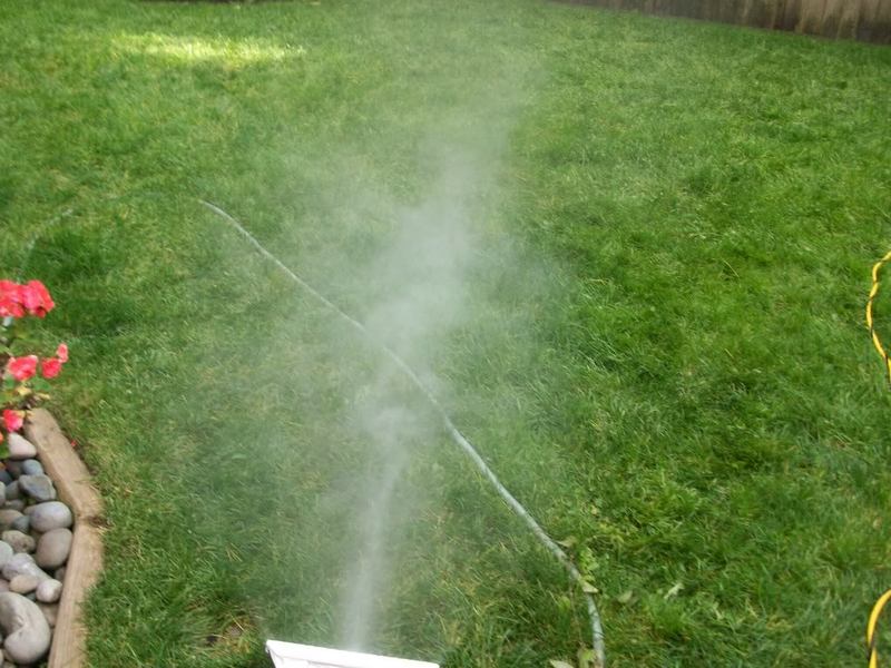

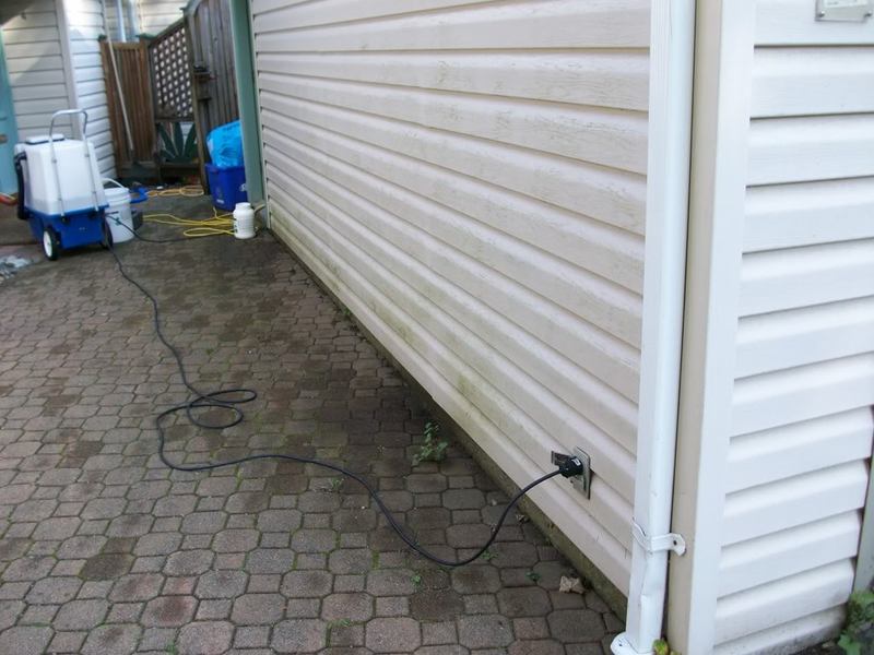

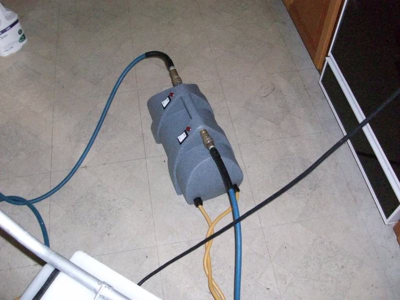

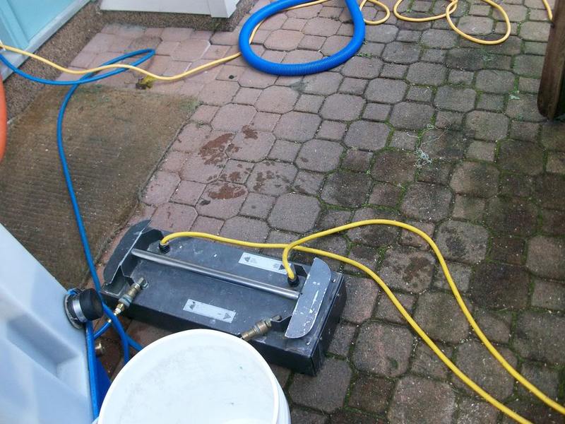

Here's what 7 separate circuits will get you- 4 vacs, pump at 400 PSI, 6500 watts of electric heat. Usually one is good, I thought I'd try 2.My upholstery tool was so hot I couldn't hold it anywhere near the metal. The wand tube was toasty with the water keyed open too. This was a buddy's place and he let me play. We ran a lot of cords :lol:

I don't normally do a 7 corder, but this was a buddy's place and I wanted to experiment. Set up was about 10 minutes or so. Usually I just run one heater, but I wanted to see if it made a lot of difference to run two. It was marginal, but I keyed the wand open for a full minute and the fittings were still really hot. 5 cords are easy, but 7 , well....

For the most part , I only fill maybe twice, hard to get consistant chem flow with most auto fills, and I'm working on a pump out. The splitter sounds like an idea though. Now I put the main plug from the machine to the kitchen counter wall outlet, the other to the stove. The washing machine plug is usually dedicated and most places here have another circuit in the bath. The booster only gets used if I have an upper floor to do or a large area, but I mostly concentrate on high rise work. I'm going to post pics of the vorninja tomorrow- you'll really like that.
