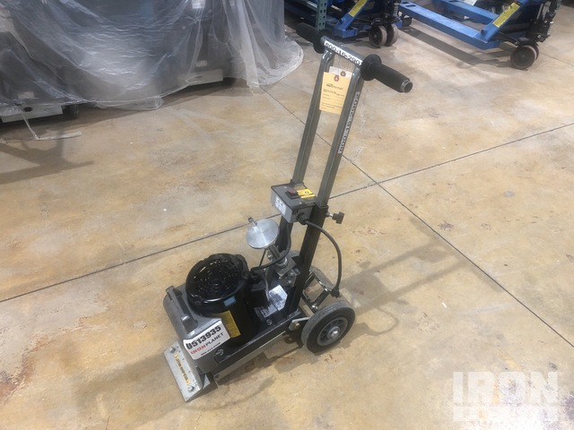

we rented a floor scrapper too.
it was still a b1tch

Taking up sheet floor sucks bananas. It might been easier with a floor scraper, not a scrapper.

Willy, we scraped and scrapped the old vinyl :lol:
