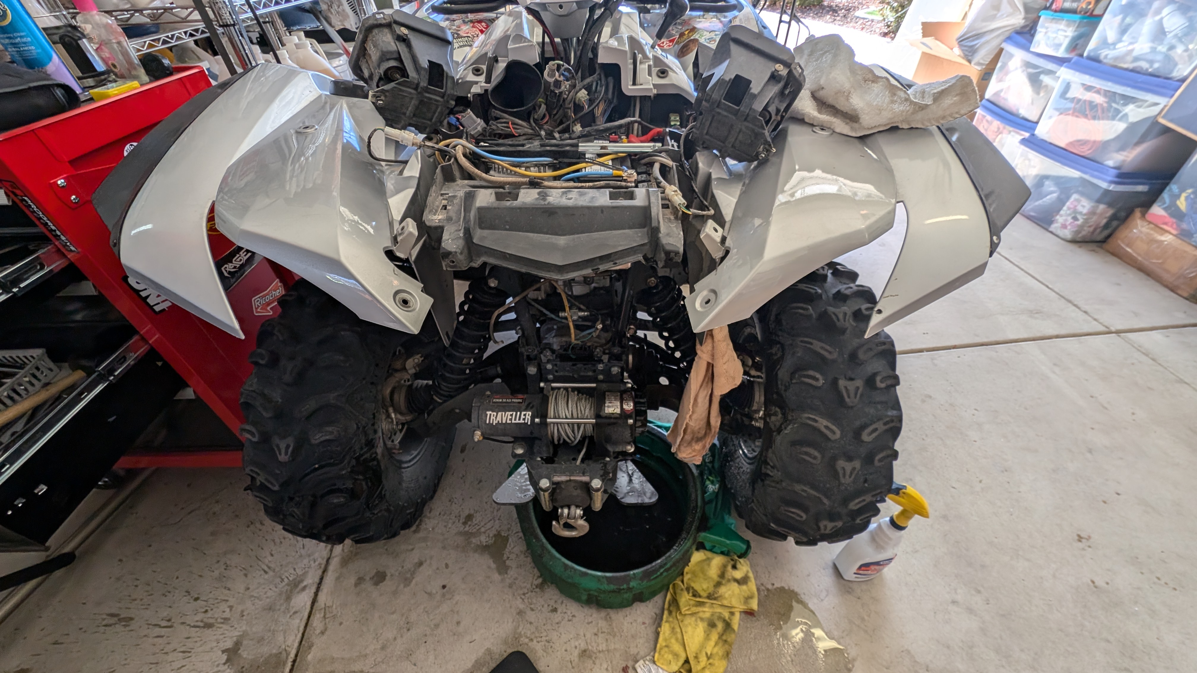

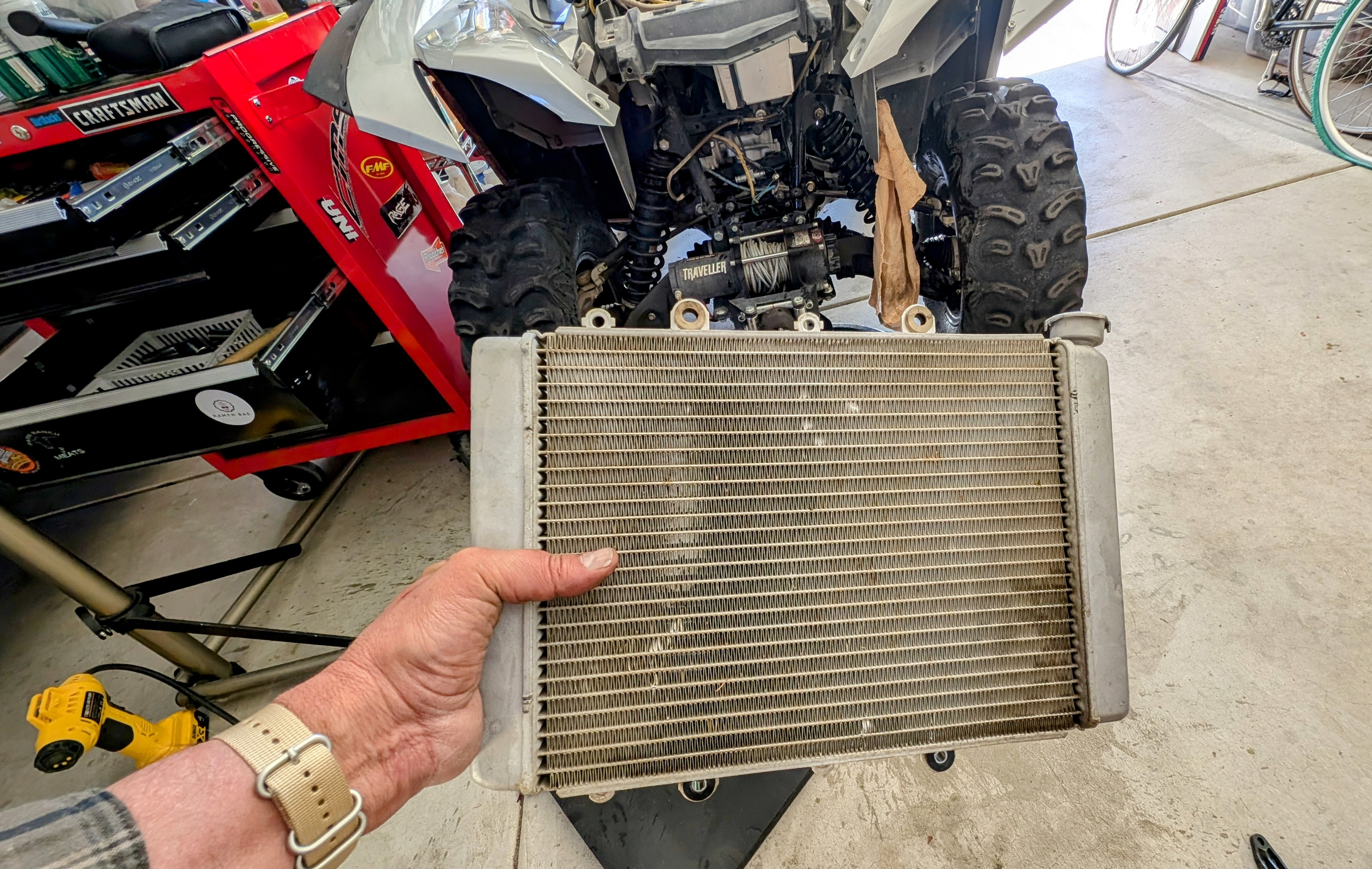

I'll fix it for you... PXL_20241019_200604013.jpgPXL_20241019_195600087~2.jpg
