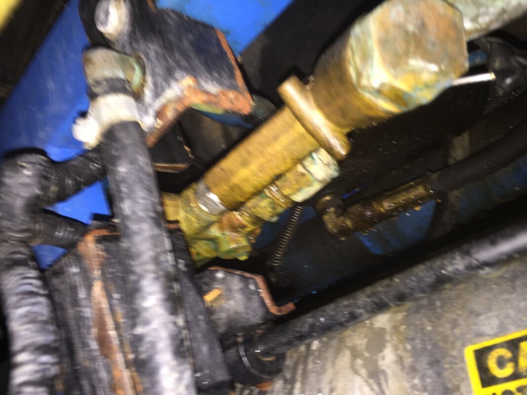

It's leaking underneath behind heat exchange above black back hose in photo like a water fall can't see actual break

Not your return line from the bypass. Probably just a blown high pressure line. Maybe coming down from the helicoil. Could also be the line to the bypass solenoid.

I think it's the helicoil line because it runs right through were the flood is coming from
11,531
The water is pouring out behind oil drain line on oil pan in middle of machine
If its the one from the Heli coil to the Heat Exchanger the part number is 10-805375 hose,HP 3/8 x 26

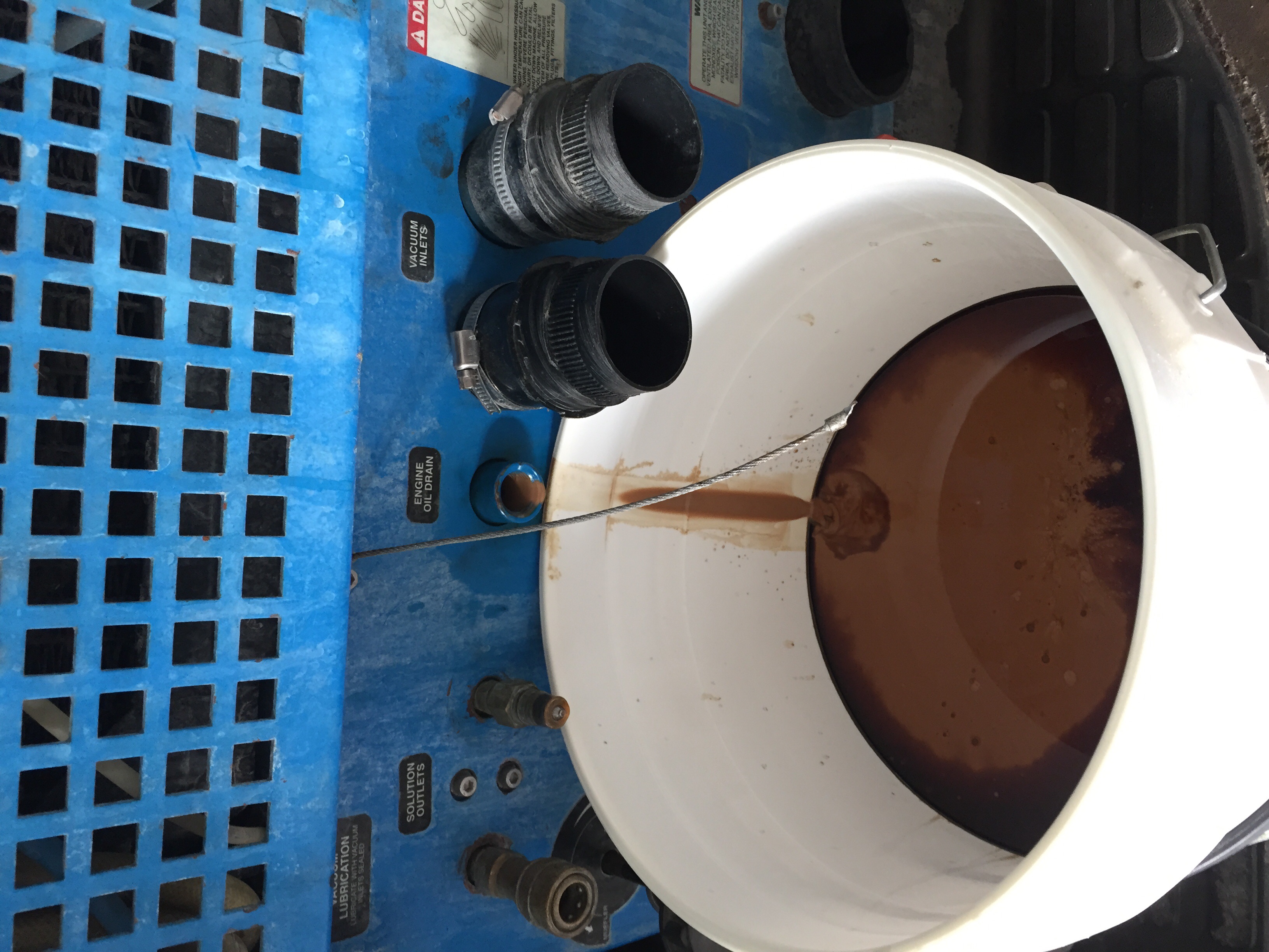

I pulled spark plugs, drained oil and threw out oil filter and I got 3 gal of sludge in a bucket letting it sit for a few days then new spark plugs and an oil change. Anything I'm missing????? I was told I might have to do the oil change 2x to get it right
D
dgardner
Get it running as soon as possible to heat up and boil off the remaining water. After running it for an hour or two I would change the oil again and call it good. The main thing is not to let it set with water in the crankcase.

I would run it with the original plugs until the final oil change unless they're completely gunked up then change them. But I would do so only once either way.
