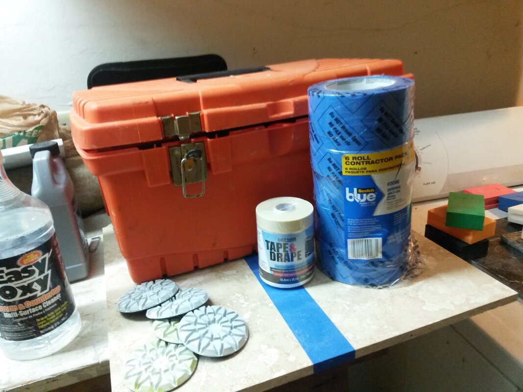

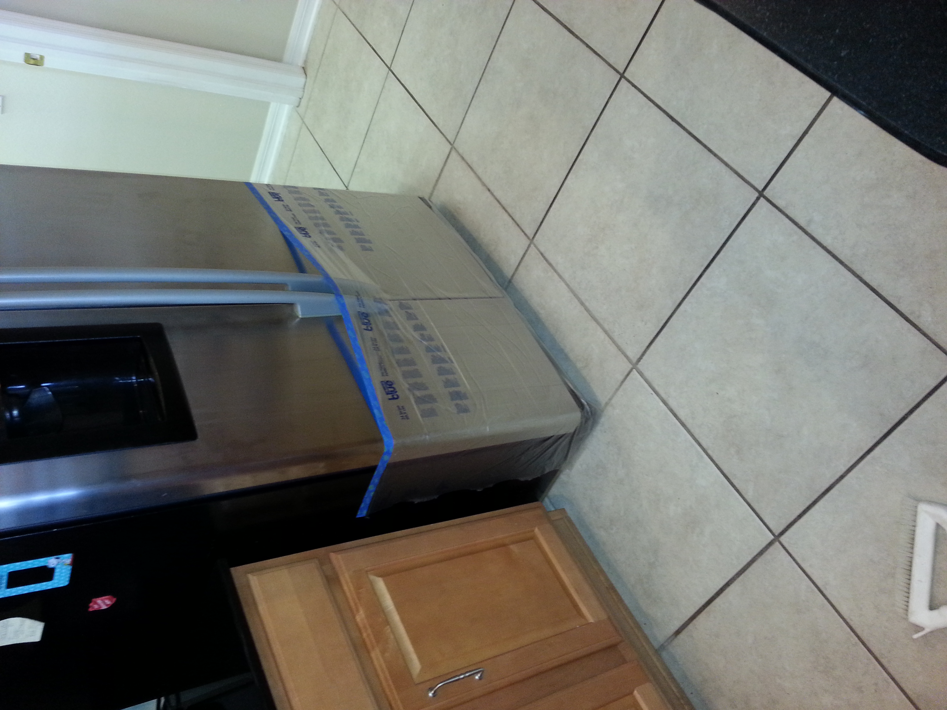

I use 3M blue tape then the Trimaco plastic/tape.... works great

I see you like living dangerously, putting tape across the stainless. It doesn't damage it, but it definitely brings out the crazy in the women when they see the mark.

Upside down...tape down pulling plastic up...nice to see you care and make the effort for your customers
