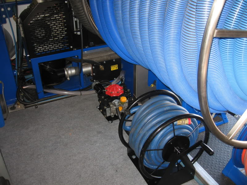

Hypro on my Thermalwave....good pump......
this one is hooked up to my 570......it came from Sapphire........
both are hooked up to a live reel.............

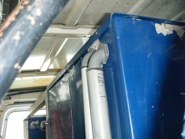

for $200 for pump and misc hardware I plumbed in a regular sump pump
water tight electrical conduit fittings thru the tank
1" conduit from pump out, and 1/2" conduit for cord
the beeoch is you need 110vt AC power..so that means running an extension cord
But not an issue for me cause my fuel burner requires 110 to operate and Powermatics have a 2200wt generator on them

Jim, Do you have any issues with the live reels? Where did you get your live reels from? Mine has a fairly restrictive swivel and occasionally gets plugged.
I don't have any problems...both pumps will clear out my waste tank as fast as I can fill it...
I have never had one get plugged....BUT...I filter everything that goes into that truck really good......
the reel in the 570 I got at Interlink..and built it to work for me...
the reel in the thermalwave....I had that thing laying around and just rebuilt it how I wanted it.....
