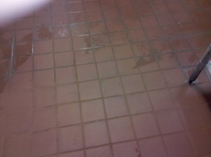

I have an SX-12 an have a chance to clean some quarry tile.
What is the better chemicals and how would you clean it?
It is in a large kitchen 32 x 38
What would be a good price? they may want be to do half one and and return the following to do other half, there is a lot of kitchen items.
Send response to my email if you would rather not reveal to the board.
Thanks
116,595
First figure out if any sort of coating in on the tile, usually there is.
If not just charge your regular ceramic rates and be prepared to explain why it does not look "Like New"...
If there is a coating take pics and get back to us.

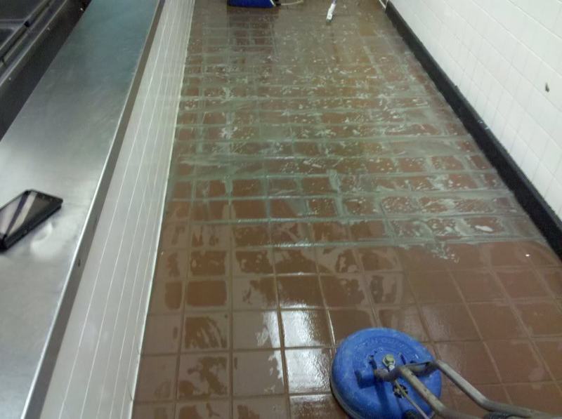

Be prepared to scrub grease.
That's one we did, there was an 1/8" of grease on all the lines. Add more cost to spend time scrubbing. And possibly having to go over it twice......

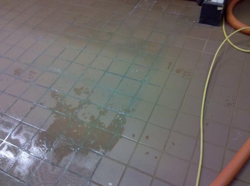

Have done quarry-tile kitchens. Used stripper, grout brush on Brute, and pole grout brushes. Rinsed with TH and Gecko. Color-sealed with Grout Perfect.
Quarry tile is semi-porus, so you need to keep the color seal off the tile as best you can and wipe any off asap.
fresh1
Nov 11, 2008
81
heavy on the alkaline then turbo at 2000 psi. Hit it with acid then turbo again.
