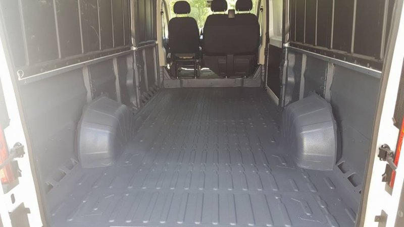

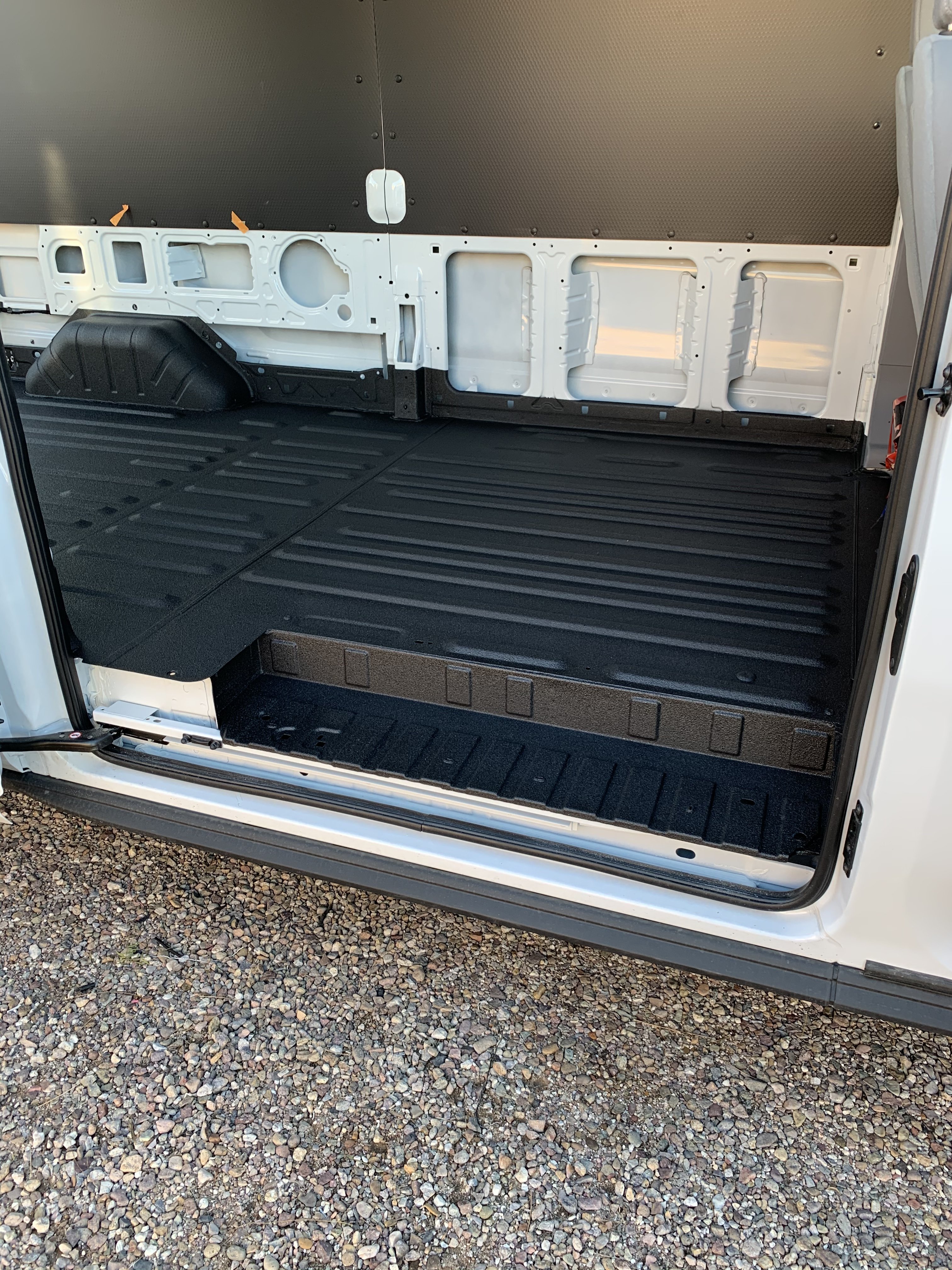

I sprayed in our van today I think it looks good, hopefully it will hold up.

Both our trucks have spray in bed liners. Big time savers!!

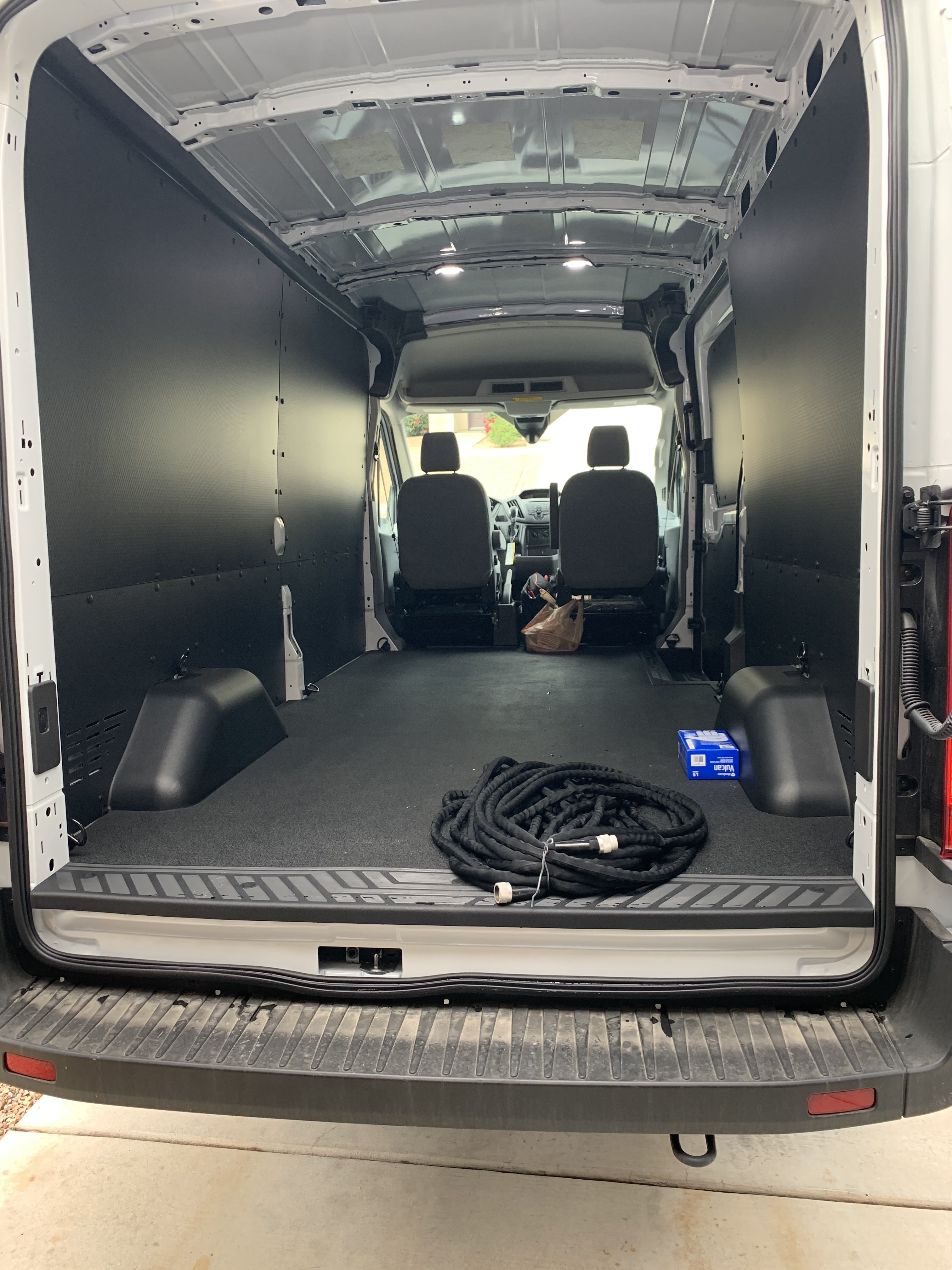

I was thinking about putting the factory liner back on the floor any reason I should not? The only thing that may be an issue is it has some kind of fabric glued to the bottom.

That’s why I was thinking about putting the mat back in, looks easier to keep clean.

I found out the hard way. I bought it twice for my Promaster. I bought the first batch from a local auto paint supply shop. It was white tintable. Turned out it wasn't enough to do my van so I bought another batch on Amazon for 1/3 the price of what the shop had charged me. But when I ordered off Amazon I accidently ordered black. so I mixed the black and the white together and it came out Grey. I like the grey so much i'll be doing it again in my truck.
