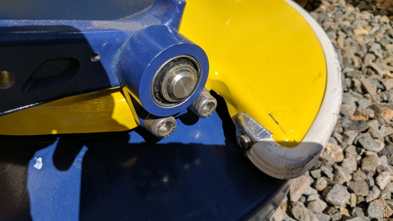

One of the swing are bearing sleeves keeps backing itself out...
That's after I tapped it back in. The rubber piece is coming out with it..
What's the fix?

Had a friend/jackass do the same thing to my Cimex going into the elevator and don't ask me how he did it... And when you think they can't mess up a task, leave it to my boy... Worse than Damon.. :stir: I took it off and pounded it back in between 2 small 2x4's.. Been fine ever since..
