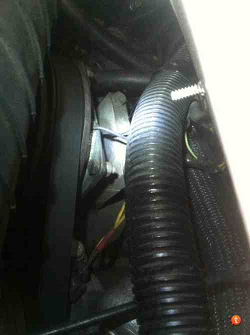

Mis alignment is a nightmare. check an make sure bolts are tight.
Thats belt shards built up

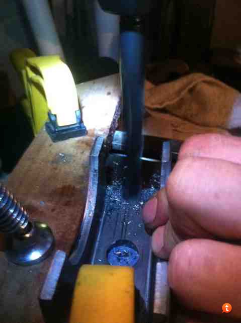

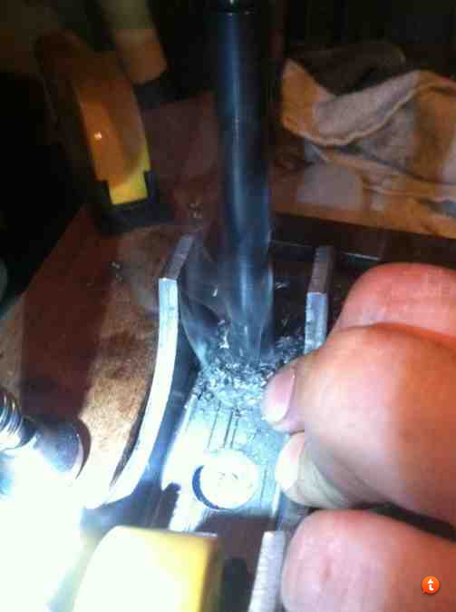

Building a better bracket than the factory muffler clamps, lol
Fab is fun : ) just not when ya least expect it
