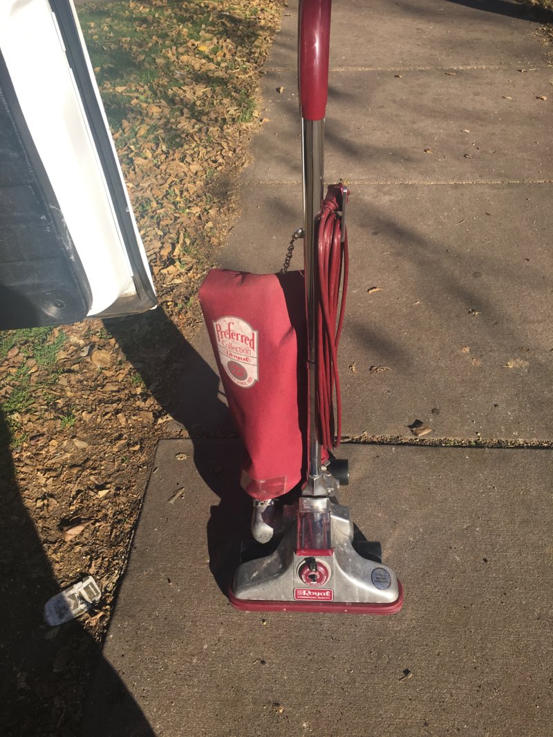

i am having a problem with the height adjustment on my royal vacuum. I will set the height with the screw knob on the back and by the time I am done vacuuming a room I have to readjust the head back down.
Is there a fix for this?

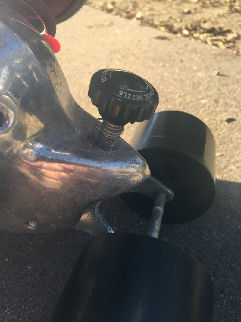

Is this the one you're having the problem with? That's the hot set-up. The threads would have to be stripped for that to slack off.
D
dgardner
Take off the spring and find a nut to fit the threads. Adjust the knob where you want it and gently snug the nut down against the vacuum housing. This is called a jam nut. The only downside is you need a wrench (small pocket crescent would do) to re-adjust.
Replacing the knob may help, but may not if the threads in the housing are worn too.
Usually real jam nuts are thin, but a regular nut will work fine unless it's height prevents you from screwing the handle down as far as you want.

Carefully unthread the spring and insert it into the body as far as it will go, then thread the adjuster in. I don't know ifthat would help, but on my old one, the spring is fully engaged.
117,248
It won't be easy finding a new adjuster, I believe Mikey has a Royal in need of that part also, if I remember correctly. I may have one kicking around my parts collection.
Right one of my 12" has a eyelet screw that I put in to eeplace the missung foot adjustee.
It doesn't vibrate loose.
Try another screw or wrap some teflon tape around the threads.
