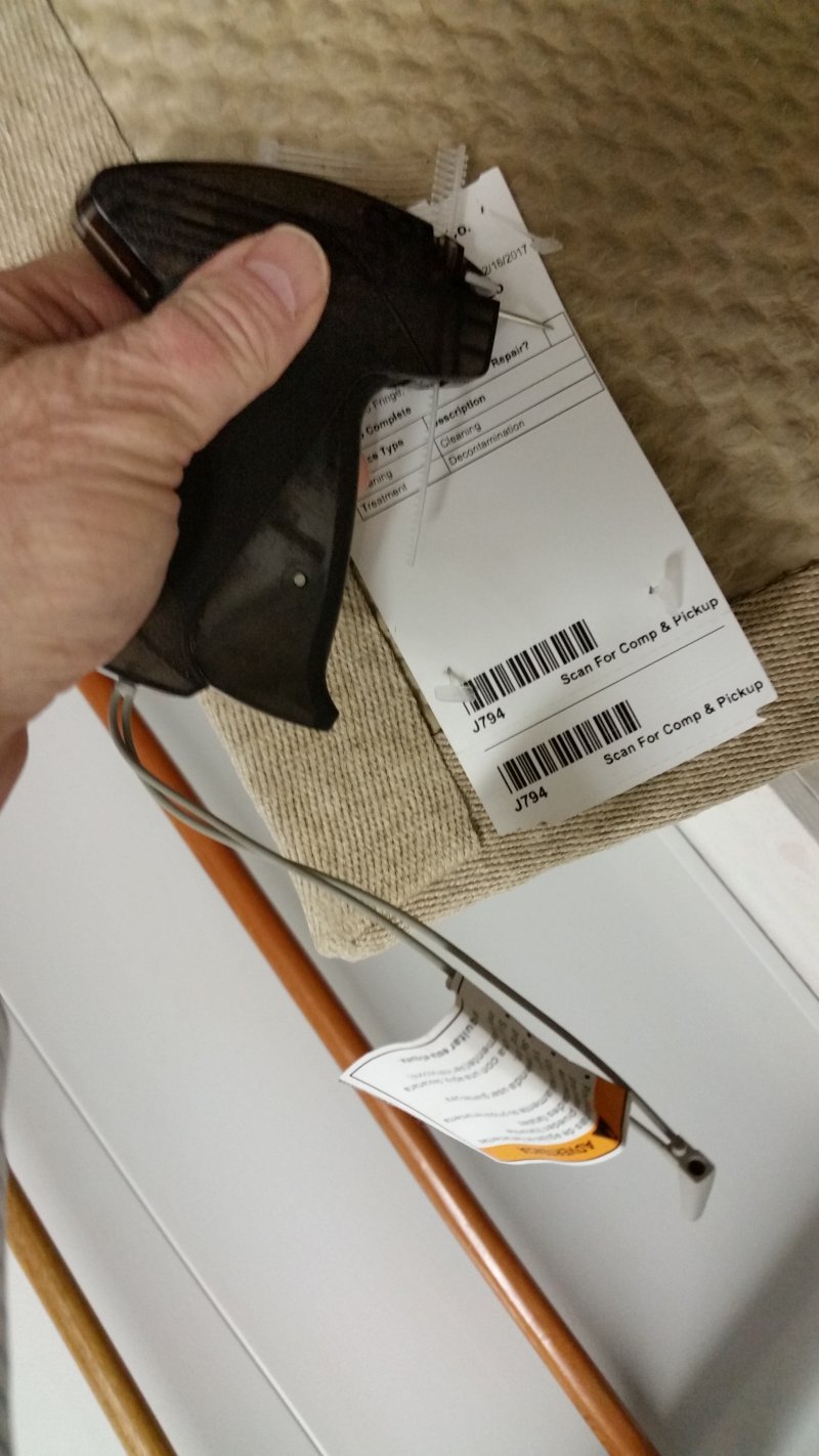

Some funny boys out there. Some rugs have pretty stiff backings. Just thinking these wires are too flexible to go through. I guess I will have to pick some up and try. I have been using a fabric tagging gun with the plastic wires but they can off during handling. Just wondering if there was a wire tagging gun of some sort.

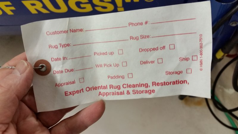

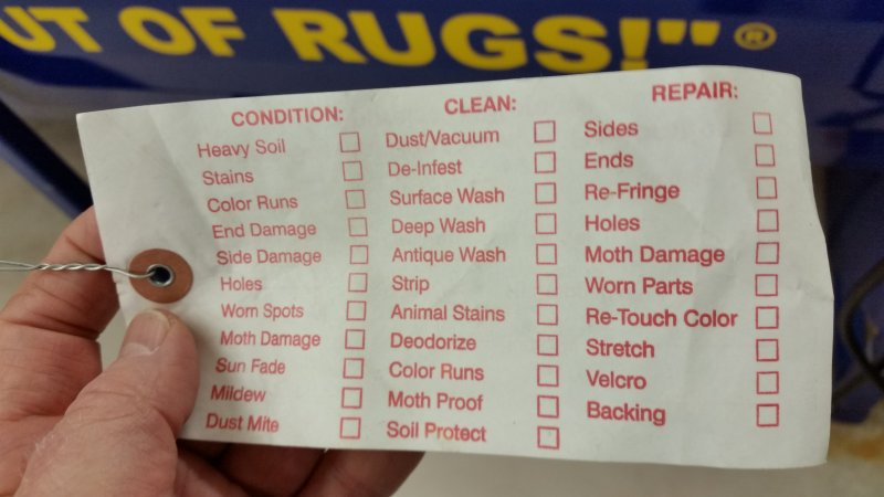

You can get blank tyvek tags from ULine, but a littel web searching will find better pricing. Most tag companies offer a choice of wire, so you can add 1/100 of a cent per tag and get a bigger wire. There's a bit of a technique to getting the tag through the rug: Bend the wire 3/4 of an inch from the end and wiggle it through in the space between the weave.
OR, poke a hole with an awl.

I'm still debating what type of Tyvek rug tags I want.. I want one to leave on the rug so the customer knows who to call again... Yes I know we need to market better to our existing clients, but it wouldn't hurt to have a tag with the rugs info on it... Faster processing next time in... Like Name, Size, Fiber type, and have our info on the backside... D.A. Burns has a very nice tag!

The tags we have are very small. I haven't found larger tags with the same hole size. Otherwise, my tagging gun works well. I think I would prefer the shipping style tags with the reinforced grommets. Very hard to pull off.

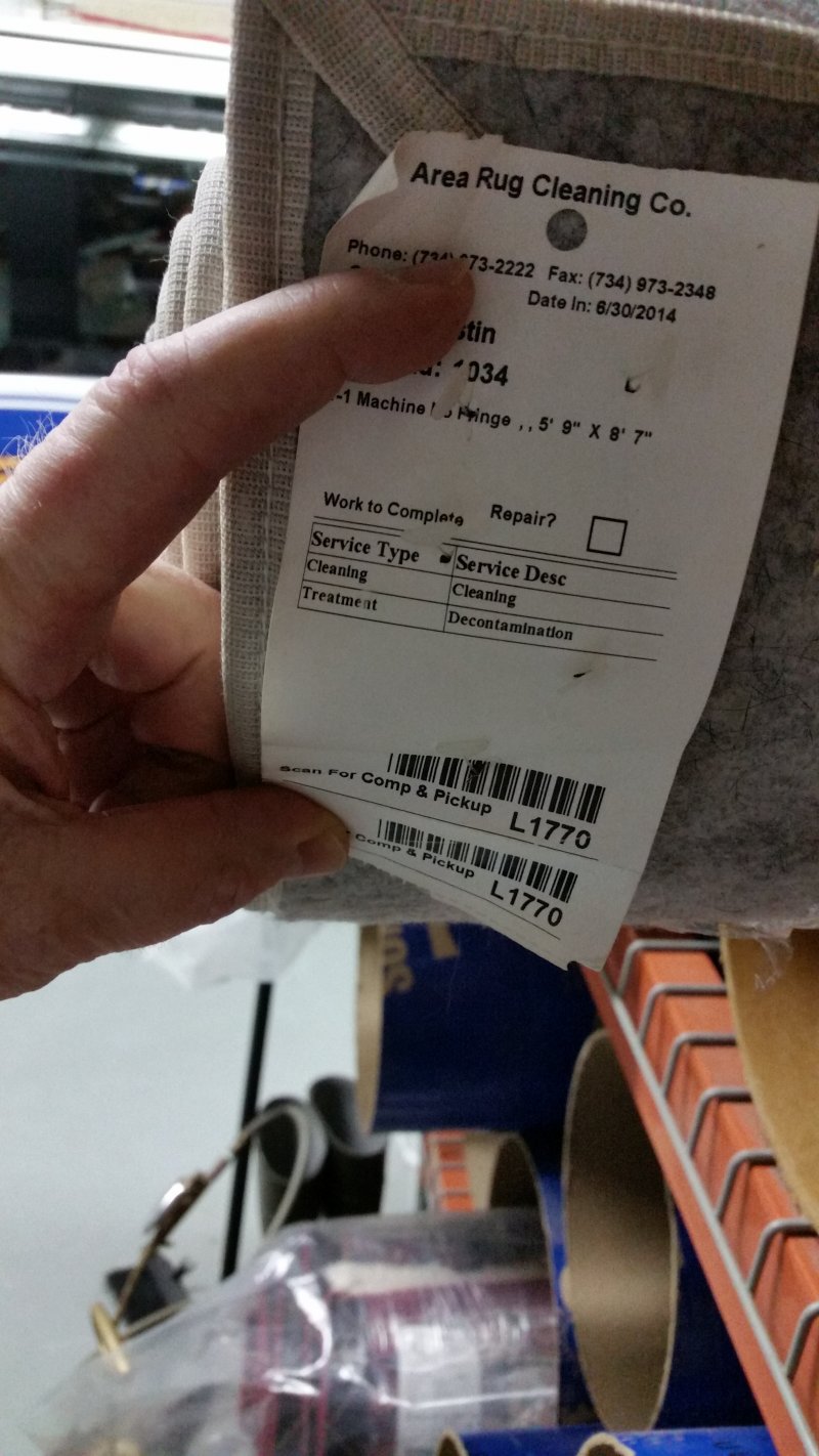

We print our own Tyvek tags. (But of course we have our own software and printer) We shoot at least 4 fabric tag fasteners in each one.

Try 800.352.7510 for information if you like this standard one.

I do like that standard one but it would be nice to have that reinforced grommet sized smaller so that it could be used with the fabric tagger. It would be nice to either have it in duplicate or just have a numbered tear off to leave with the customer. Using a couple of plastic tagging wires on each would probably suffice.

Please give an example on how or what you describe on the tag to be unique to each rug.
The tags are all numbered, so the number is entered on our worksheet which details each step of our process from receipt through to delivery, and is dated and signed off by tech. Simple system but we are not a volume processor.

Yeah those thin wire tags work great just thread right through the back of the rugs in the right spot. We usually take the tags off at the truck before delivering them into the customers home. People can get weird about seeing that tag punched in their rug.

Use 3 nylon fasteners, don't use the poly ones they will snap very easily. The best tagging gun we have found is the Tach-It 2 Long Needle gun, available on amazon.

For both Oriental rugs & Leather clothing, I use tyvek labels & a tagging gun with plastic tags.
