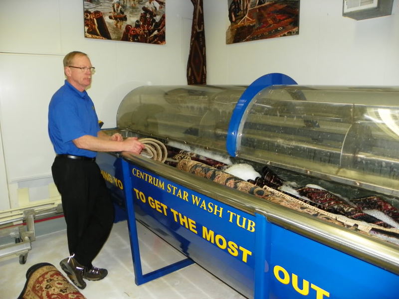

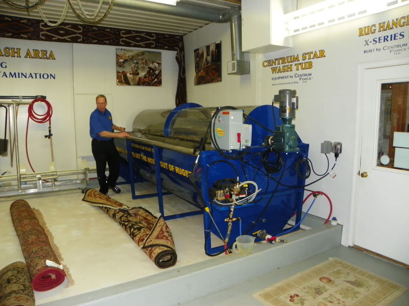

One concern I would furnish:
We give warnings about tufted rugs with glue backings. As a general policy for our cleaning operations, we do not wash tufted rugs that have latex glue and a scrim backing as part of their construction in our Centrum Force wash tub. Having said that, we may on occasion specifically select or ‘cherry pick’ a well manufactured tufted rug and wash it that way. (Albeit, not for a prolonged length of time) Problematic is the glue in many of these rugs. The adhesive in most of these rugs sold in our marketplace will release into the water. Hence, damage can occur to the rug with such thorough washing that is done in the wash tub. The operator must use critical discernment concerning which rugs can be submitted to this treatment. Therefore, we personally, in our rug wash operations, choose to tediously floor wash most of these rugs as our general policy.
Urine contamination makes this type of rug especially problematic to eradicate completely. In severe urine contamination, we address the glue and wash it away as part of the protocol that involves U-Turn treatment to the rug as well. New adhesive and a new scrim backing are applied if this procedure is accepted by the client. Generally, it is a better value for the client to replace the rug than go through all that is involved.
The following are pictures of wash tubs. The Big One is at Rug Renovators in NYC. One of the pictures shows 3 wash tubs of our style in one plant. (I don't recommend how the one operator was loading the rug in from behind the paddle wheel)
View attachment 531View attachment 532View attachment 533
I will post up more pictures and videos if desire Mikey. (I have to change some of the file sizes and formats) I have some from Woven Legends in Turkey and some 40-50 plants in North America that use the Centrum Force system too.
Note: I have made videos showing that we have washed tufted rugs in a wash tub. However, extreme caution should be exercised if you try it yourself. The inherit problem of glue washing away creates more work and cost to repair than the rug may be worth.

These pictures I took when visiting Turkey. These big wash tubs are located in the Woven Legends facility. They wash multiple rugs at a time.
Wash Tubs have been in use for many years in many places. Centrum Force produces their version in the USA for rug washers as another tool to get the best job done. The previous picture posted that I made showed 3 of our version in one plant. That specific in-plant operation has two Moore machines staged in sequence to provide the rinsing for every rug that comes out of their 3 wash tubs. They do on an average of 28K rugs a year this way.
