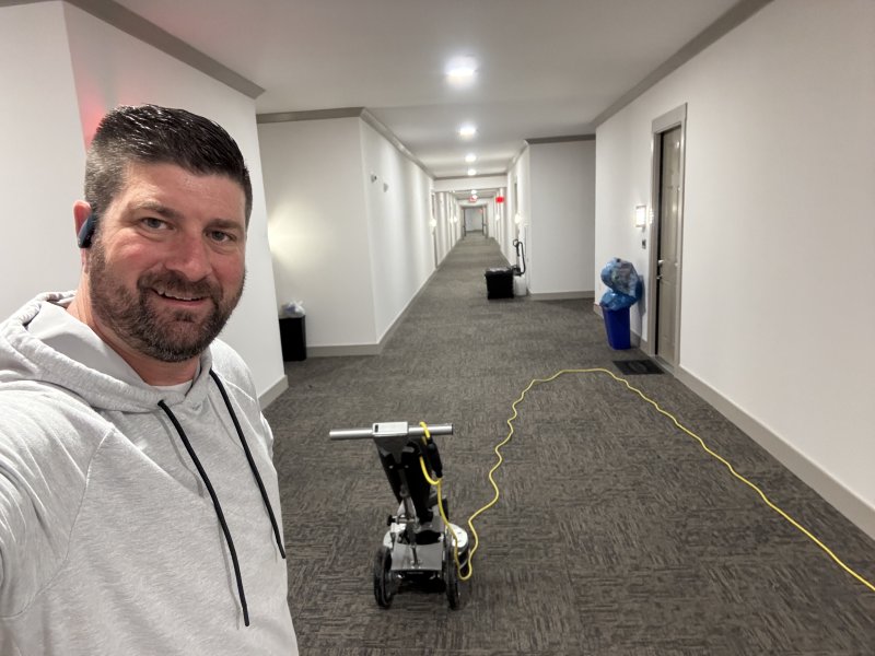

104,000 sq ft that included 15 four story stairs. 8 total days but had 1.5 days off to fit in a few other customers. (6.5 days on the job) My first VLM job. Mark never did show up but his 2x Oxy encap sure did. Stuff worked great. Went thru probably 9 gallons. It was my oldest son an I for 90% of the job. That’s a lot of work. But I’m now ready to VLM full time. Way more profitable. They are pleased with the results and booked 3 more units all almost the exact same size. Only 320,000 sq ft to go. Thanks for the info in my prior post to get me going. I did watch a lot of Mark’s videos before I started.

VLM allows a guy to reach any job. The sky is the limit when someone understands the process and concept.
We did 2 jobs over the last weekend. Both commercial, both VLM. Neither one was accessible by TM. I sure as heck didn’t want to porty them, as the soil load didn’t warrant it.
Used properly, it’s a viable way to maintain commercial carpeting…
Just remember, vacuuming is an essential part of the process.

I underestimated the amount of time vacuuming would take. Fortunately they had a ride on vacuum and a large area vacuum. Each of the facilities I’m cleaning do. I will need to buy myself a large area vacuum vacuum soon if I’m going to continue this.

Well I finished up all the buildings on Saturday. It was 2 more not 3. Total of 318,000 sq ft. The last 2 took 6 days each. 65-70 hours a week. Ain’t gonna lie, the hours were tough. They were very happy with the results. The last one I did was cleaned by a large company with lots of portys 4 months prior. The head janitor was telling me how impressed they were with the other company when they showed up. Lots of people, equipment, etc. They soaked the carpet and left. As it dried many of the spots were returning. They couldn’t believe how my little machine and all those pads could do such a good job. I bought a Ridgid 6” orbital sander to use with 8” microfiber pads on the 93 flights of stairs I had to clean. Worked very well. I learned a lot and should be able to streamline things a little on the next big job. I do enjoy the big jobs and will now be doing my best to land large jobs that I thought were out of my league. I think these 3 jobs may have single handedly turned my 18 y/o son into a man. He ran himself into the ground trying to keep up with his 47 y/o dad. Let’s say he won’t be talking trash about my age for a while. 😂

I would definitely do it again. The one thing I (think) did right that made the entire job possible was the price. I was over 20 cents a sq ft. Had I priced this cheaper and didn’t feel it was worth it for our company I would have been in big trouble. It was tough but we always went back to payday will make it worth it. Things I learned and would tell anyone wanting to take on large jobs that is residential guy like me. First is vacuuming is a huge part of the job and overlooking the time required is a major mistake. If you don’t have access to a facility vacuum that works you had better bring one. Other things to consider. Bring extra extension cords, lots of water jugs and a way to move them efficiently, scrubbers, wire repair tools to repair cord connections when they get ripped out of the machine it’s attached to, 😁 I did think of those things. I didn’t have extra hook pads for the Ridgid orbital sander , (they get full of crap and don’t work after a bit) heavy duty velcro strips to fix Vibe base when (if) they start peeling, Red Bull and possibly some more aggressive pads / bonnets for the worst areas. I am looking at a water tank with wheels and pump made by Vevor. Sure it’s cheap but it’s a 15-20 gal tank on wheels with a battery powered pump. This could save so much time if it actually works. That’s all I can think of at the moment.
