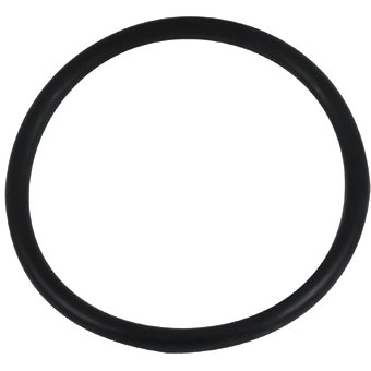

Both my local rug care studio's use Sanitaire type vacuums to do their dusting
Neither like the aggressiveness of the Badger type dusters.
Both shop go through those crappy belts at an alarming rate.
I wonder if the Kirby with it's flat and much more durable belt belt wouldn't be a better option.

We go through 3 belts a week at most ..maybe?
The real issue is the drive nut drive pulley , it wears down and the belt stretches and there's not enough contact/pressure between the belt and the drive nut
resulting in slippage, friction and reduced belt life we replace the drive pulley nut as needed 4-6 months.

Seems to me that if the roller isn't spinning the belt would burn and disintegrate very quickly with an obvious rubber smell.
Proper roll spinning requires that the height be adjusted properly for the carpet/rug you are vacuuming. The brush should just barely touch the fibers to allow the roll to spin--adjusted too low and the brushes will bog the thing down and burn out your belt in a heartbeat.
BTW Kirby and Sanitaire belts are not interchangeable.

If you are talking about these things, they suck. The belt and where you put it is round/smooth.
So when it stretches a little bit it has nothing to grab onto and slips.
