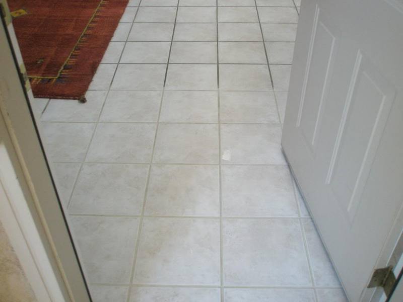

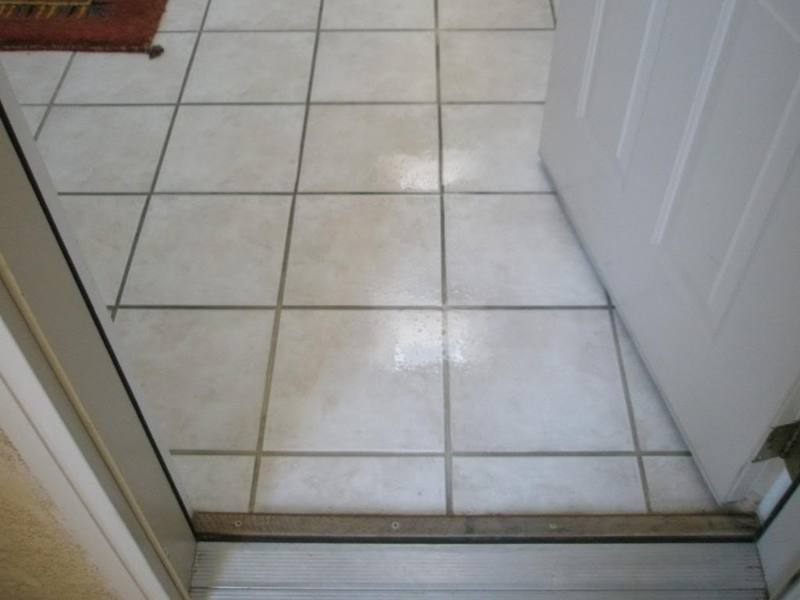

this is with judson mixed at 2 oz per gallon with no scrubbing and 15 min dwell. And remenber when doing a demo always do it where they have o look at it everyday.
after
