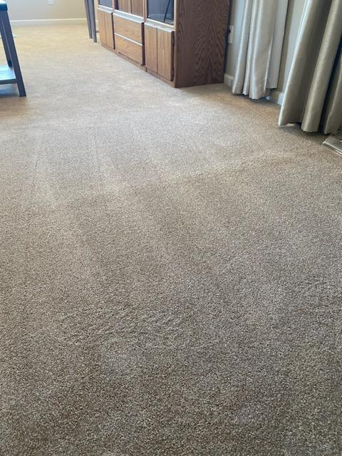

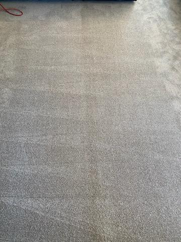

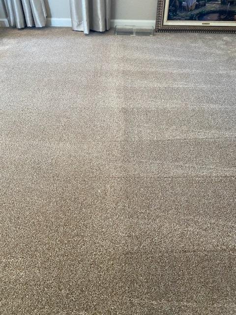

seams kinda hokey..
116,053
Installed yesterday at a good cleint of mine
70 ounce Tuftex nylon
Customer says they didnt see a power stretcher but installs says yes, he did.
Counter girls says seam peaking like this is normal and may settle down.
The pad is (taped here and there) seamed directy underneath the carpet seam...
clost to 1.5 " of up and down travel when you step on the seam...
Thoughts?
