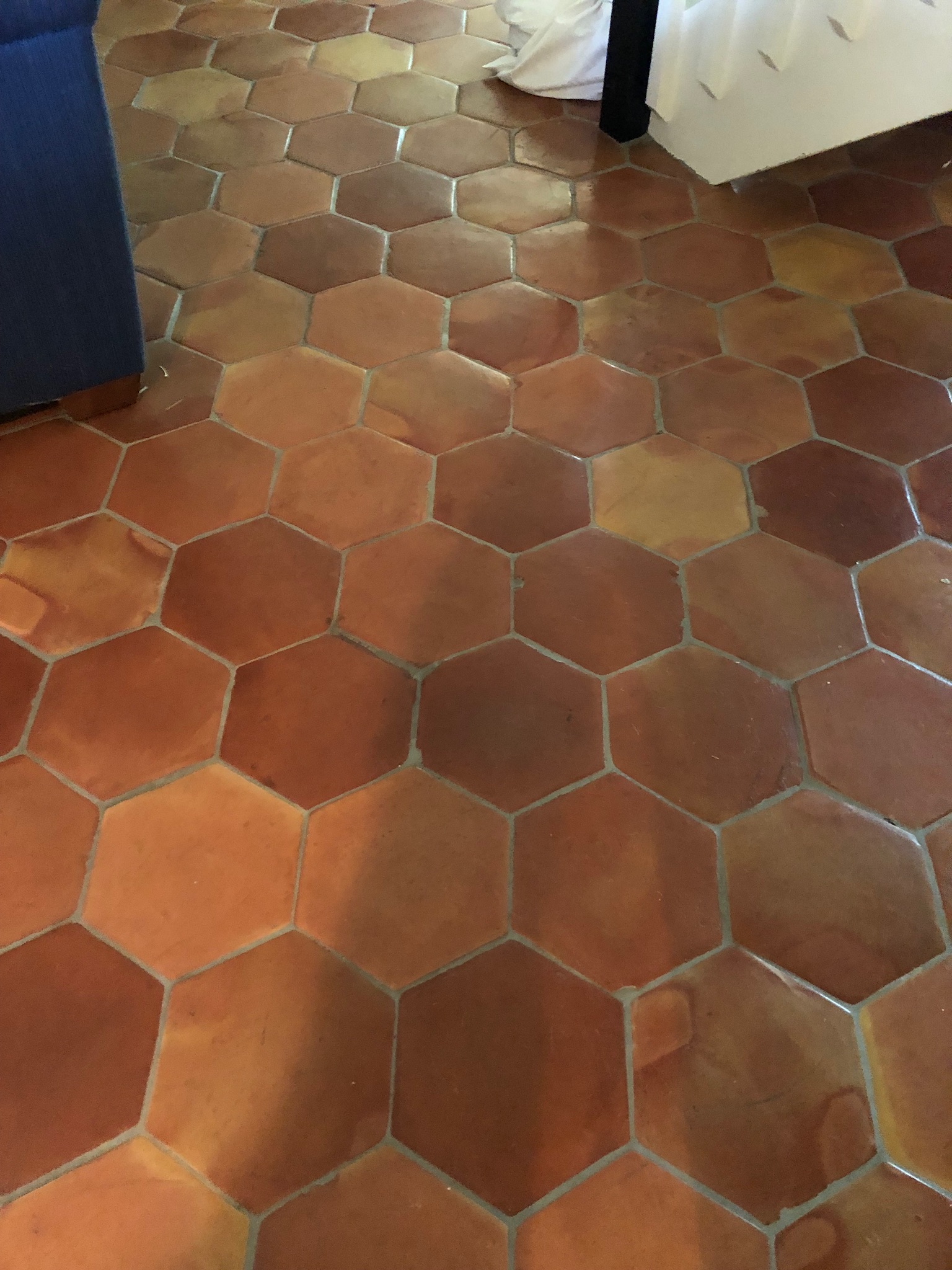

Clean with a nuetral, crb, 500 psi, warm fresh rinse.
Re coat if needed.
Do not attempt to strip
White brushes or the brown, stiffer brushes?
Re coat with what? Regular floor finish that I would use on Vct or different product?
116,693
Medium brushes, yes and any self leveling vct finish is fine
Let dry over night before "waxing"
Wipe up puddles of sealer in the grout as you go

Oh I never had any intention of trying to strip this. I plan on telling the customer I can clean and coat with some Betco hard as nails and that's it. If they insist on it being stripped, I'll walk and let someone else deal with that nightmare.

do you pre-qualify the custy that any dinge/crud in/on the grout UNDER the old finish(that stuff happens) will still look like rotting worm guts..only a little shinier?
Yes. I explained to the customer that I would only be able to clean the dirt off of the surface, that anything under previous coatings would still be there. He just wants the floor shiny? Said he had someone look at it before he was referred to me and they told him that they could clean it but that you couldn't put any kind of sealer on that tile.

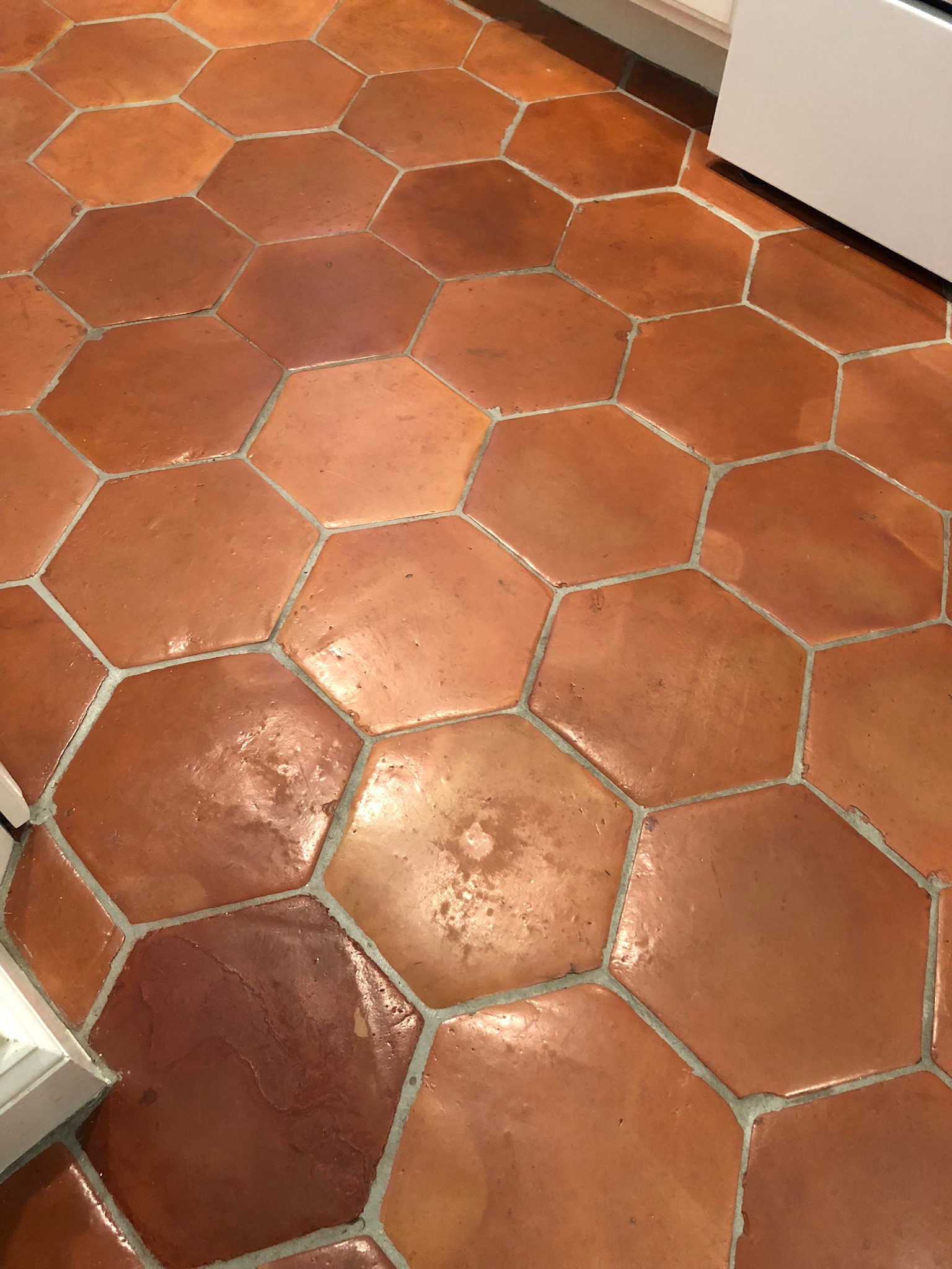

The floor in these pics doesn’t look bad at all.
As I don’t see any buildup, cracking or staffing of the existing finish or too much discoloration overall.
