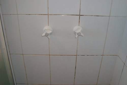

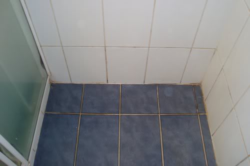

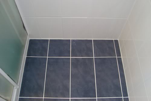

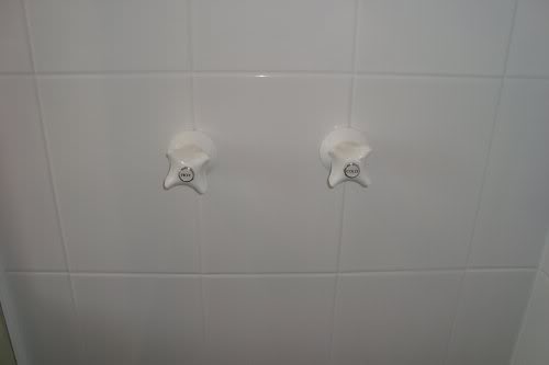

These are great money makers when you are a bit slow.
Before
After
Before

Good job Craig. What do you use for grout removal?.
Albert
safeclean
Apr 9, 2007
159
Hi Albert
I use the fein multimaster with a circular diamond blade and a pocket knife for the skinny grout joints and a dry vac for the dust.

Did you color seal the floor?
If so have you done much of that?
safeclean
Apr 9, 2007
159
Yes I color sealed the floor too not re grouted though I have done over 40 showers so far re grouted than color sealed walls and floors with no call backs but I do not give a warranty in wet areas like I would on a kitchen floor. We also offer shower cleaning and color sealing only if the grout is in good shape.
