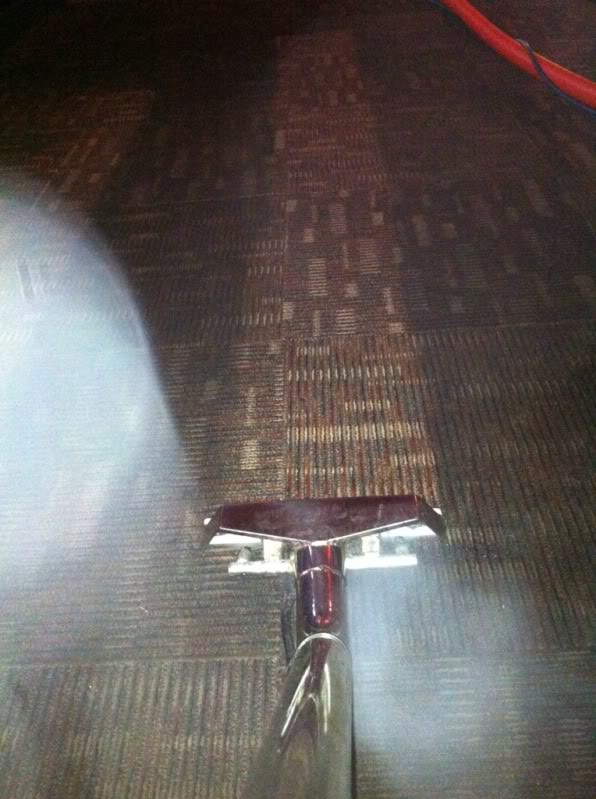

side by side Powermax to S&G..not much to show
North East Ohio
I though sure we'd hit pay dirt today with one res and three sec 8's
I knew the res wouldn't be dirty, but thought sure at least one of the sec 8's would be..but not so.
this is dirtiest carpet we saw all day
Typical builder grade Nylon
quick vac and split the dirtiest part down the middle
Mixed one scoop of S&G
2.6 scoops Powermax .
Scoop used was the typical scoop in most jugs of powder (2oz I think)
Mixed in separate, clean jugs using hot tap water from the kitchen faucet .
I'd estimate 100-110 degrees
Application RTU @ 250 sf pr gal
I'll let ya'll judge the results
BTW, i have no idea why the red areas ..there was no visible red to the eye
If you look at in the right corner above the register, there's red on the wall too....
Unless it's one Duane's ghost oRbs :shock: I haven't a clue where or how it showed up
We're working on a rehab right now,
Should be finished next week .
We're going to attempt to salvage the bed rooms .
Trashed oly loop pile ..it will make for a much better proving ground
stay tOOned
pee ess..Sunday's trashed rag didn't prove much and was inconclusive..it was so trashed/stained up, nothing made it look good .
if someone can tell me how to download pics from my Android , I'll post 'em on this thread
FB7777

You don't need some passed his prime section 8 cleaner to do the test. I can tell you because I use both products regularly. Slop and gobble mixes better cleans awesome. Powermax mixes shitty and cleans awesome. you have 2 high Ph cleaners that clean. Besides that Larry that carpet isn't clean because you glided it, if you want it truly clean you have to wand it again with the face open/////HACK
If you want to pimp a nasty section 8 get slop and gobble or powermax(you are going to need hotter water to mix powermax) boost with some magic wand oxyblaster and cruise. Make sure you prespray, prescrub, glided wand then open faced wand. That is what we do everyday

I can't pick a "clear" a winner guys
we haven't seen any seriously trashed carpets
S&G mixes better (cause you don't have to mix so much)
PM smells great
the thimble full pr gal RTU of S&G in unrealistic imHo
The mega dose larry suggests is more than is needed
so I've been mixing S&G at 2oz pr gal and Cobby's at 4.5 oz pr gal
that makes them "dollar for dollar" RTU mix
it's a draw .
neither out preformed the other at those rates on moderate soil conditions .
They were both very good
