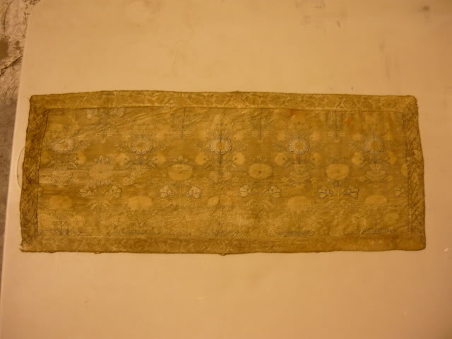

OK, I got one for you early 17th century silk brocade
You can use an upholstery tool on it but you'll own it if you do!
Nice! Thanks for sharing that...it's interesting that though silk and wool are both protein fibers, you can still walk on a 300 year old rug, but silk tends to disintegrate with age, even though it's quite strong.
Thanks again Randy. Was that piece in your shop?
Lisa

rhyde said:
it's in my shop right now for cleaning
What will be your procedure? I guess I could've just said- howya gon' clean it?

rhyde
Front loader less water ..
I'm still working on a solution it's very fragile and there's tarnished metal threads not to mention a poor consolidation adhesive on the back
I've cleaned coptic and pre-columbian textiles that where much older

If I HAD to touch that.. it would be getting the screen treatment or the Mann treatment.
When we handle the museum's pieces, that what we do, sandwich them between screens to hold the together as we soak and air dry them. Actually, you could also run an upholstery tool along them if you wanted - we are typically not dealing with any heavy soil so a simple wash seems fine for the antique silks, quilts, or weird stuff we get now and then like kimonos.
But again with wool rugs - wool seems to hold up really well. I'm just curious why the silk eventually splits and breaks with age. It's just interesting.
