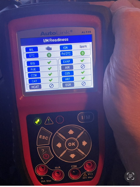

has it had the codes reset/dead battery
if so yes....it has to run all required test
Yea Fred- the battery was dead a few times in the 20 months it sat. I've had to charge the battery a few times.
asking about the battery was the tech's first question he asked me.
I have a code reader and will try that too.
Then you'll need to drive it. The 300 miles or so he suggested should do it but you can also look online for the driving pattern used to reset them all. Not sure how easy the drive pattern would be to complete in your area. What year/model?
The tool will allow you to see when the monitors are ready so you don't waste time at the emissions place....but won't help you other than that unless there is an issue/code
