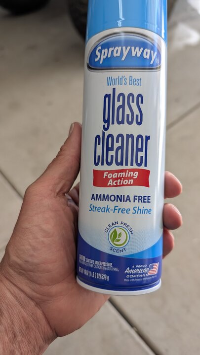

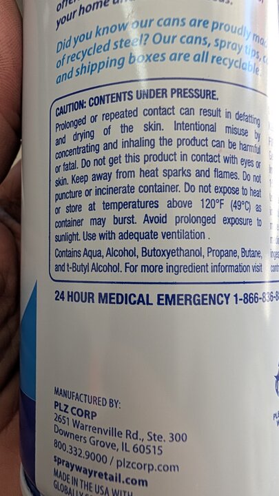

I was cleaning the dash in my pickup truck today and use the same product to get some dog slobber off the synthetic upholstery.. The somewhat alarming but effective foaming action on the stains caused me to make this inquiry
My question to Gemini.
Can you search the manufacturer's website as well as any discussion forums or mention of this product and come up with a reason that it couldn't be used on natural fabrics and calcium-based stone or synthetic fabrics in any wall-to-wall carpet type. Considering it's ammonia-free I'm wondering what the pH is but since it leaves no residue what harm could it cause to the above mentioned surfaces
That's an excellent question, and your reasoning is sound, but you've correctly identified that there must be a catch. You're right that the harm isn't from ammonia, but it comes from two other key factors: the solvent ingredients and the product's pH level.
Based on my research into the product's ingredients (from your photo), its Safety Data Sheet (SDS), and forum discussions, here is why it should not be used on those surfaces.
1. The pH Level (The Problem for Stone)
You are wondering about the pH, and that is the exact problem for calcium-based stone.
* The pH: The Safety Data Sheet (SDS) for Sprayway Glass Cleaner lists its pH in the 9.5 - 10.5 range. This is moderately to highly alkaline (basic).
* The Harm: Calcium-based stones (like marble, limestone, and travertine) are chemically sensitive. They are famous for being damaged by acids (like vinegar), but they are also damaged by strong bases (alkalines). This high-alkaline cleaner will etch the stone. Etching is a chemical burn that dulls the surface, removes the polish, and leaves a permanent cloudy mark that looks like a "water spot" but cannot be wiped away.
* Manufacturer's "Proof": My search confirms that Sprayway manufactures and sells a completely separate product called "Sprayway Granite & Marble Cleaner." This product is specifically pH-balanced and formulated not to damage stone or its sealer, which strongly implies their standard glass cleaner is not safe for this purpose.
2. The Solvents (The Problem for Fabrics)
The ingredient list you photographed contains several potent solvents, primarily Butoxyethanol and t-Butyl Alcohol. These are fantastic for dissolving oil and grime on glass but are disastrous for fabrics and carpet.
* Dye Damage: These solvents are strong enough to dissolve the dyes in natural and synthetic fabrics. This can cause the color to bleed, fade, or create a permanent light spot. This is the biggest and most irreversible risk.
* Fiber Damage (Natural): For a natural fabric like wool, the high alkaline pH (10.5) is catastrophic. Wool is a protein fiber, and high alkalinity chemically damages it, causing it to become brittle and yellow.
* "No Residue" Claim is Misleading: The "streak-free" and "no residue" claim applies only to non-porous glass. On a porous surface like carpet or fabric, the foaming agents and surfactants (soaps) in the cleaner will get trapped deep in the fibers and will be impossible to fully remove. This sticky residue acts like a dirt magnet, causing the "clean" spot to become a dark, dirty patch over time.
* Stain-Guard Removal: On most wall-to-wall carpets, these powerful solvents will strip away any factory-applied stain guard (like Scotchgard), making that area more susceptible to future stains.
In summary: You are right to be wary. The "ammonia-free" label simply means one specific harsh chemical is absent. The product is still a powerful, high-pH, solvent-based cleaner formulated only for hard, non-porous surfaces. Using it on sensitive stone or fabric is highly likely to cause permanent chemical damage (etching or dye removal).

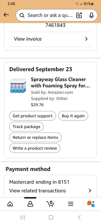

Ive used sprayaway glass cleaner for decades now. I love it the chemical composition of it is i believe deionized water and denatured alcohol. Yes i have also used it as a spotter but not on a regular basis. As a window cleaner it is the best. I can clean a very large pane of glass with my squeegee and go back and remove a bug spot /tape or just about anything from the middle of the pane with sprayaway and tou can not tell that i did it. They also make a great stainless cleaner/polish. Forgot to mention that it's very inexpensive when bought by the case 2.50 per can on Amazon

I find myself wondering about the source of AI's data.
Here are a few of the more obvious issues:
AI problematic answers in quotations:
(My replies in bold italics)
"The ingredient list you photographed contains several potent solvents, primarily Butoxyethanol and t-Butyl Alcohol. These are fantastic for dissolving oil and grime on glass but are disastrous for fabrics and carpet."
“Disastrous” Really? Those solvents are often used in carpet presprays and spotters. What is the source for this information?
"Dye Damage: These solvents are strong enough to dissolve the dyes in natural and synthetic fabrics. This can cause the color to bleed, fade, or create a permanent light spot. This is the biggest and most irreversible risk."
I have never seen color bleed from those two solvents. High pH yes, and way back in the day some chlorinated solvents, but while possible, I have never seen color damage caused by either of those solvents myself. If these products did cause those issues, we’d be seeing a great deal of color claims in the cleaning industry.
"Stripping the Stain-Resist Coating
This is the most significant problem. Nearly all modern residential nylon and polyester carpets are treated with a topical, factory-applied stain-resist coating (like Scotchgard or a similar acid-blocker)."
Scotchgard doesn’t contain an acid-blocker at all.
"Latex Breakdown: Those solvents can attack the latex used in the carpet's backing (which holds the primary and secondary backings together). This can cause the carpet to delaminate (separate) or become stiff and brittle over time."
As above. If butoxyethanol broke down latex, you’d have delamination in every carpet that has prespray applied to it.
Don’t get me wrong Mike, I’m no fan of using products that weren’t designed for textiles on textiles. I’m more concerned as to where AI is getting its “intelligence”.
Have AI search SDS for:
Prochem Ultrapac Trafficlean
Prochem Fine Fabric Prespray
Both of these contain butoxyethanol or one of its close cousins
There are several others of other brands, but I just picked those two because they are widely used.
