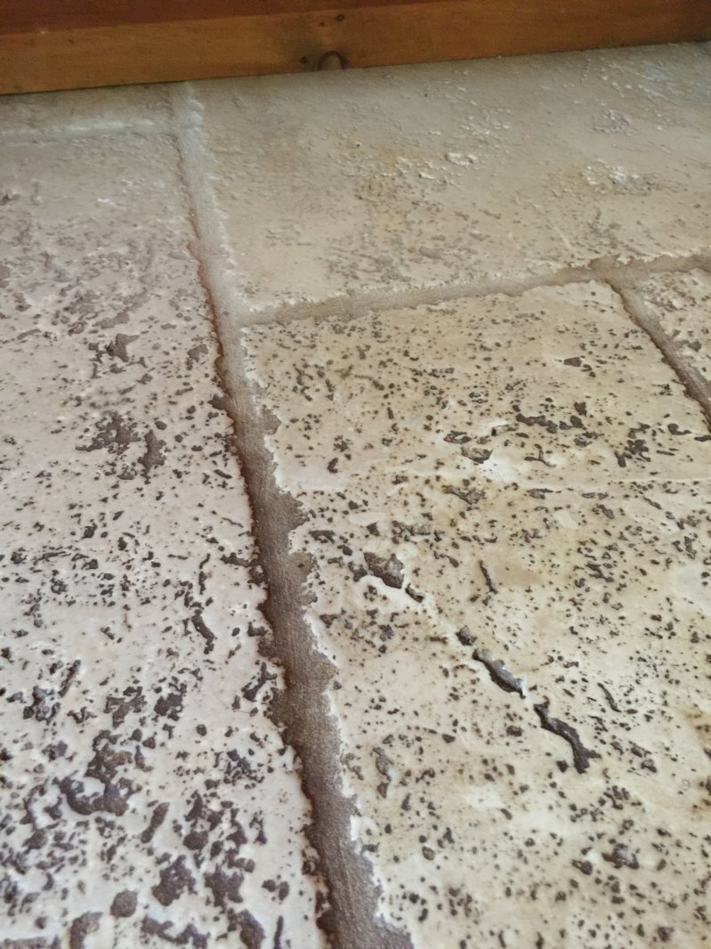

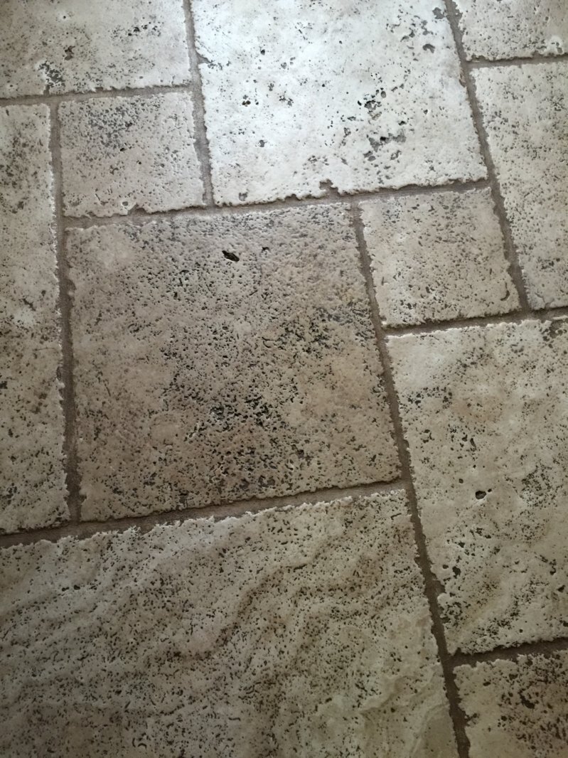

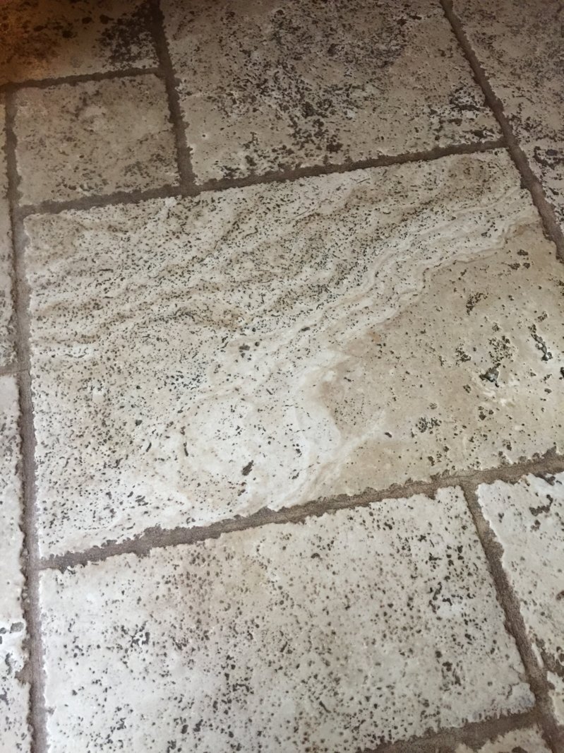

I did a quote today and came across this tile and grout. Looks like it's has been sealed with the soil in the grout. Maybe a colour seal attempt. Any thoughts

Did you test grout to see if it was sealed? May never have been cleaned.

looks like normal grout to me. The stroke marks you are seeing is typical of these floors, they wait longer to clean up and the sponges can leave those marks. I don't see anything that indicates otherwise. a good alkaline, brush and extraction with a truckmount should make a big difference. The brush will help with all the crevices and textures of the stone.
116,689
btw, that random soiling is the effect of using a string or sponge mop and dirty water on Travertine.
