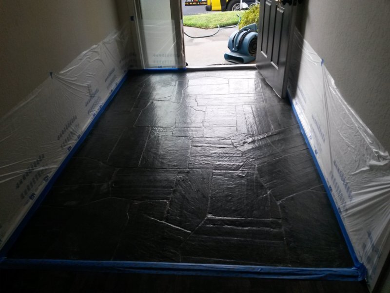

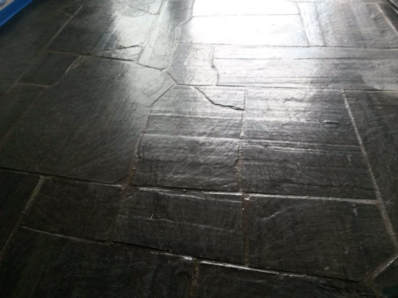

Not fun work but it has to be done at the right price...20 years of Mop N Glow on a slate...price it rght

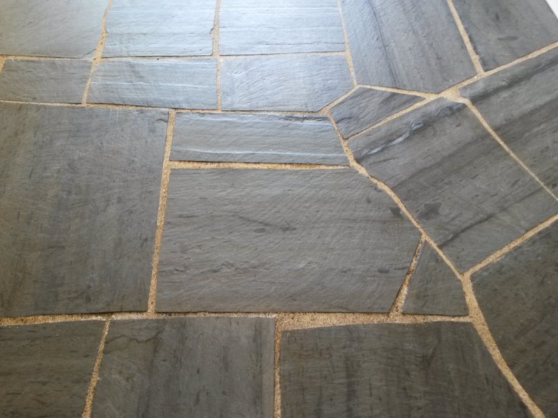

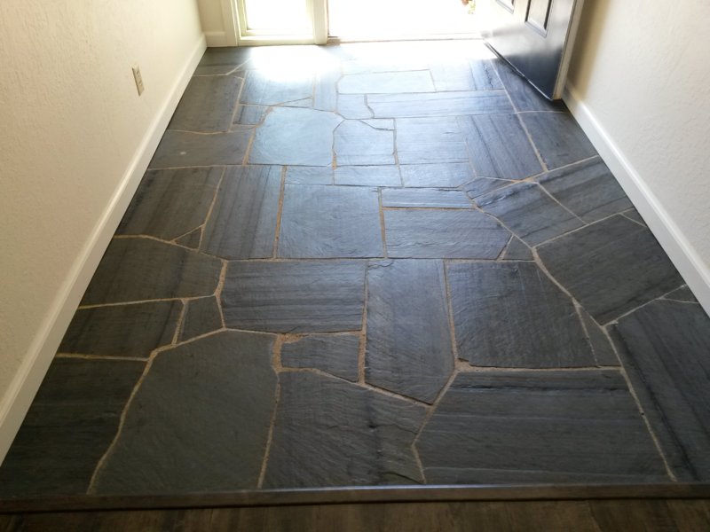

I priced it by time since it was an entry, under 3 hours of work for $500, as you can see on the after pic, those high ridges had to be touched up with paint stripper and acetone after I took the picture

Nice job, what stripper did you use, if you don't mind me asking.

I did 3 applications of general VCT floor stripper that I get from a local janitorial supply.

180 malish brush and a stiff deck brush for the edges, I used the truckmount.
