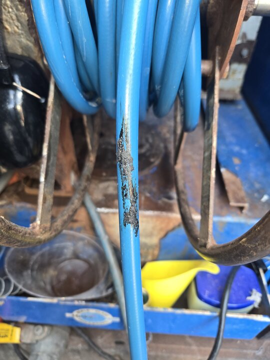

The parking lot splooged a bit of tar on my solution line. I'll watch out for the patched areas when I am laying out my lines from now on. Any solvents you guys have found work really well at getting this stuff off?

I use pog on a rag. If i need something a little stronger i use rubbing alcohol. But pog generally works well. Use a wet towel afterwards to remove the pog

Acetone from your paint store or Lowe’s or Home Depot.
No it won’t soften your hose like somebody’s going to say.

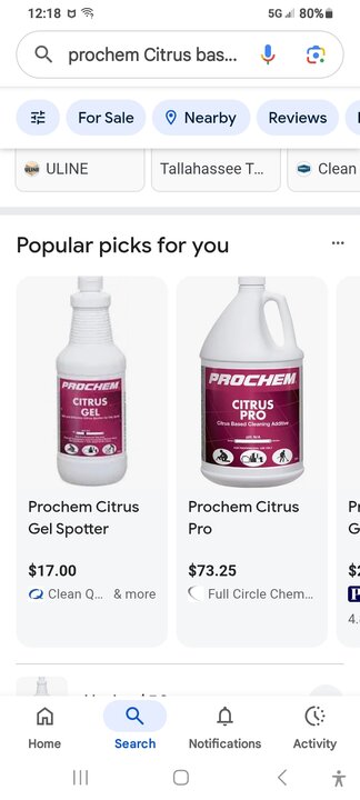

Forgot to mention (because i use it in place of pog) is citrus based spotter. I use pro chem citrus pro and citrus gel(gum remover) to remove tar stains on my hoses because it worksand is on my truck. But when i do it at my shop i use odorless mineral spirits. Only because it works and is handy i have a part's washer with 30 gallons of the stuff handy

just get some goo gone and a razor blade. spray, scrub, and shave it if it doesn't come off

Sorry Matt! I was listening, but also imagining stuff at the same time. I thought since I only have my Salsa/blower exhaust heat exchanger working right now my temps wouldn't be hot enough to worry about it yet. Not so!
Yep, 7 weeks since I ordered my dang heat exchanger. Dude said it was done almost 2 weeks ago... I want my new heat exchanger!
Thanks for the tips guys!
