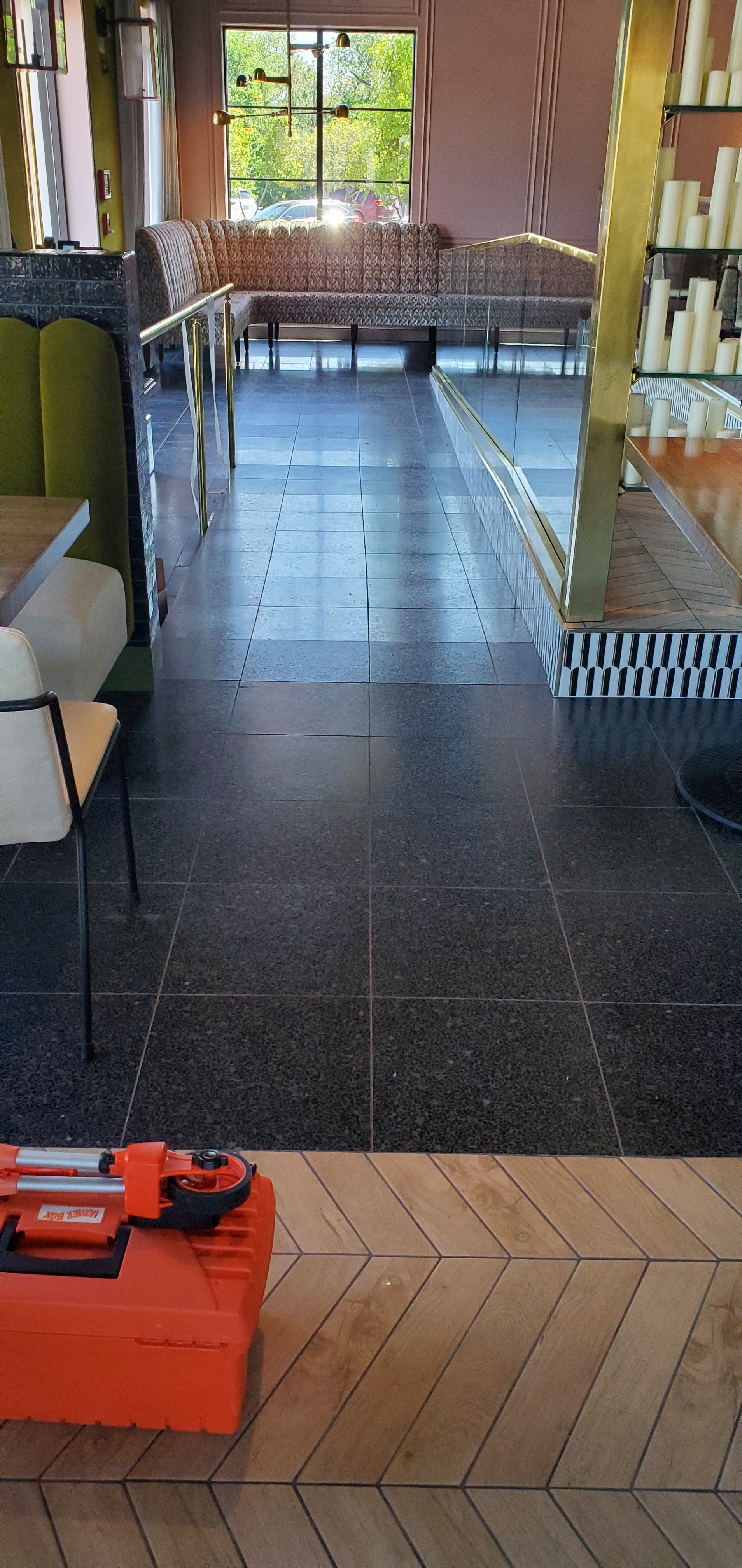

I snagged a decent job. It's terrazo flooring. I was going to clean and put a semi-gloss wax on it (they want a medium shine to contrast the high gloss ceiling) but am on the fence. It doesn't have wax on it at the moment (I razored a small inconspicuous area, no wax). So I am now trying to decide on if I should use my monkey pads. If I do, I need some help on deciding where to start and finish. I thought, maybe clean, 800 monkey, turbo hybrid, seal. Here is the floor. Not in bad shape at all. Just different spots that are semi-dull that stand out. Also, as you can see lots of furniture to move 😐. 1200 sq ft thats spread out. Wanting to have it done in 1 12-hr shift. Will have 3 more guys with me.

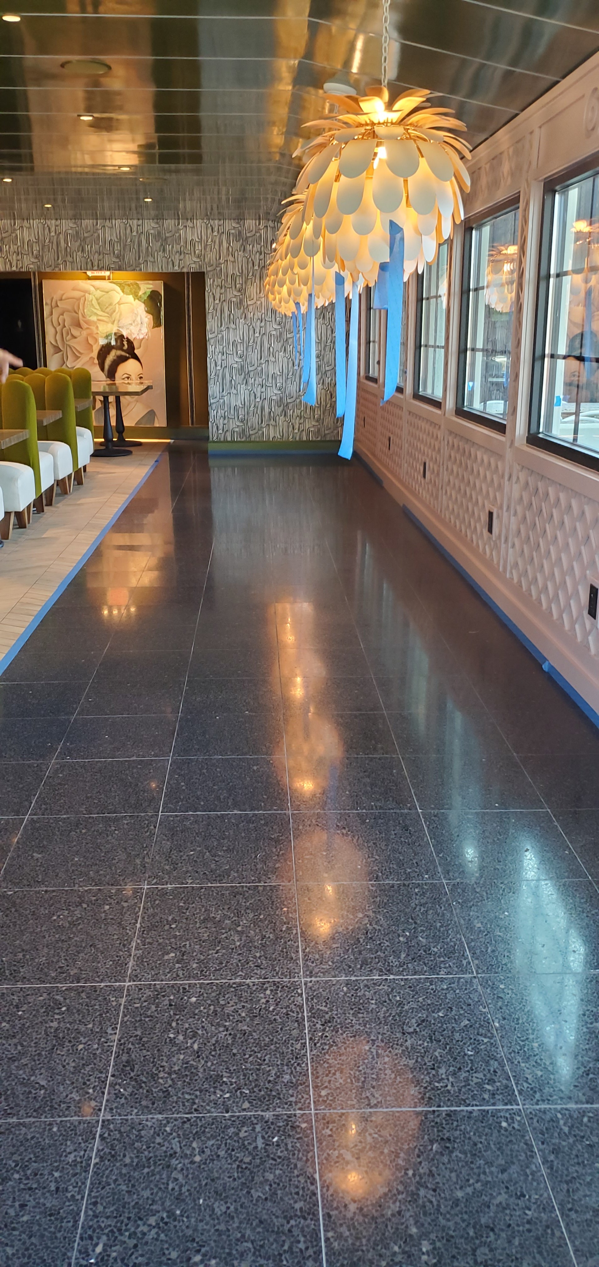

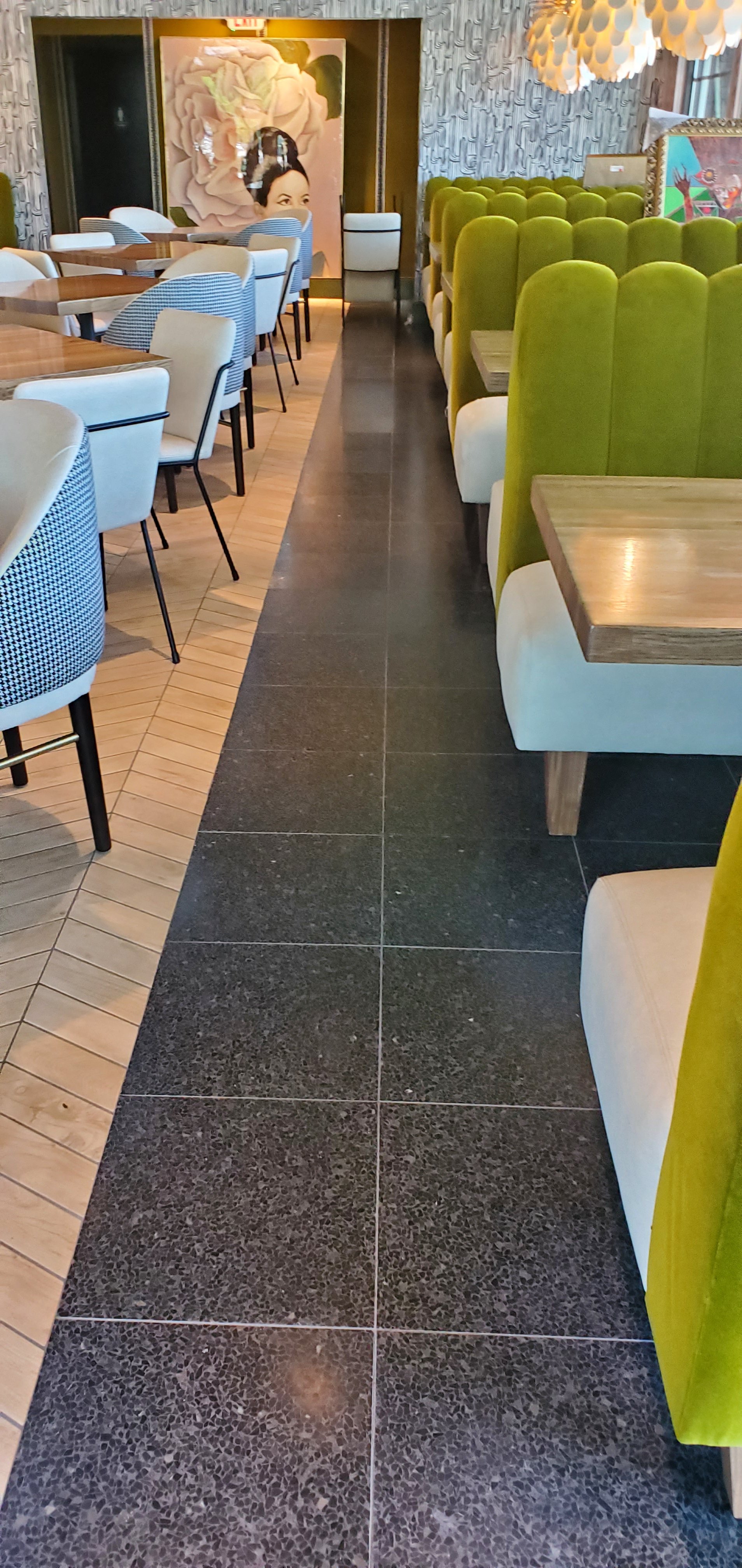

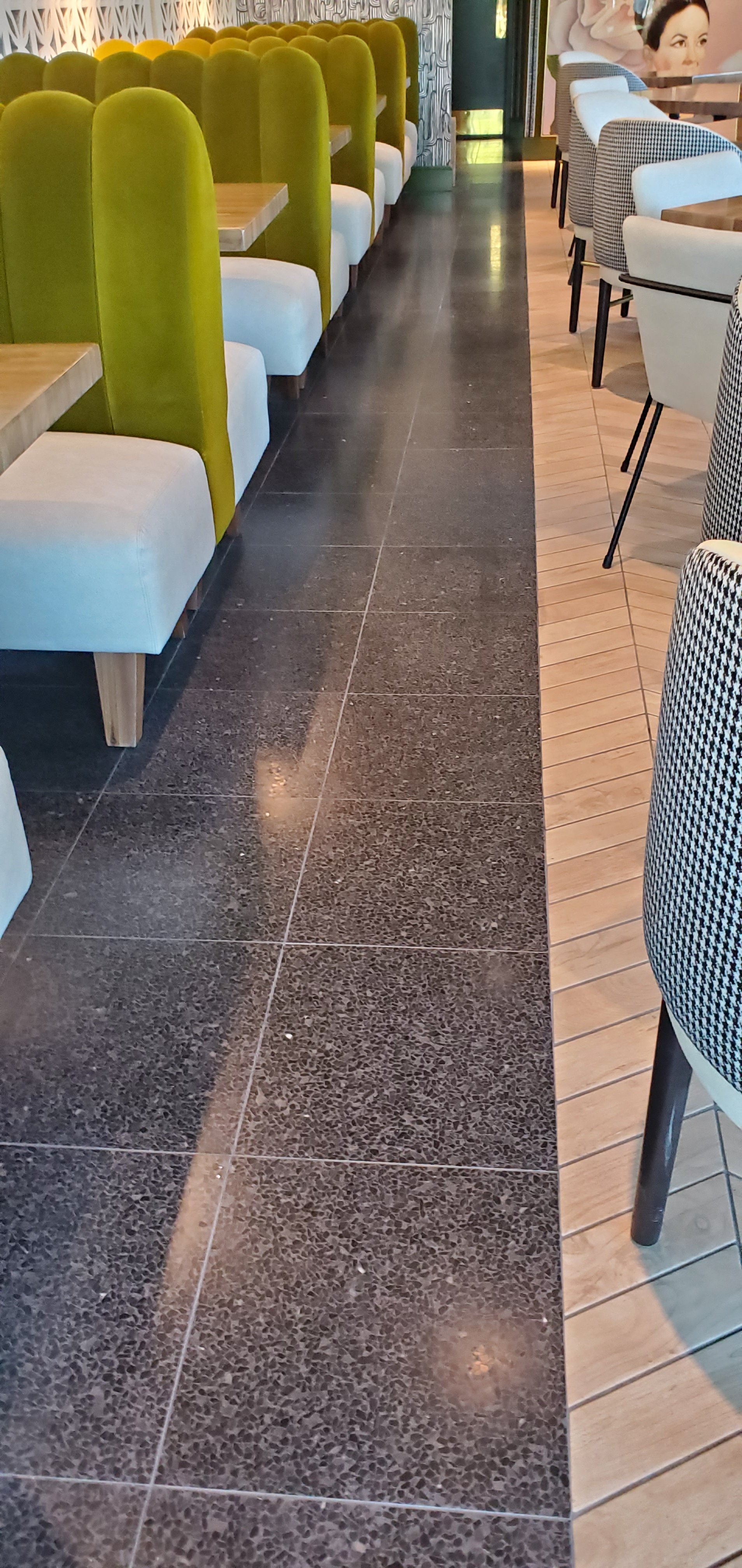

Hello friends! My apologies for being late on my update! The job went great and the customer was happy. They want me back every 6 months for maintenance. Score. Here are photos of after. I did a test with 1500 grit monkey pad unweighted drive plate with water using 175. Too dull. I bumped it to 3000. Was right where the sheen needed to be to contrast the high gloss ceiling. I did a final mop with neutral cleaner, fans applied and used Dupont inpregnating sealer applied with microfiber pad on pole. Thanks for the shove guys, and for being here. Means alot...

It's hard to tell from the before photos much difference. But in person there were cloudy patches throughout. No more.
