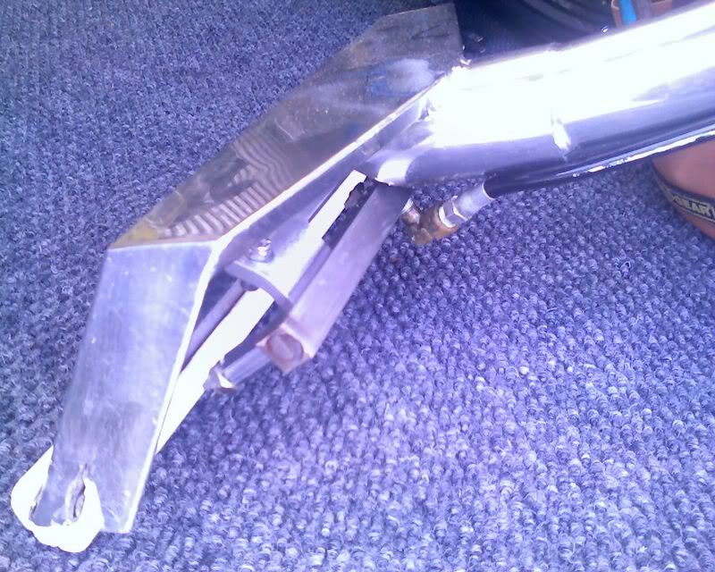

With either a Ti wand or this GreenGlides wand, a blower running with 14 inches or more of lift, and 500 psi you can do one pass flushing/rinsing.
There are plenty of neighsayers who are too cheap or set in their ways to try it but once you've given it a test ride you'll pack those RX's, RDMs and RV180's in grease.
Easier to use, no electric cord to hassle with, phenominal dry times, more then enough rinsing power and even gets in the corners and along edges.
The Wand, it's what Mother Nature intended.
Notice the Butler Style "Attic" for increased air flow, the true 45º angle of the jets, check valves for no drips and less heat loss, hacknotched for easy glide swapping, and 010 flow!!!!!!!!
G
Greenie
That's Mikey's Cobber wand with a Greenhorn kit, not bad for a 4 jet conversion.

Mikey;
The wand changes look nice.
However, if you really want the best flushing , then the angle of the jets striking the glide to too much.
You will get more flushing with all the jets striking the carpet.
Hitting the glide will dry faster, at the expense of losing the impact of directly striking the carpet.

Tried that Larry..
Streaks too much.
Low profile wands like this and the TI need the tweak or you get pile distortion/ un even cleaning even at 400 psi

With the jet extensions, the jets are very close.
Without the extensions and with "E" series jets, there should be no streaking.

Greenie
E series jets suck for proper overlap.
Actually the 5 jetter is a better wand setup on this particular wand, thank you Taf for paving that road on the CMP.
The Greenhorn kit has some adjustment, a guy can choose full impact, or partial glance.
The extreme angle allows excellent sheer and pushes soil and solution towards the vac slot.
The 45º angle also allows the cleaner to maintain fairly high pressure for cleaning impact, without overwetting the backing, the higher flow (some run as high as 012) and subsequent higher fiber temp speeds up cleaning and yet yields a net drier carpet.
I realize this may be unconventional, but don't think for a second it doesn't work, now to get the dist. network to embrace it...lol
