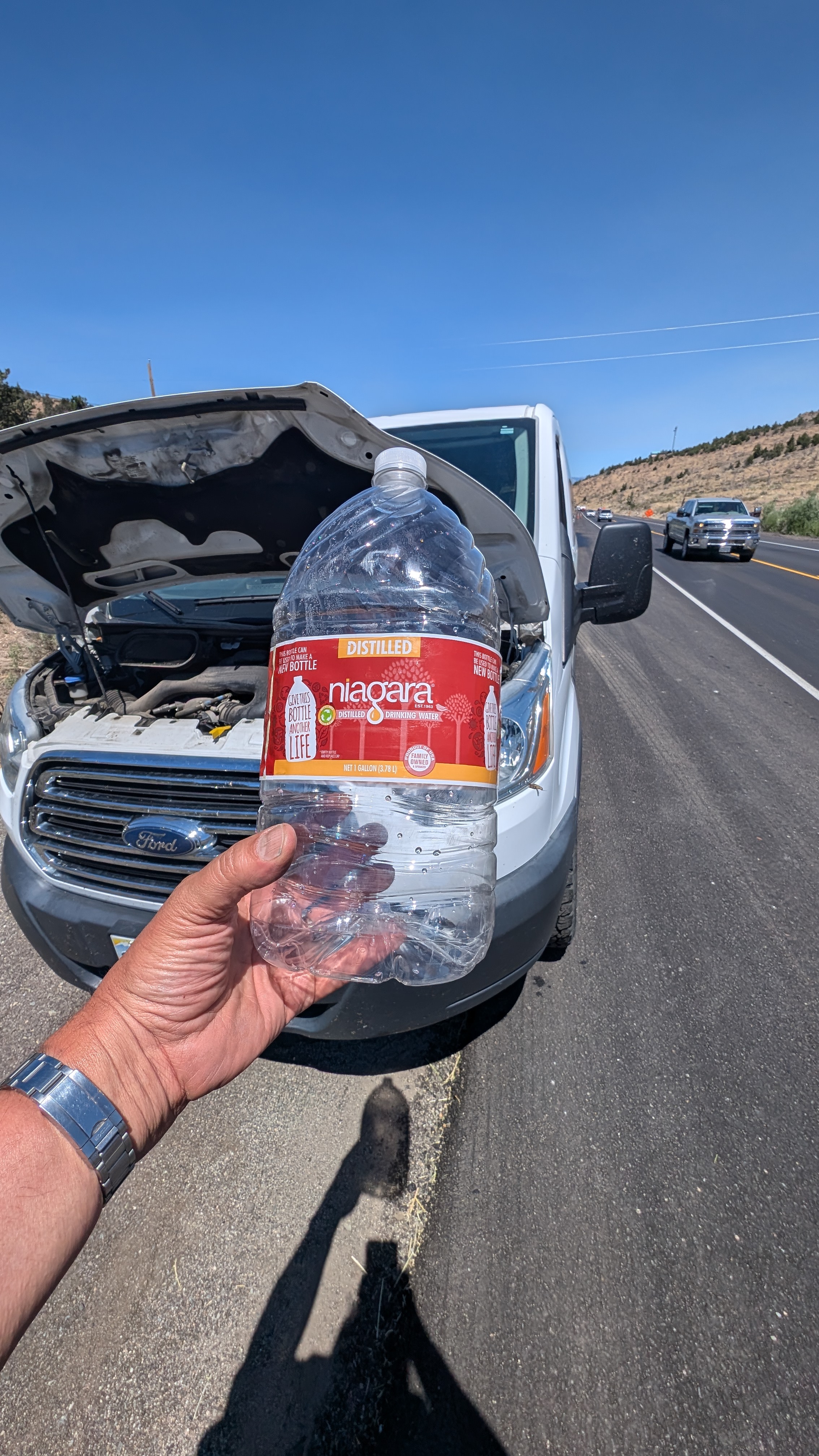

There's at least two reasons to always keep distilled water on your working vehicle
