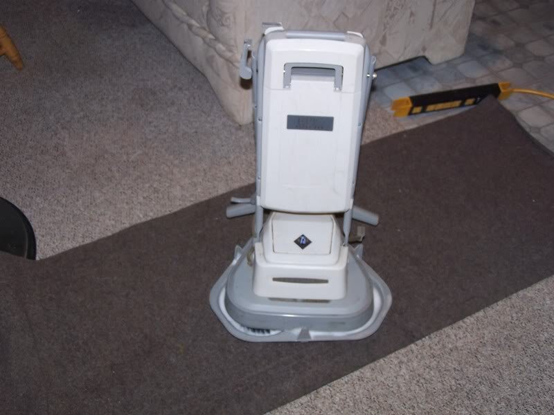

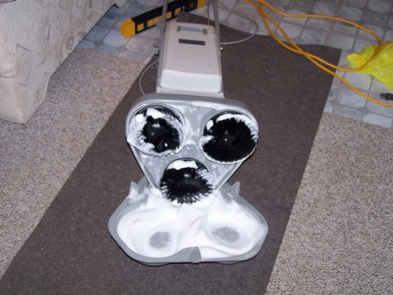

I was doing furniture, whipping up a foam in the pan shown bellow, then you remove a soft brush and brush and towel the furniture. I was cleaning expensive pieces without knowing shit.

We presrub all residential with it, it is light and has soft brushes (this may help with the CRI thing).
It has a shampoo tank so after pre spray we keep some encap or TLC in it so when you are pre-srubbing and hit a bad area you pull the trigger and give it a little more juice.
You can even pre spray with it if you want and we have one dedicated to rubbing in protector.
It is awesome for scrubbing stairs, we still use it stand alone from time to time on certain things.
I think it is one of the reasons our carpets dry fast, We have never pre scrubbed with anything else in a residential setting. (Except at home)
Sometimes I hear guys say they wish they had a light scrubber. This is it!

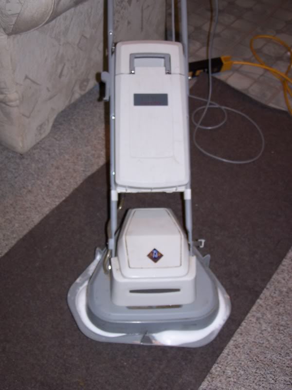

I buy every electrolux shampooer I find at flea markets and yard sales, I have made thousands off a 3.00 dollar one. The guy wanted 5.00 but I talked him down. I have paid 200. for a new used one. The one in the picture is in new condition and was 20.00 dollars at the flea market yesterday! I was testing it this morning and figured it was time to share.
