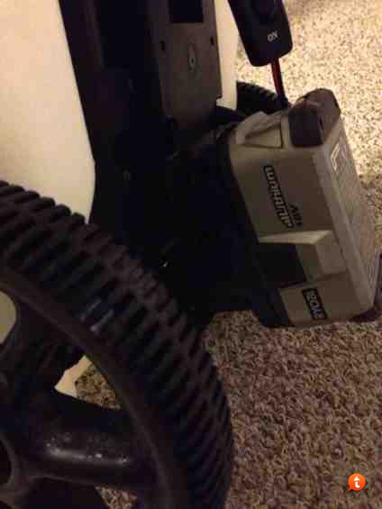

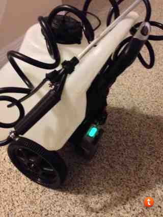

Now I just use modified battery sprayers with 18v Ryobi battery packs. Twice the run time (8 AH) and the higher voltage makes the pump work at a little higher volume, and once the battery is dead it just stops, so it doesnt burn out the pump. And you just click in a fresh battery :)

You outa post a pic of those sprayers. I love ryobi stuff

Justin,
Here are the 5gal sprayers modified to accept ryobi 18v battery's
