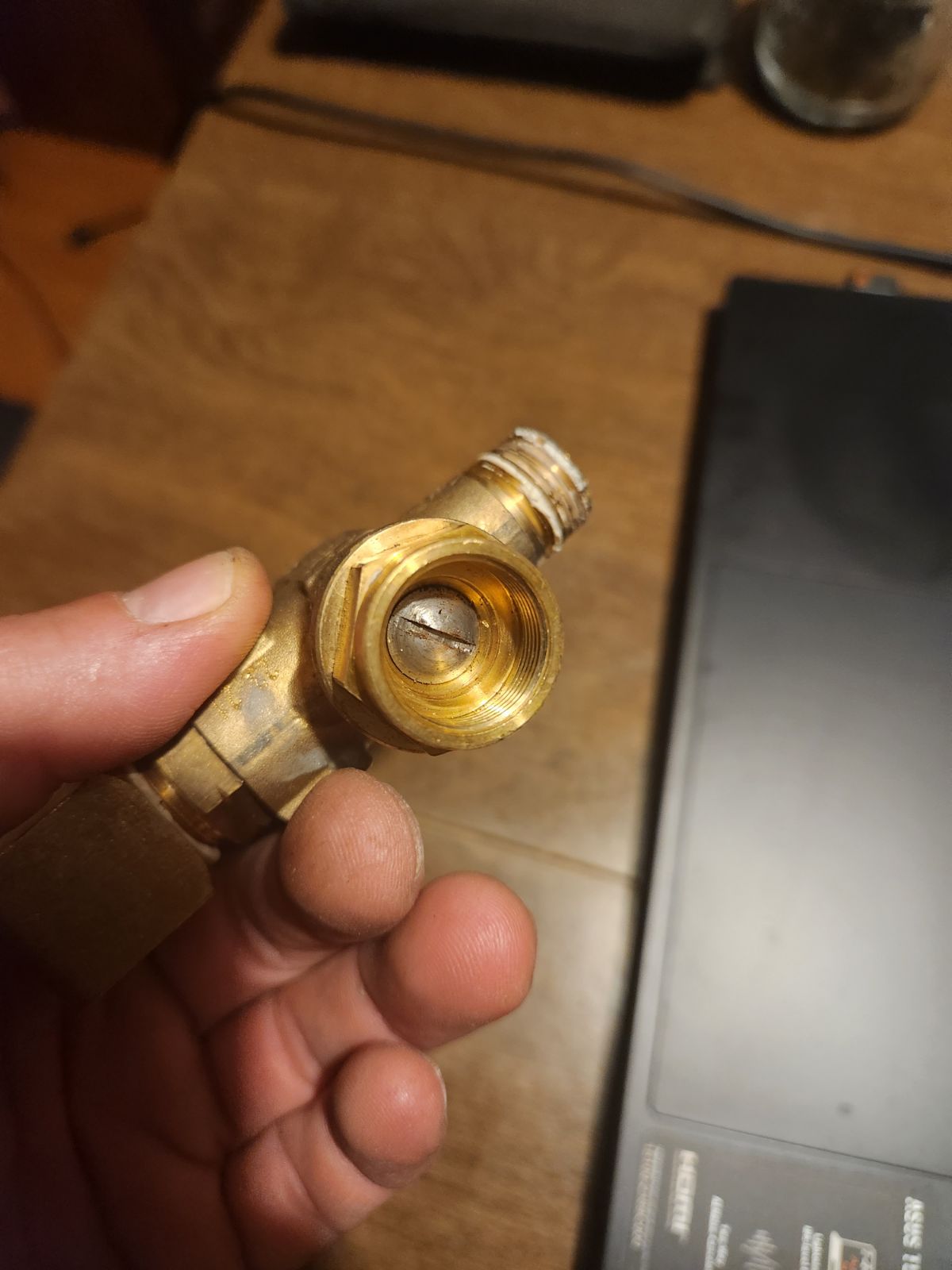

The Pegasus 500h parts list call it a pressure regulator/unloader. The plastic knob just has a spring and shaped metal disk/pin at its base. This is the valve. I read somewhere there is a piston that can be lubricated. But this thing that has a screw head doesn't seem to come out.

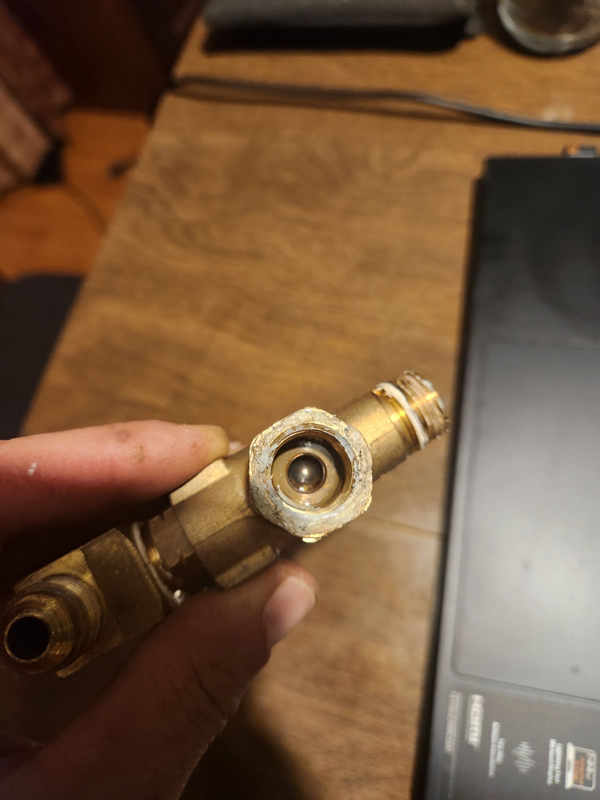

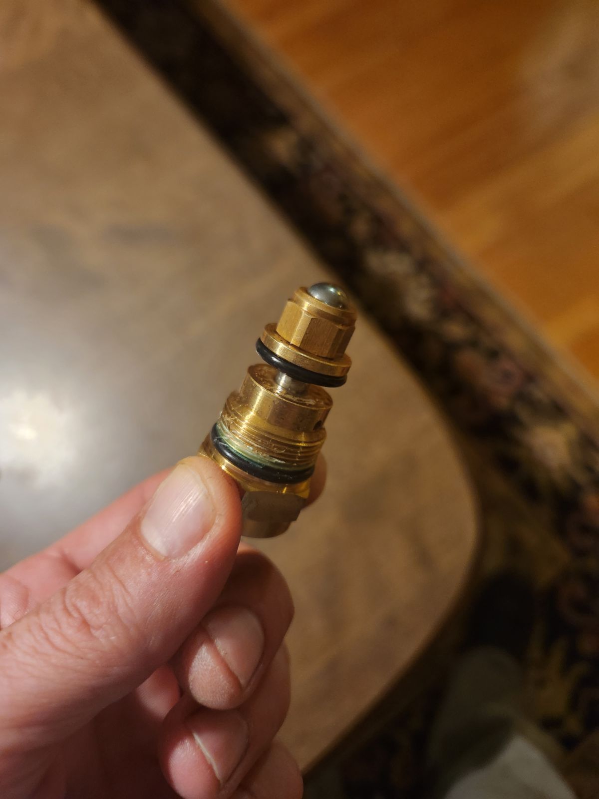

Found the piston. Cleaned and lubricated it and the extractor is still doing the same thing. I think it's a regulator type pressure valve. It hovers around 150 with the pump on and turned all the way up. Pressure with the trigger squeezed is 100 max.

You may be missing an o-ring or they may be worn. Doesn't look right. You may want to replace the unloader valve. Also the machine may have frozen at some time. There may be a hairline crack in a fitting somewhere. I recently had an issue with one of my portables. Had a hairline crack in an online filter. Only discovered it when it started leaking. Similar symptoms to yours.

Thanks man! I'll call around and see if I can find a replacement valve somewhere soon. Couldn't find an inline filter anywhere though. Seems like a pretty simple setup in this thing.

Got it running this evening. When I picked up the new unloader valve I could feel the tension in the knob was way different. Thanks for the tips 🙏
