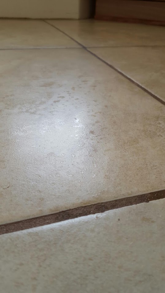

A member here sent me this wondering what is going on..
Zep stripper wouldn't touch it...
Took a razor to get SOME of it off.
I'm guessing someone sprayed a lacquer on it, creating those droplets..

The lacquers I used years ago in my automotive days re-dissolved easily with lacquer thinner. Is there a lacquer-based floor finish? That's a new one on me.
GeneMiller
Mar 24, 2009
3,547
Boca Raton
gene miller
Dan is right, lacquer comes right off with lacquer thinner. If someone was working on the cabinets it would probably be a two part conversion finish. Much hard to remove.
Gene
