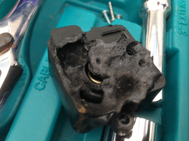

Well, I got my flowjet back up and running today. Decided to further investigate while I was awaiting my mytee motor from Bridgepoint. Upon closer examination in the daylight I noticed that just the switch had caught on fire and burnt up, luckily for me I had purchased a spare switch ($50) for replacement. So I replaced it and she is good to go. I'm still going to switch the POS Flojet to the Mytee C361 cuz I know the flojet will only go down again it's just a matter of when!

Is your pump properly fused?

Well, I think we came to the conclusion that we have a short on the ground. WhenI hooked up the pump directly to the battery, it ran. I have power all the way to the pump checked with a wire tester. What/how is the easiest way to find the short? Sorry, electronically challenged, so bare with me:errf:. There are not alot of connections to the wiring, so it should be simple, right? Thanks for any help!

Use an ohmmeter to check continuity. Start where the ground is attached to the frame and work your way to the pump.

I would just rewire the pump.
Quicker and easier.
