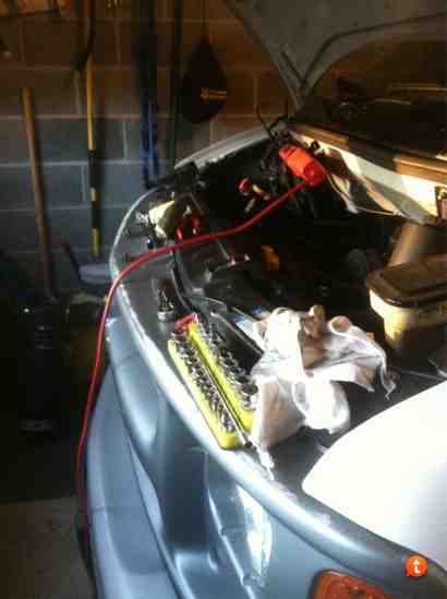

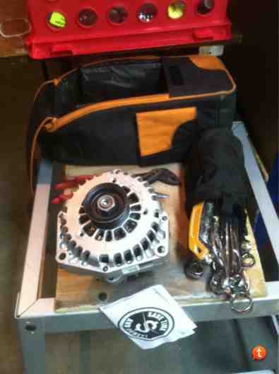

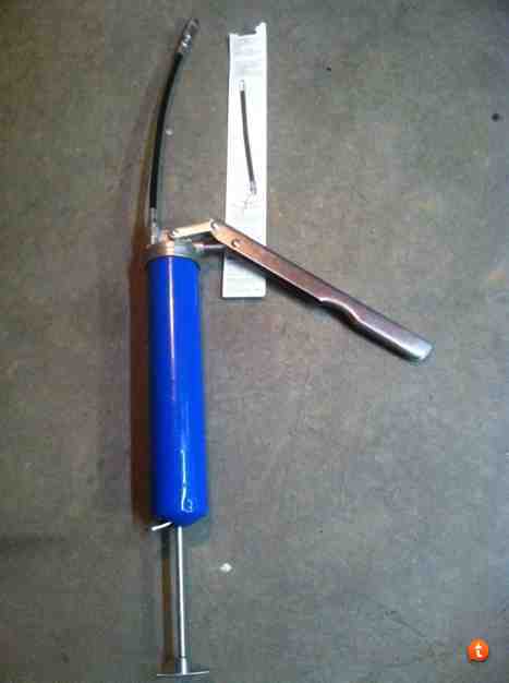

Squeaky Alternator Bearings and a pain in the azz grease gun got fixered today.
Birds chirpin under the hood kill my nerves : )
The Victim!
My lil go bag that has everything to fix anything truck or mount related!
A flexible grease gun hose is a must for any serious blower owner!

So you don't need to replace it? My daughter has a squeaky one on her RAV 4. The garage next door told me $300.00.

Damn Doc!
Cost me $78 and i got a pack a 24 white rags, antifreeze, hose fur me greasy gun, box a black nitrile gloves, brake fluid 2 fur 1
