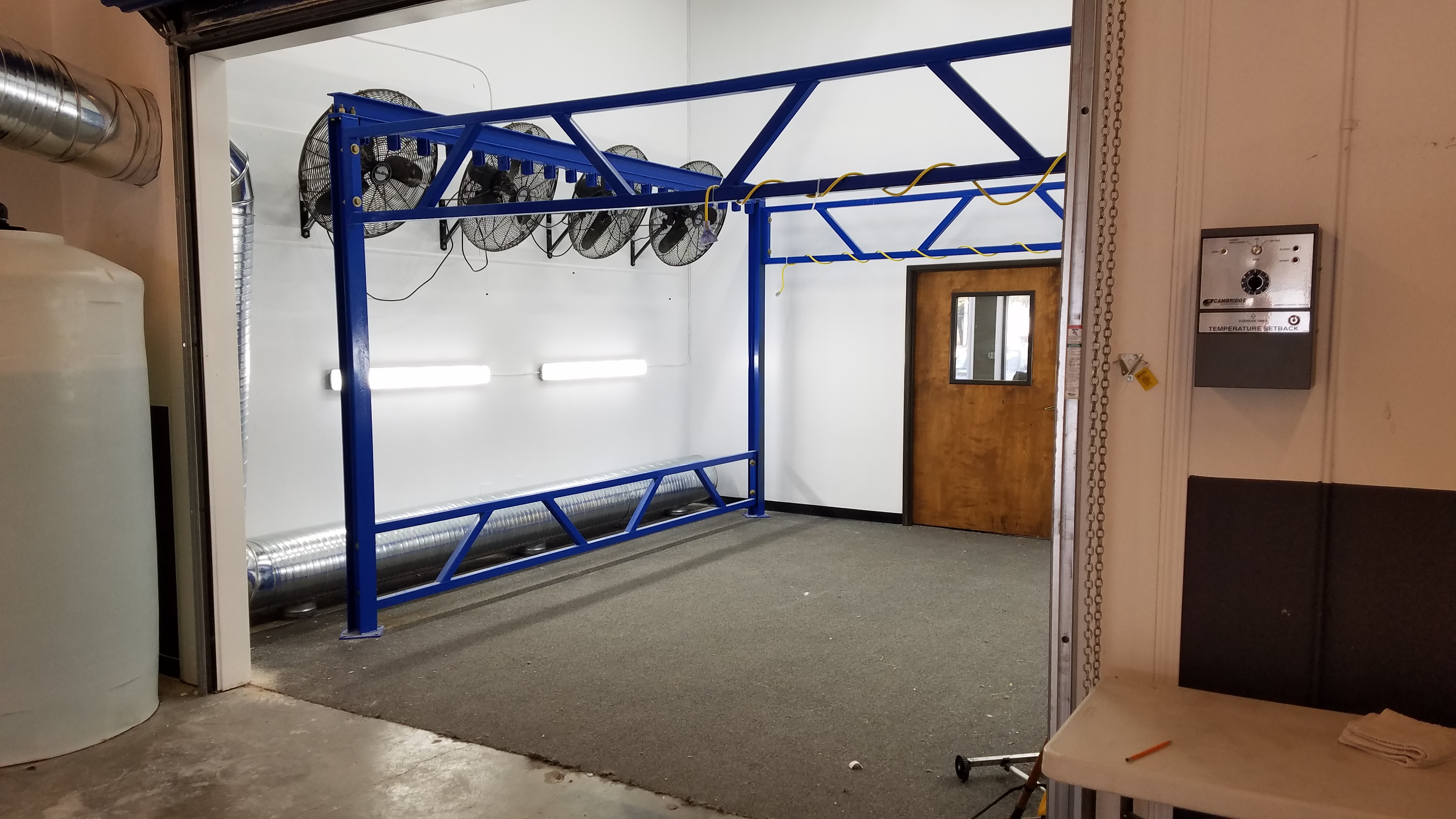

Our dry room upgrades are happening this week. We've been drying in this 16'x16' room with 2 dehumidifiers and air movers for the past few years. With our volume increasing, this method has become less and less effective. We are filling more poles every wash day which is equating to more moisture we are attempting to remove with humidification and our dry times have been suffering (12-20hr+ dry times).
With this new Cambridge SA-250 space heater we expect to see ambient room temperatures hovering around 120-140 degrees, shortening our dry times to consistently less than 8 hours. This allows us to get right into rug finishing the morning following a wash day, effectively allowing us to wash 4-5 days a week without compromising efficiency. We will be using less electricity and overall delivering a higher quality product to our clients.

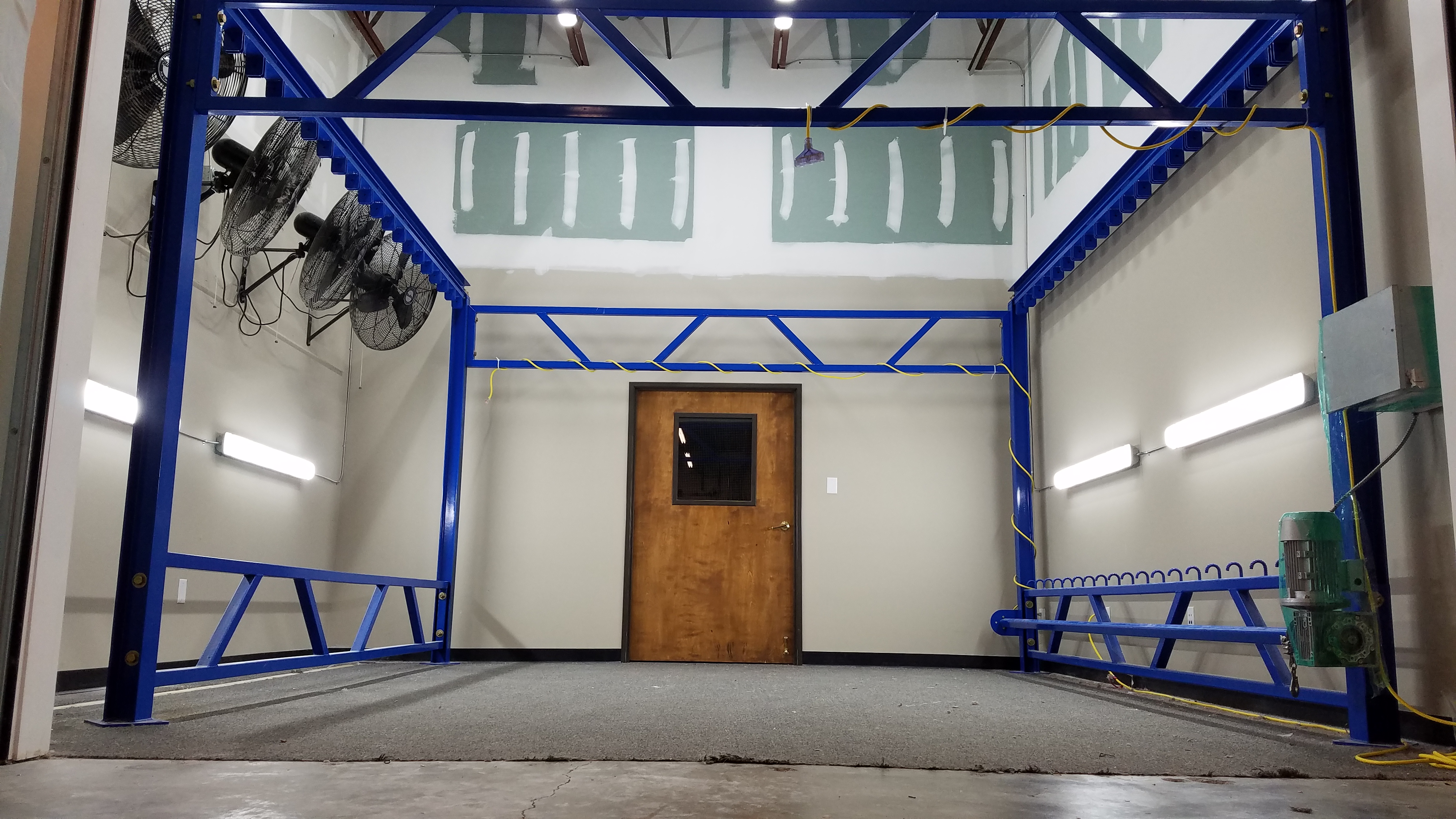

That is phase 2, happening probably end of 2018. We are planning to deconstruct the entire tower, send the 4 iBeam uprights out to be cut in the middle and extend 5.5' with new steel and re-powder coated, thus allowing us to maintain the same bolt patterns for the cross bars at the top and bottom and the wench driver function. Then lengthen the cabling and reconstruct the tower. While it's down we plan to rip up the carpet and grind the concrete smooth.

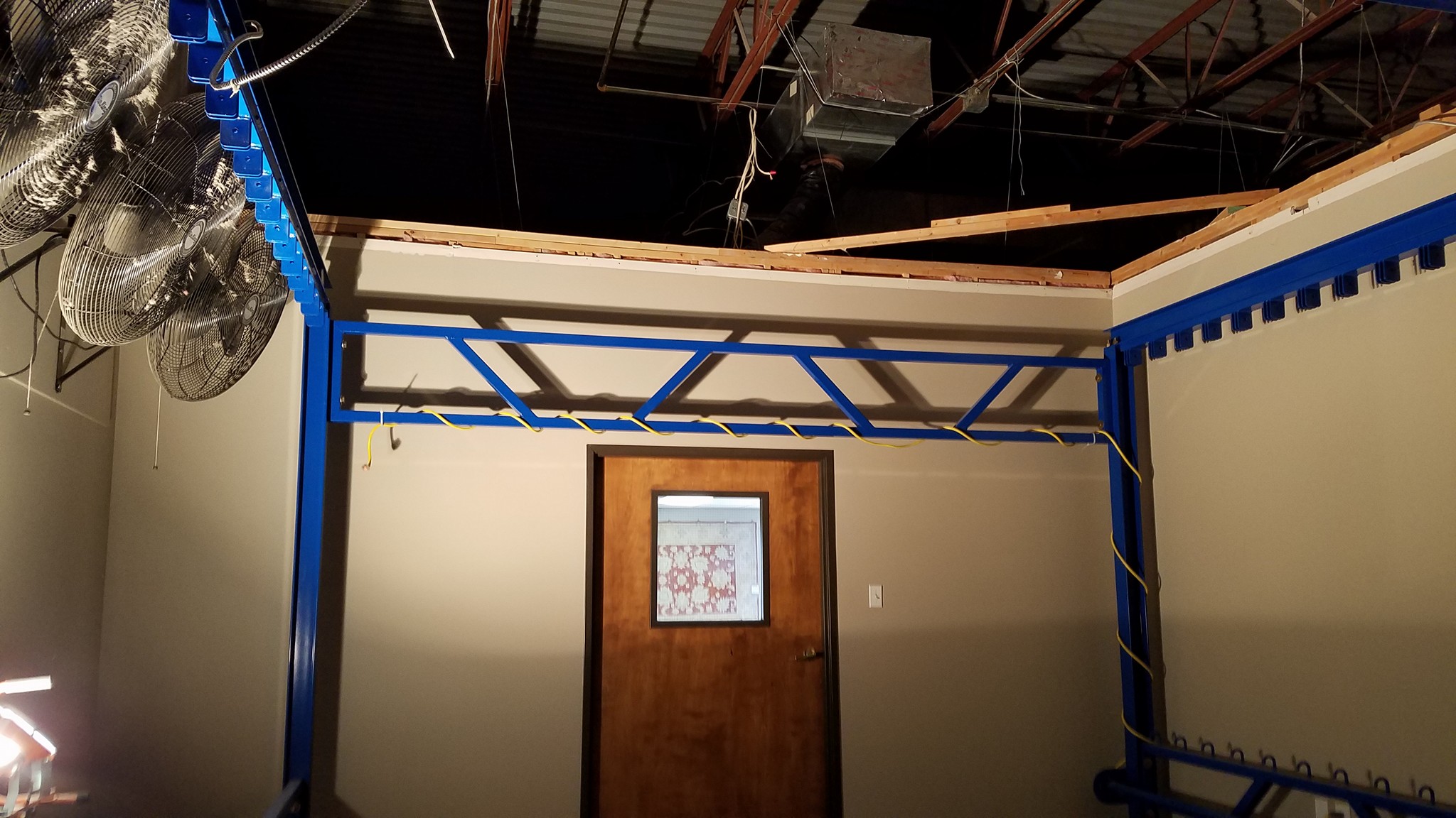

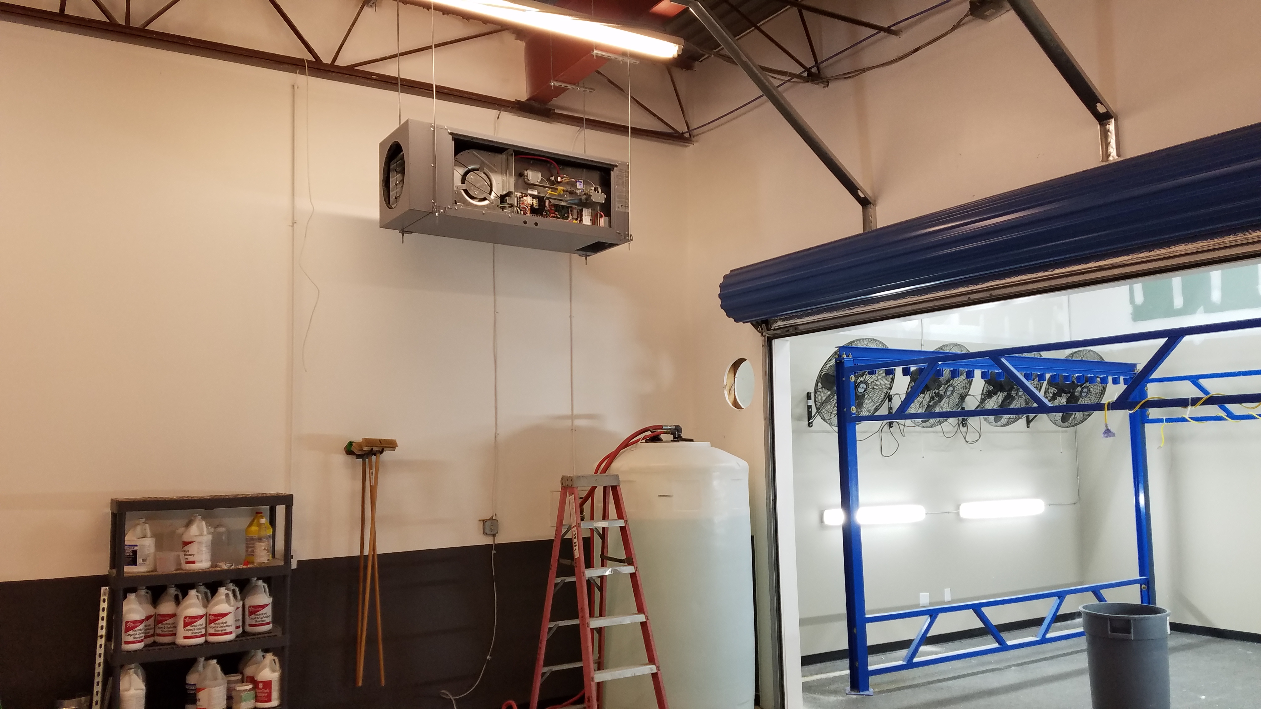

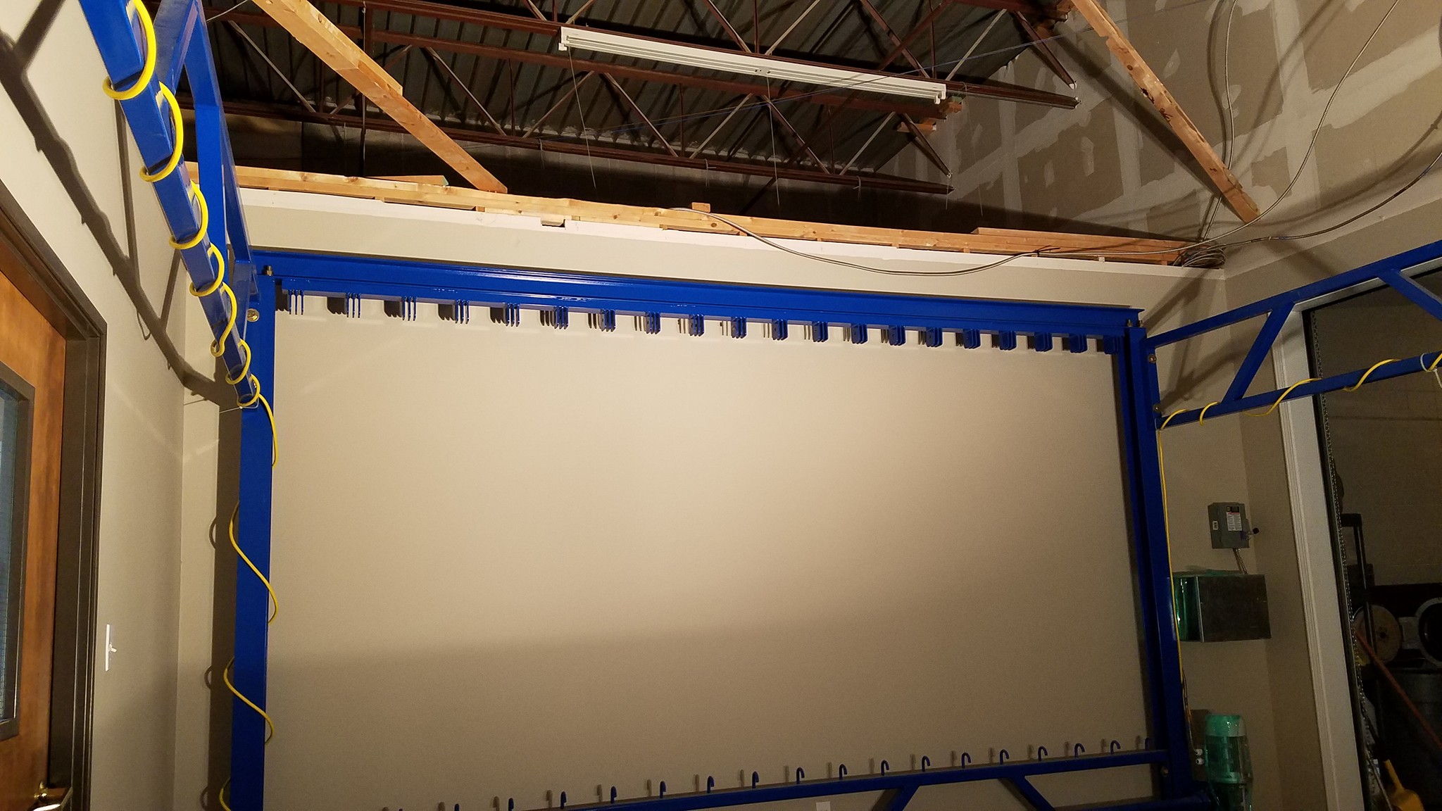

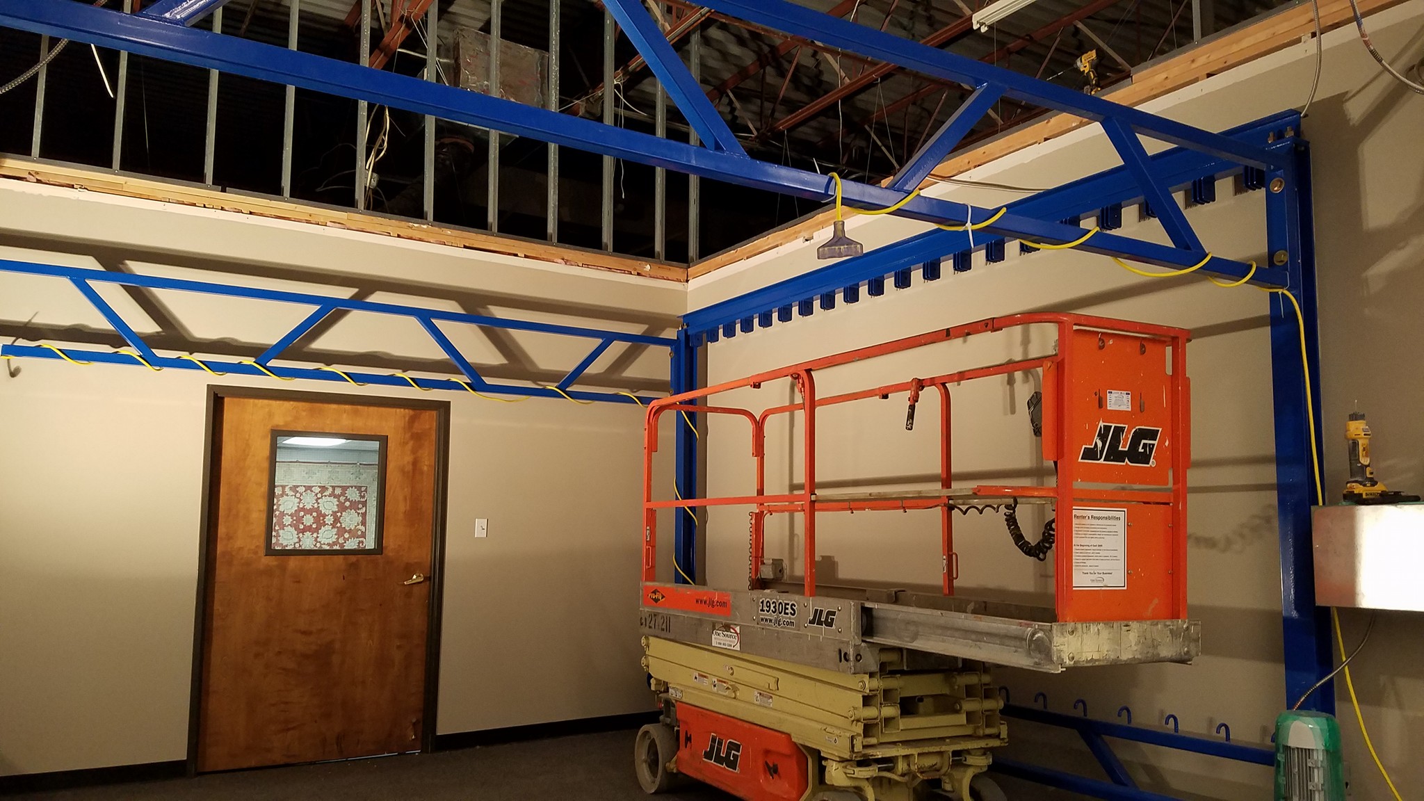

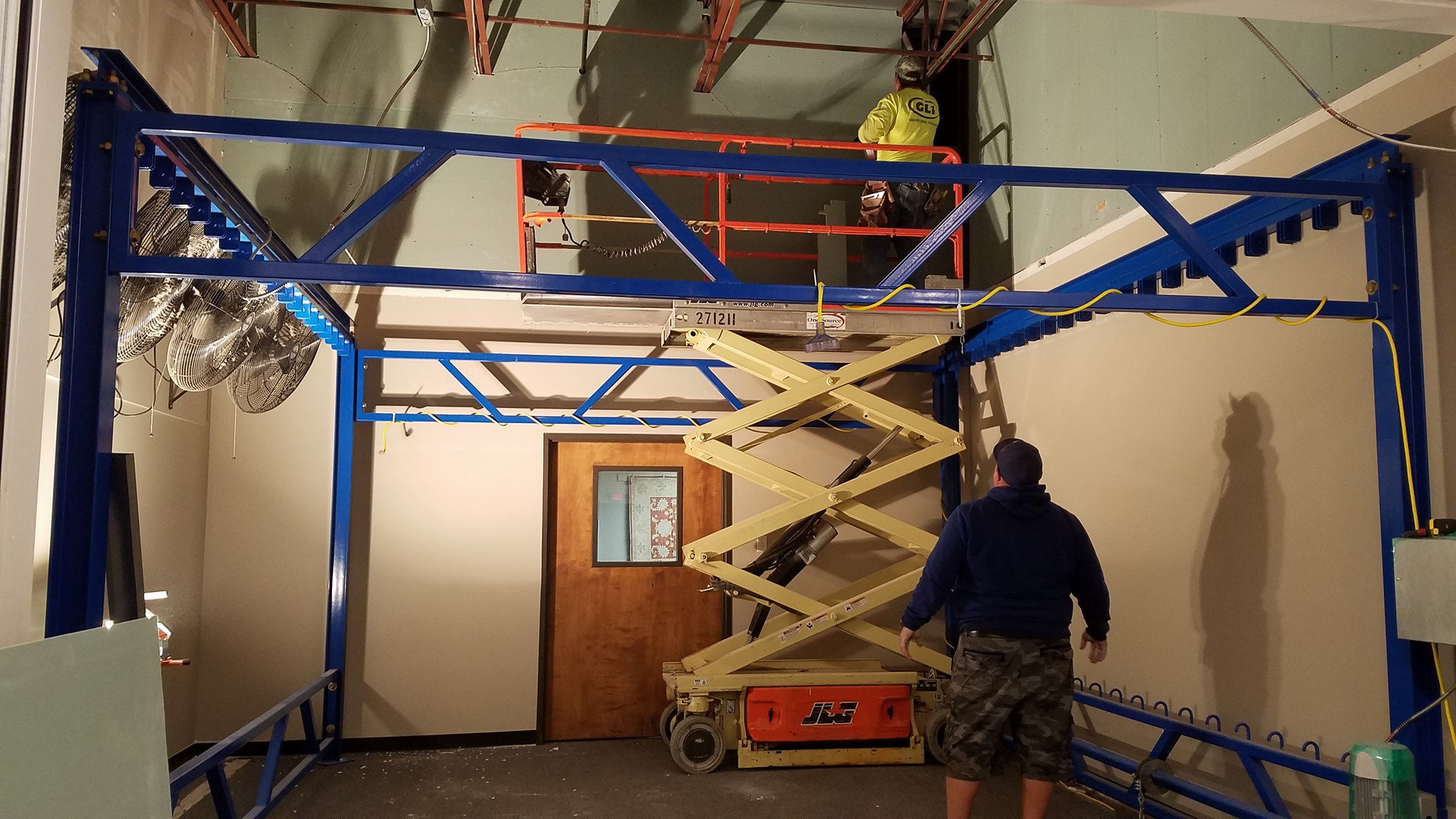

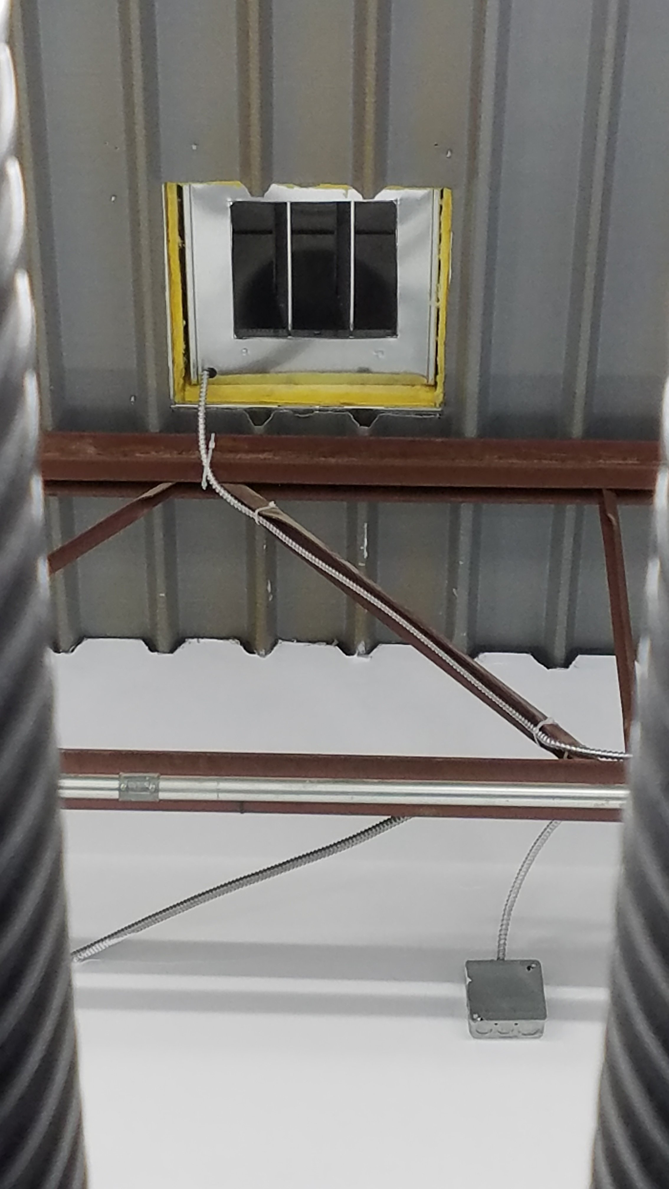

Holes cut in roof for intake air and exhaust fan. Cambridge unit hung. Intial gas lines put up. Ready to hook-up gas tomorrow and get some ductwork installed. Painting completed tonight.

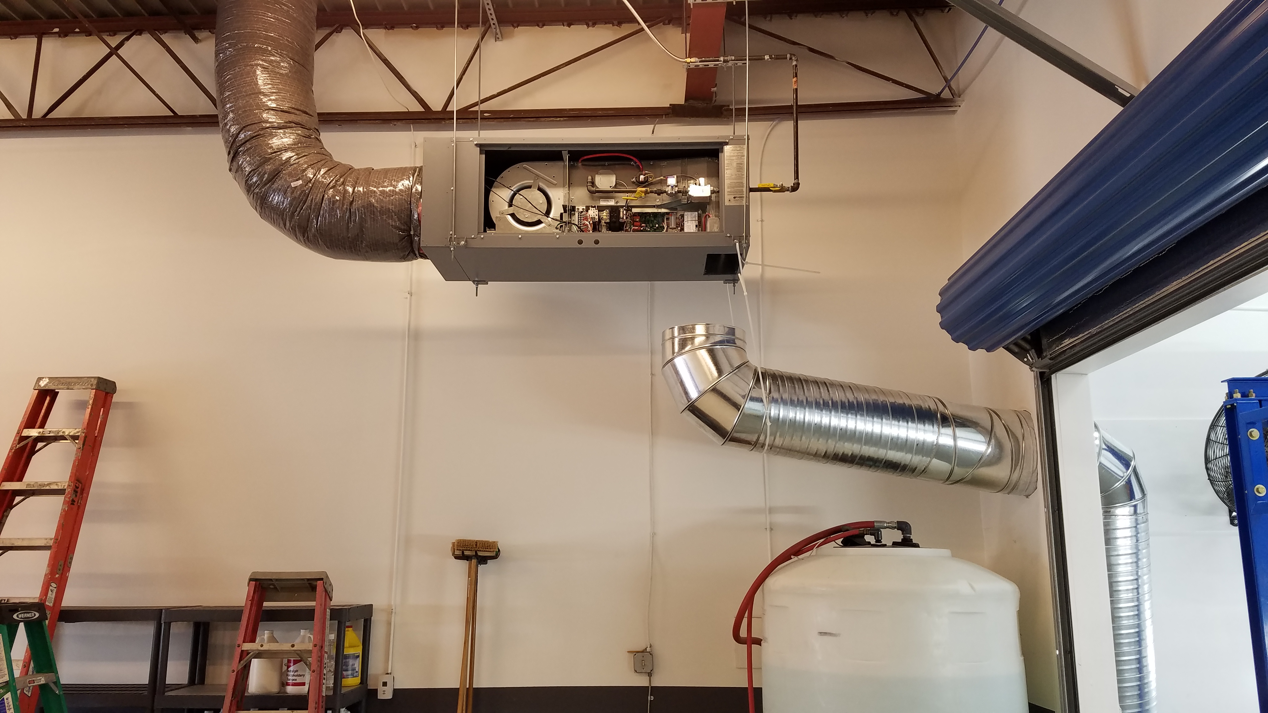

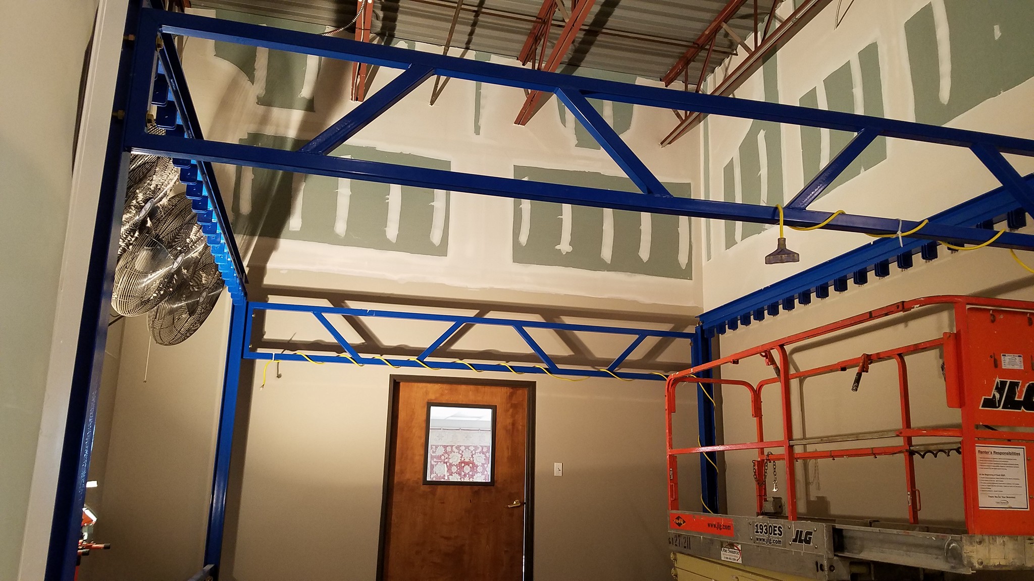

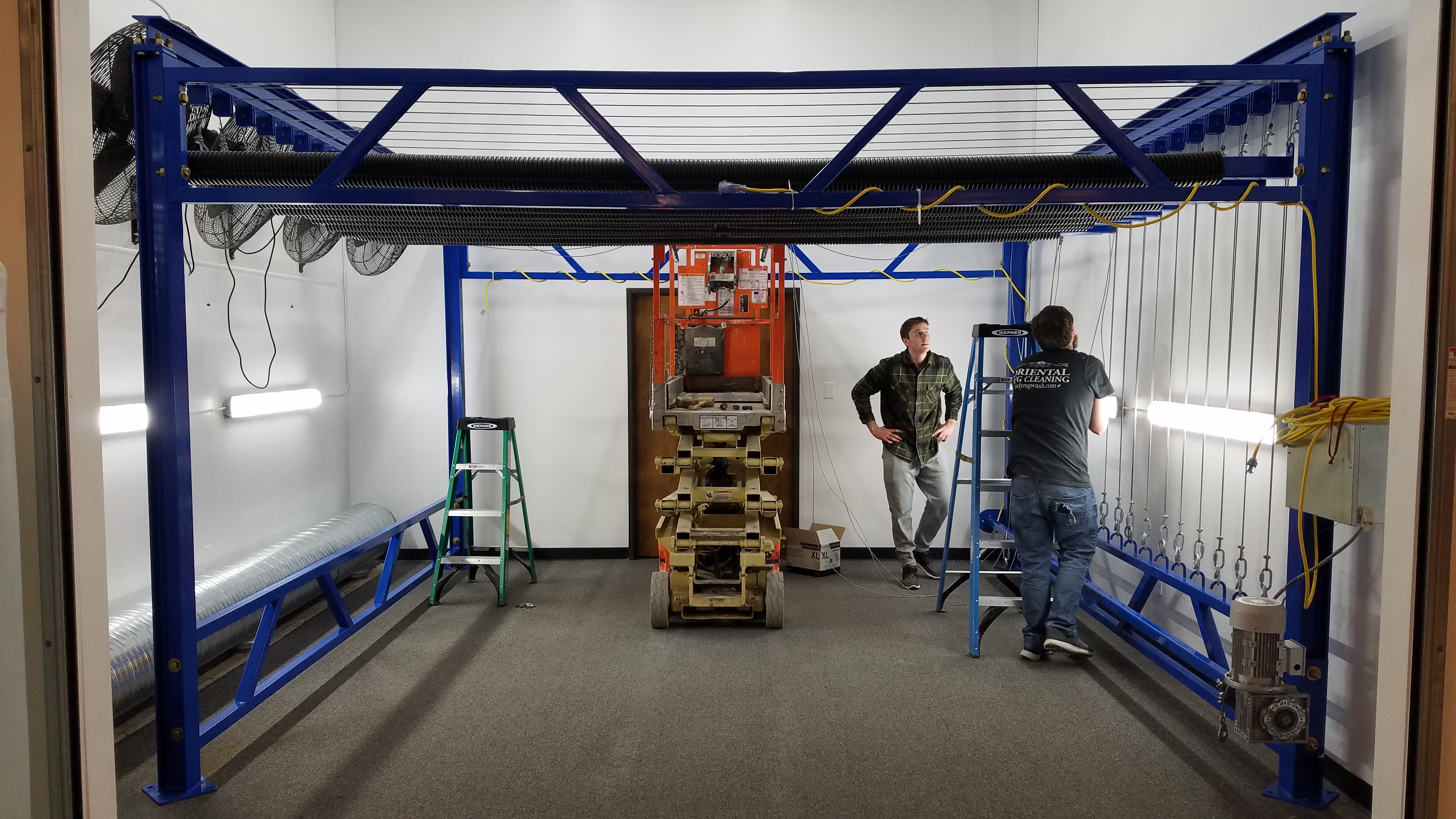

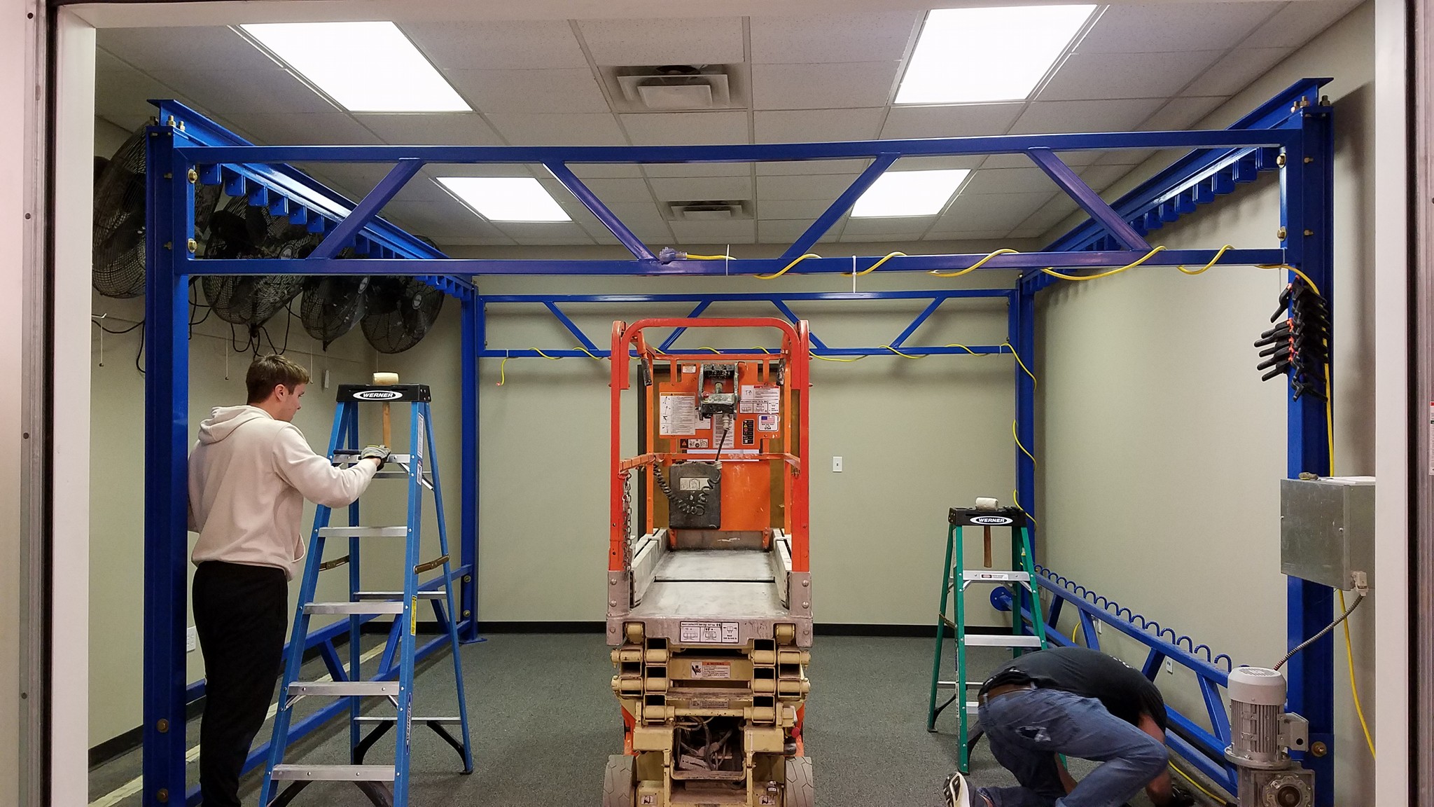

Initial semi-post project cleaning complete and dry poles are back up. Tomorrow the electricians and HVAC guys are back to wire it all up and finish a few small duct-work items. I'm pleased with how much light is still on the floor even with the poles up. I figured if I can make it obnoxiously bright before the poles and rugs are hanging then it should be plenty bright for when they are hung.

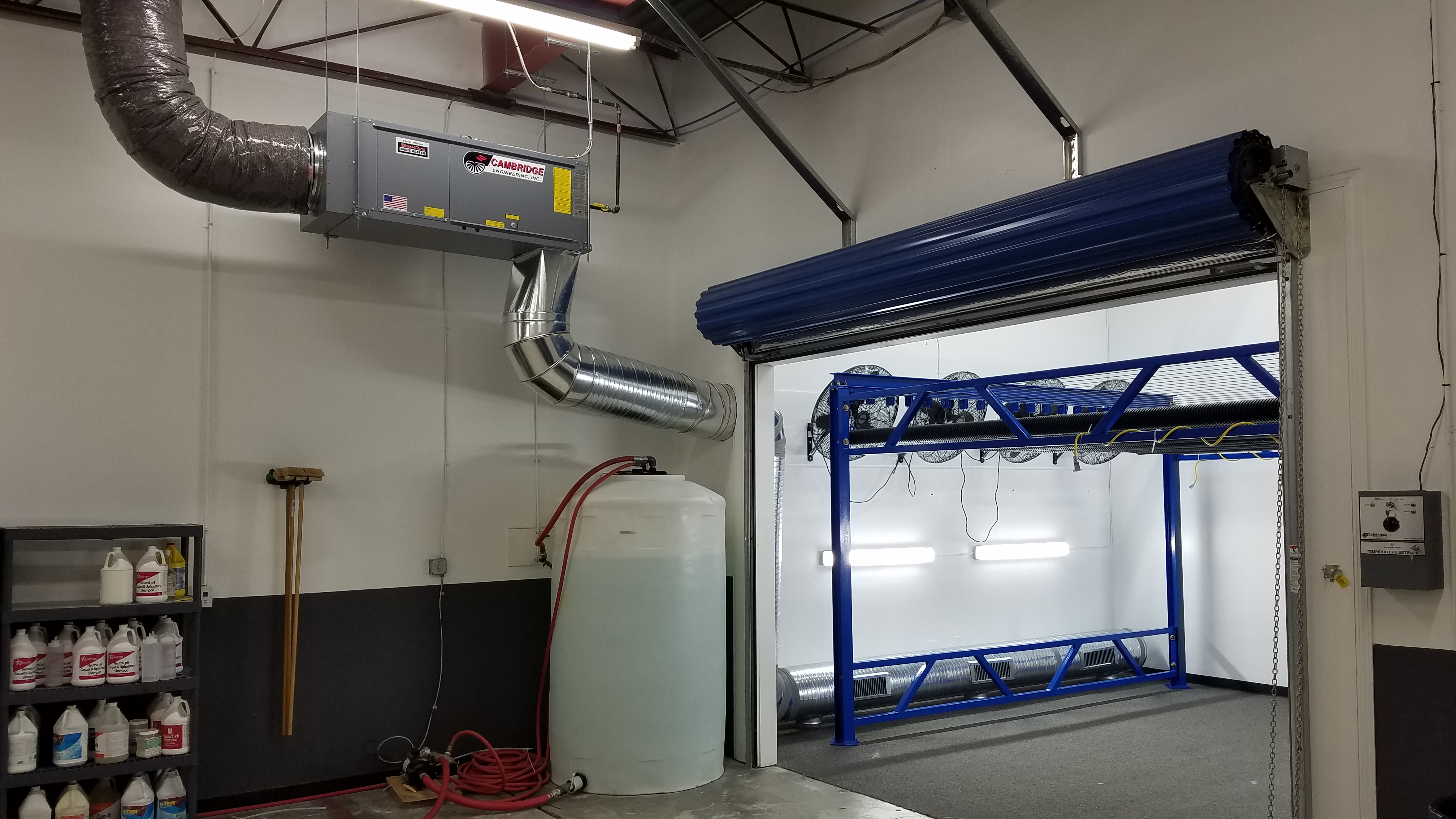

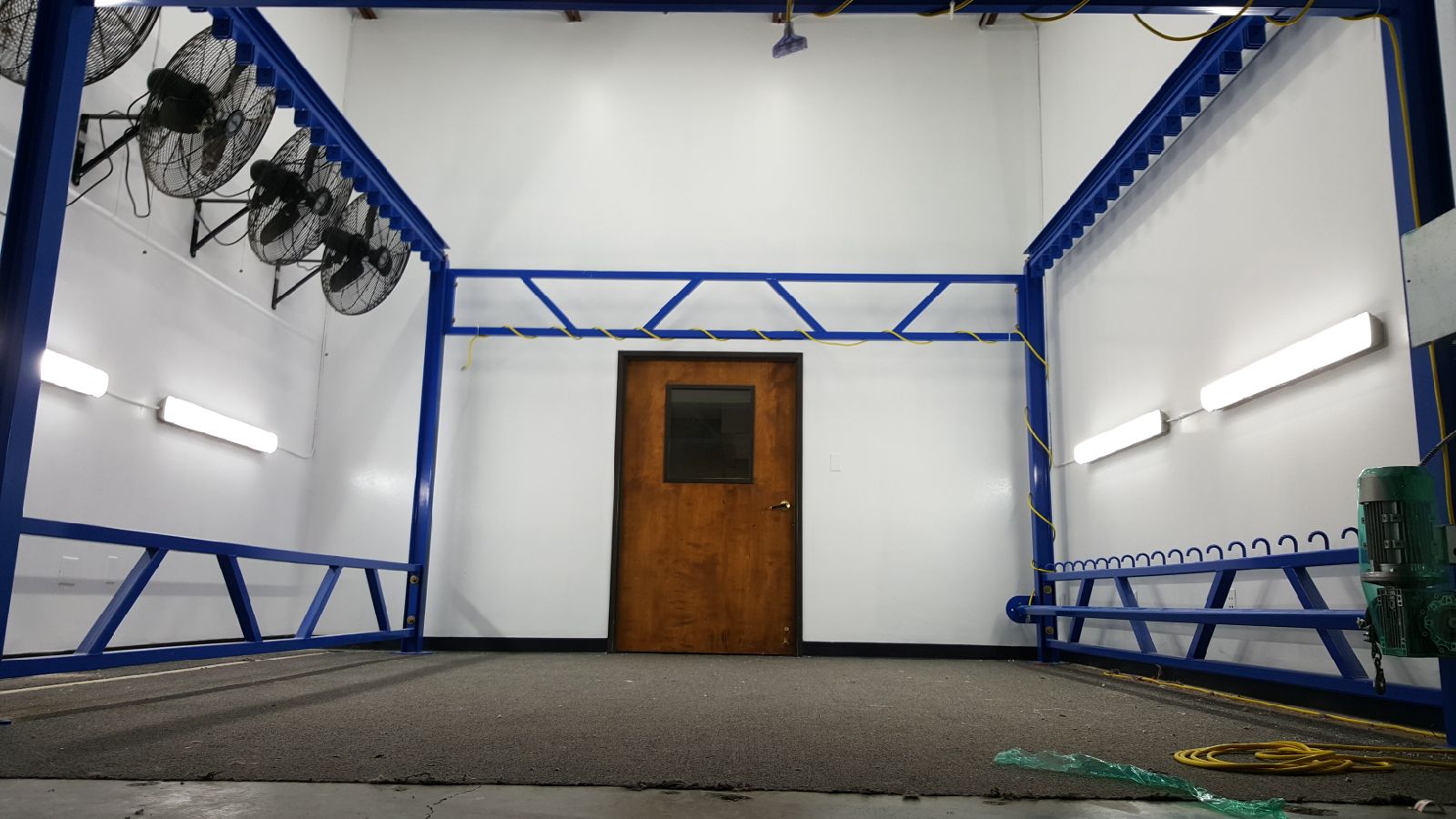

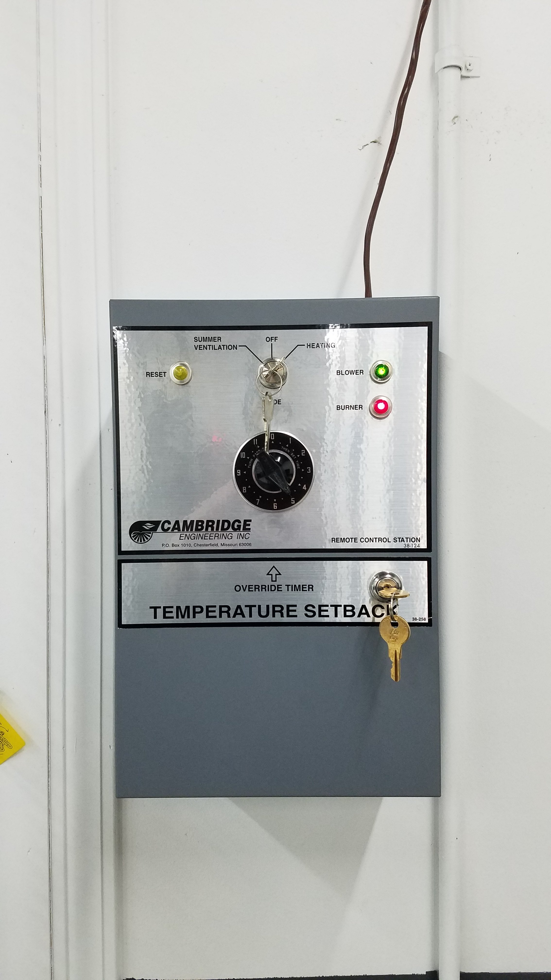

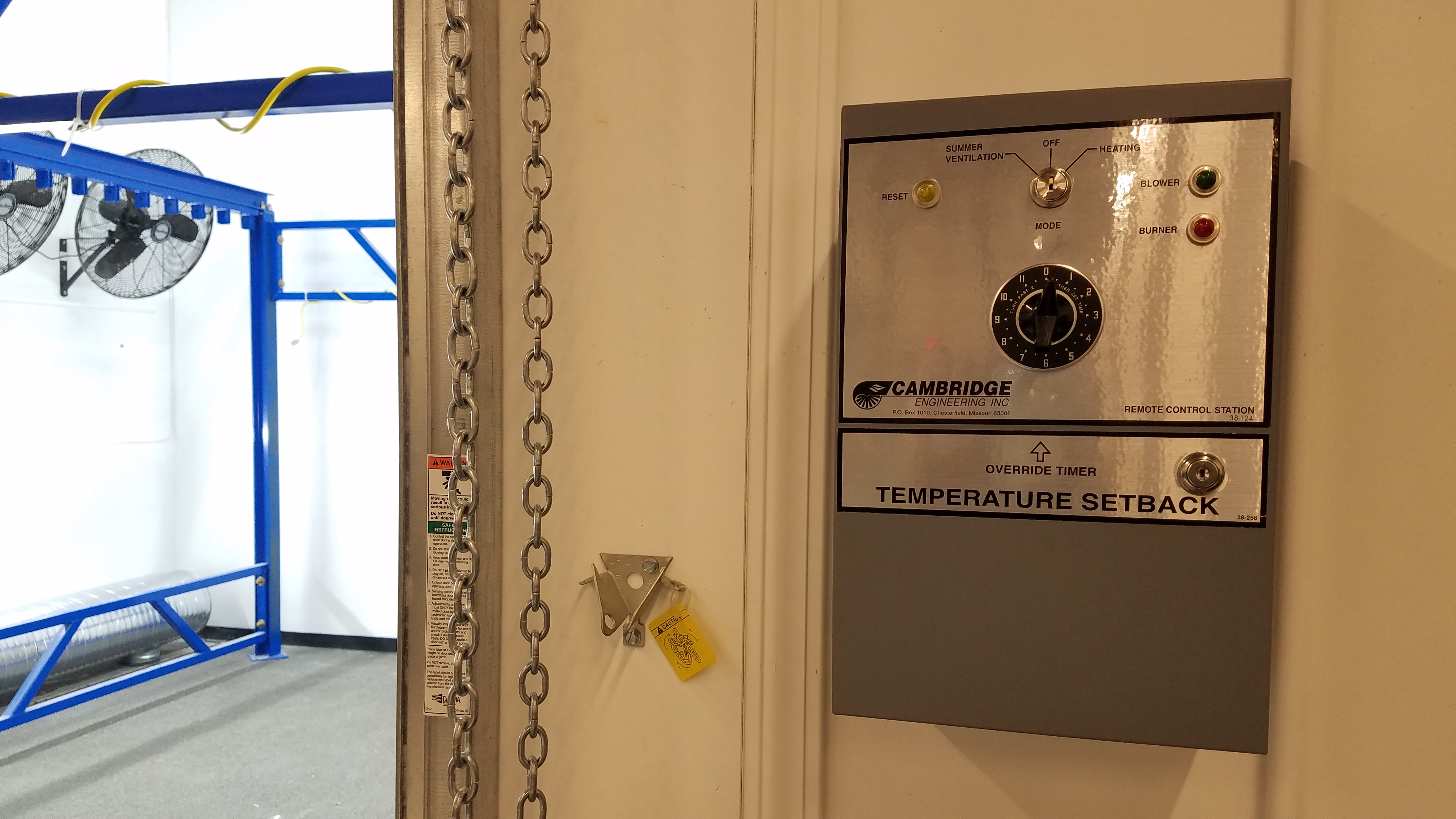

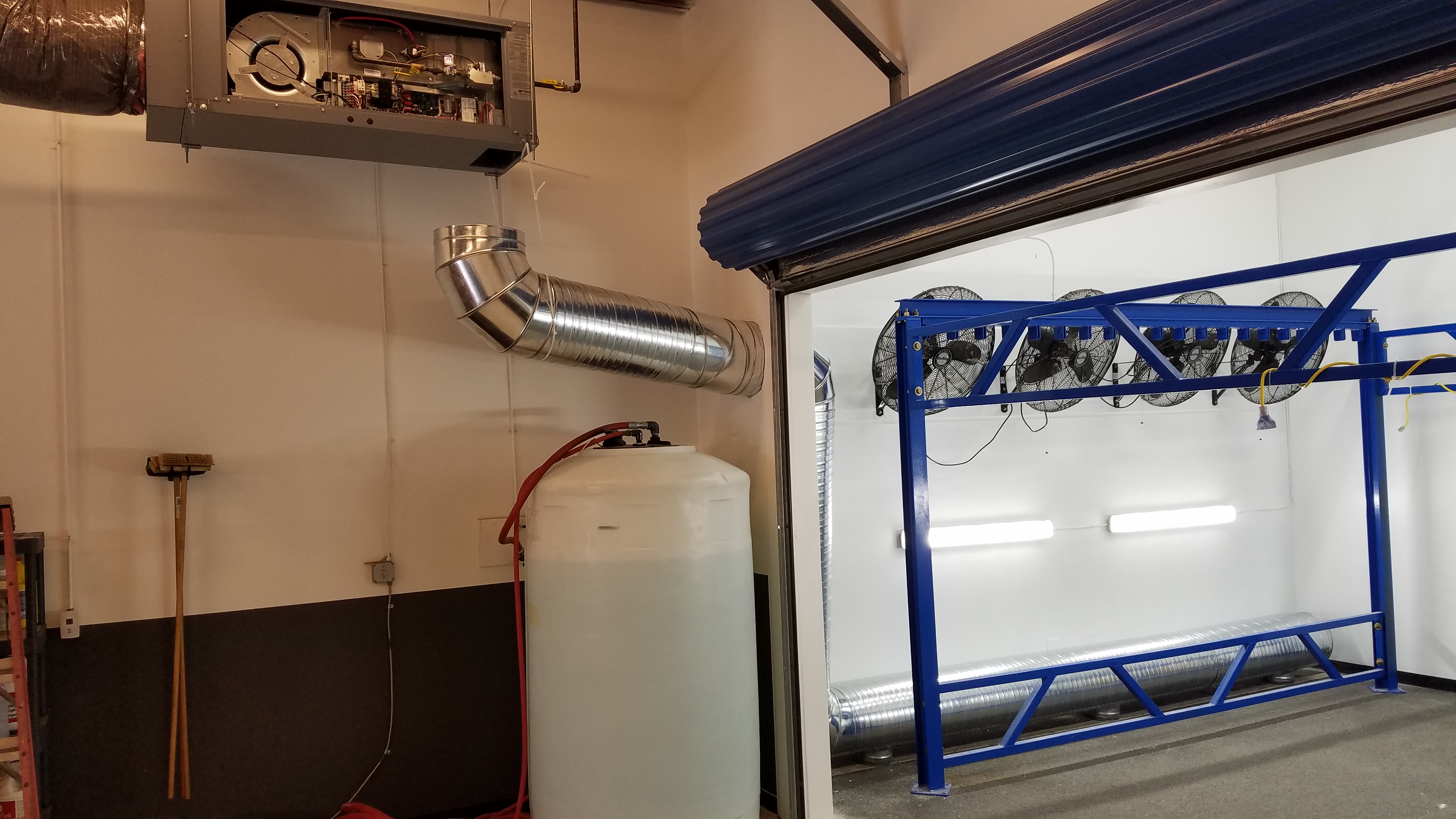

After a long afternoon on and off the phone with Cambridge we've got it up and running.
Exhaust fan properly interlocked with the Cambridge heater, damper opens and closes as the unit is powered on and off.
Had a manufacturer mechanical error with our damper for the air intake, Cambridge was very helpful and is sending us a replacement. Ran it for about 45 minutes, it packs serious HEAT! Can't wait to get a load of rugs in there Monday.
