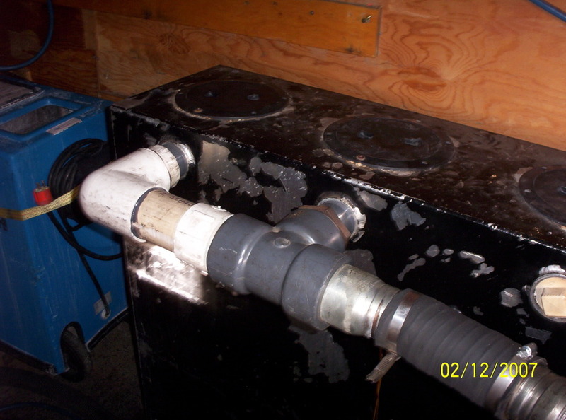

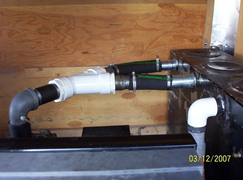

ok lemme see if i can do these small
old setup
new setup

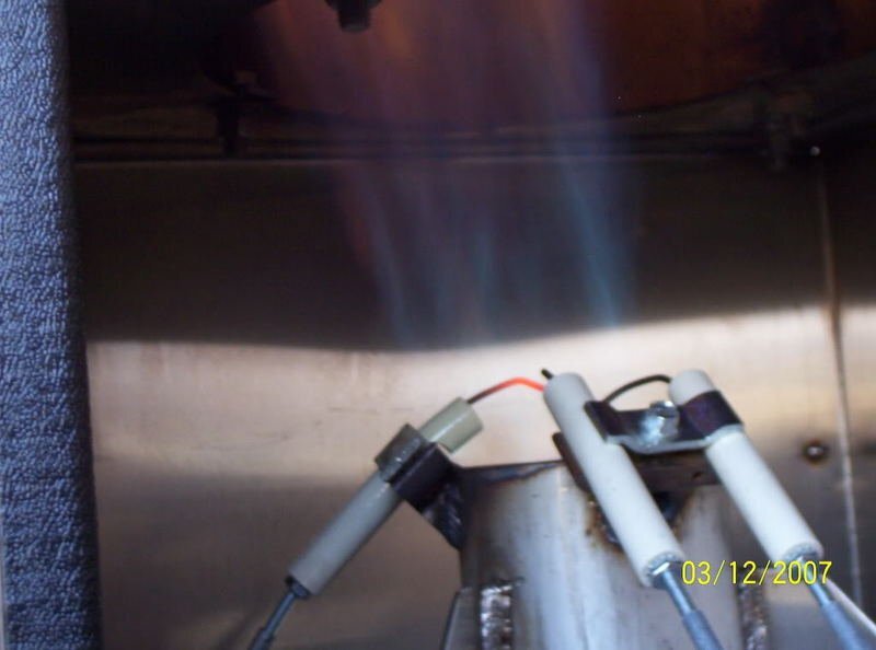

single burner
dual burner on
hard to see the flames in the daytime, ill do a night time pic later
fixed my FLAME issues...had a wire fromt he ignitor come off the relay causing issues, reattached and fires just fine

That LP heater looks like a flame thrower, how is that jet type working out, does it heat the whole coil evenly? I'll bet it has wicked heat with the 012 flow wand.

yea eddie that thing has 5 ports...2 are used for the blower(that's why no just 1 4") 1 is for the relief and 2 are for the Y for the vac hose...
haven't noticed much machine noise difference though i need to fix the throttle control it keeps sliding back in...grah pisses me off

we boobooed a little and made it to low for the spacer/check valves...that's why they aren't there.
when i throw the dual stage on it gets damn hot right quick...in fact it will vapor easily...and makes all kinds of volcanic eruption nosies...hahaha
and the vac has increased quiet a bit...i need another house to test it on...and after this week i will be pushing a little more, have had other things that have taken up the weeks time...
