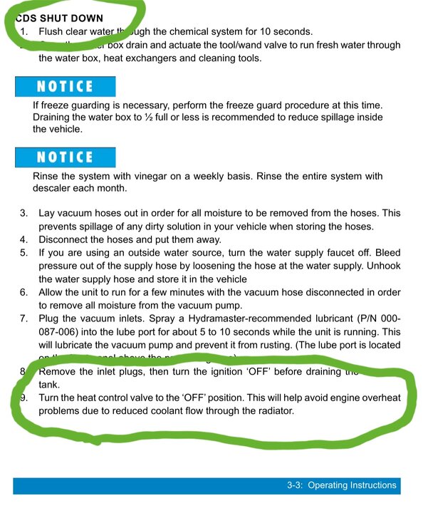

I didn't read it on Google AI originally, I think it was mentioned briefly on one of Hydramasters maintenance videos. But they recommend leaving the coolant valve closed while driving as to not overtax the engine coolant system. I assumed they meant it would overwork the water pump but I never thought about it much and just closed it every time I drive. Anyways this came up on Shmoogle AI for what it's worth:
"Based on information found in HydraMaster manuals and forum discussions, you should never leave the coolant flow open while driving, as
this is a potential cause of overheating. The HydraMaster CDS (Clutch Drive System) is designed to operate only when the vehicle's parking brake is engaged, and the control system should shut off the unit if the van is put into motion.
Here is a breakdown of why this is important and what can cause it to happen.
Risk of overheating
The HydraMaster CDS uses the host vehicle's engine and coolant system to operate.
When the unit is on and running, it places an extra load on the vehicle's engine and cooling system...."

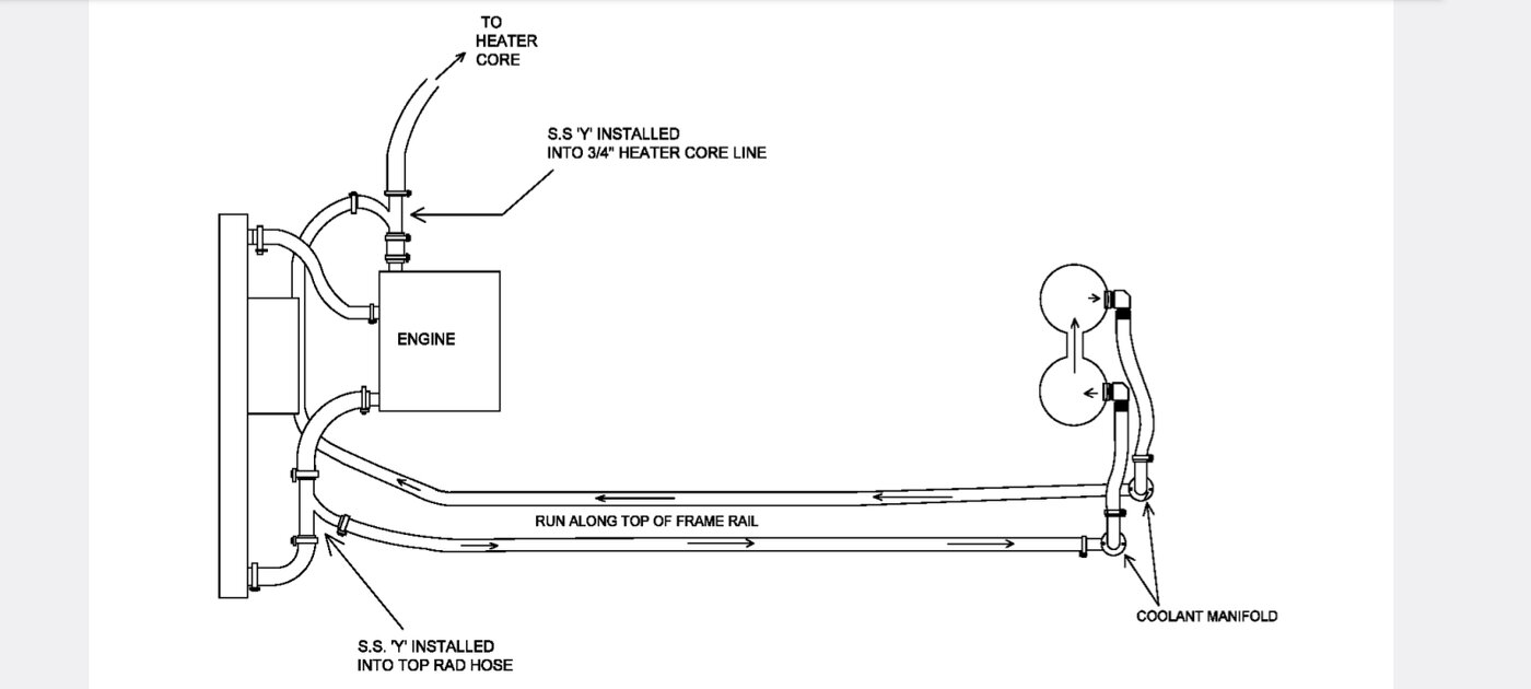

If you look closely at the diagram and can read / picture the flow youll see that my system is paralleled. A paralleled system can be closed off whereas if it were in series it couldn't be shut off without effecting what ever else is up or downstream
Risk of overheating
If the valve is open more coolant is flowing thru the system to absorb and distribute the heat. In the old days before fan clutches and shrouds if you drove thru the desert you turned on the heater to have a little extra cooling for your engine. So if you have 2 extra gallons of coolant in the system you now have that much more cooling capacity
From the diagram it looks like one HX in your setup receives coolant from the inlet side of your engine, and the other HX receives coolant from the outlet side of your engine. And yet each HX flows into the other HX directly. Its like a big engine coolant party you have going on there Dwain-o. Forgive me I don't understand the difference between parallel and series setups. I should because I learned about that in DC electrical when I was setting up solar panels on few RVs and a cabin. Maybe that was completely different though...
That makes good sense to me. You build way better truckmounts then them, and your my bud, and that simply makes sense, so I trust your advice on the matter. But this is what Hydramaster says about it...

No it recives heat from the upper radiator hose going from the engine to the radiator and it returns spent coolant back into the engine thru the heater hose in

Like i said i don't know how your system is plumbed. Ive never had to shut off my coolant on any pto ive had. I dont think cleanco or butler even have a valve to shut it off. (The diagram i sent you is cleanco with no valve mentioned)
If they say shut it off id call them and ask how important it is to do that. It seems to me that coolant flow is more critical when the van is stationary that when moving. From what trouble shooting you have explained according to you valve open temp fine valve closed temp varies. And that and how my machines run is all i have to go on to base a recommendation
