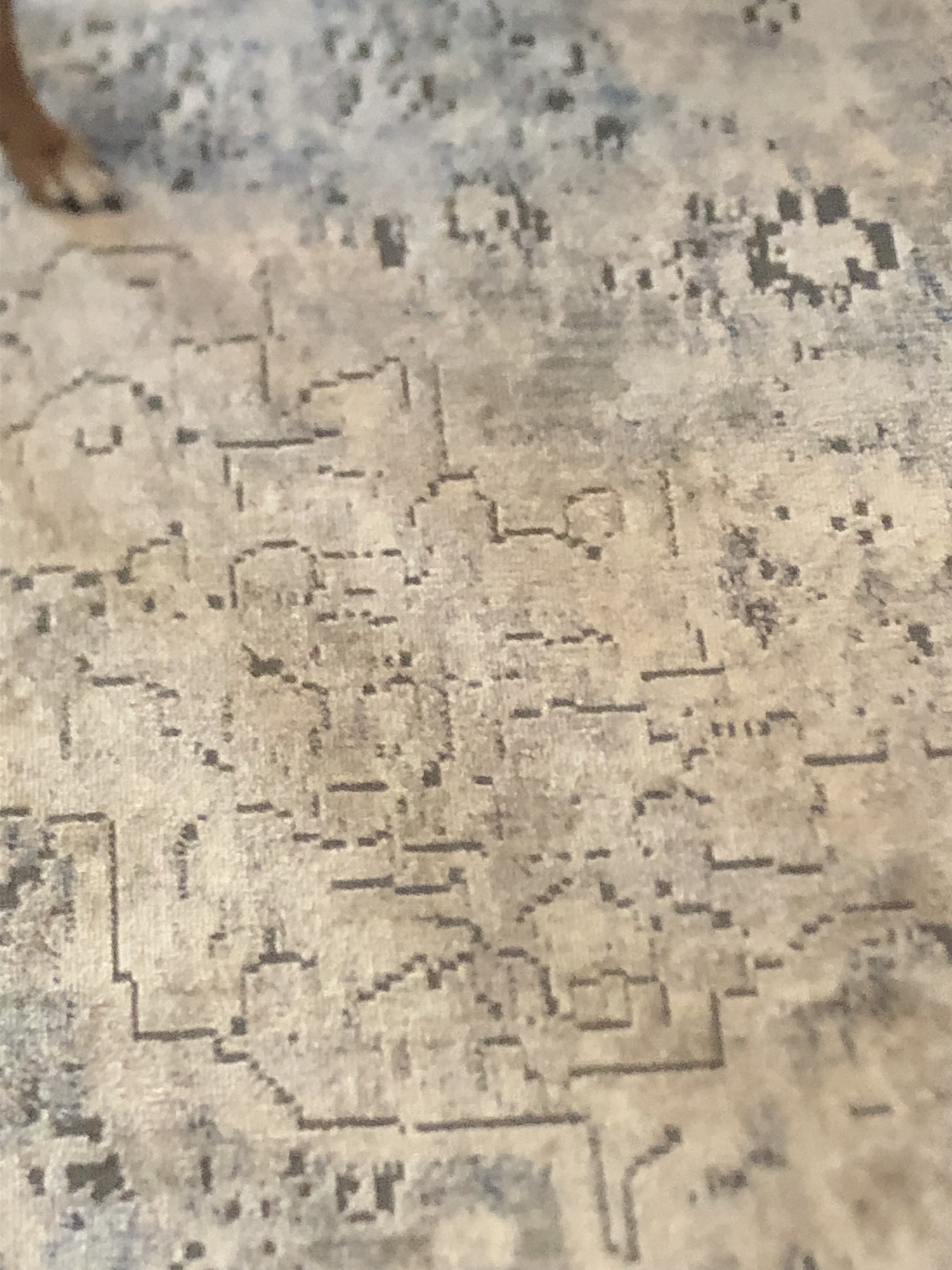

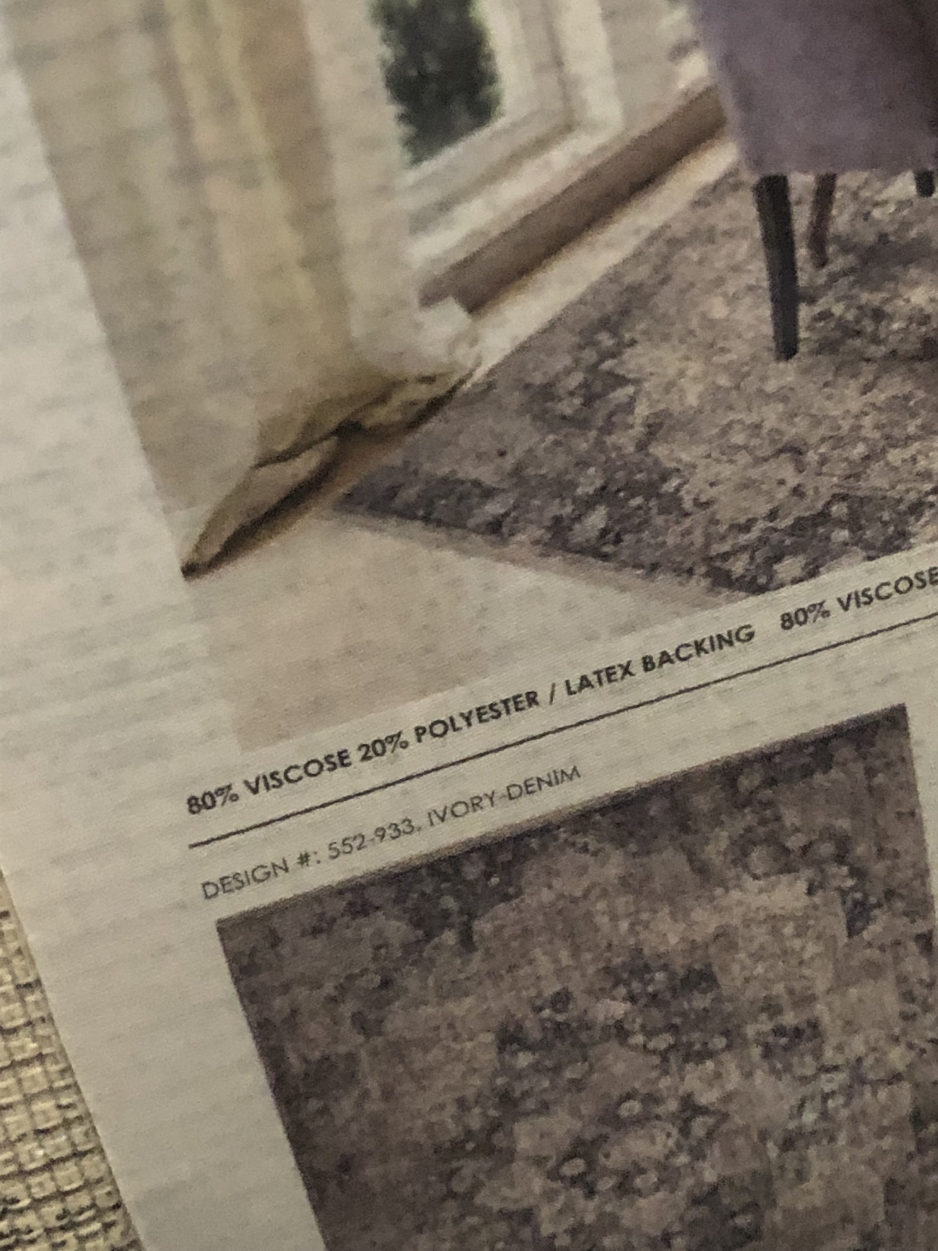

I’m glad Brady caught this and didn’t clean it
Would you have cleaned it?
I do them in the shop with a signed waiver. Viscose rugs are all over the map when it comes to results. I have some that clean up beautifully and others that distort at the very thought of getting it wet. We use cold water, a neutral pH prespray, sometimes soured to be a little acidic and a neutral pH rinse. I wouldn't think of doing one on the customers home.I’m glad Brady caught this and didn’t clean it
