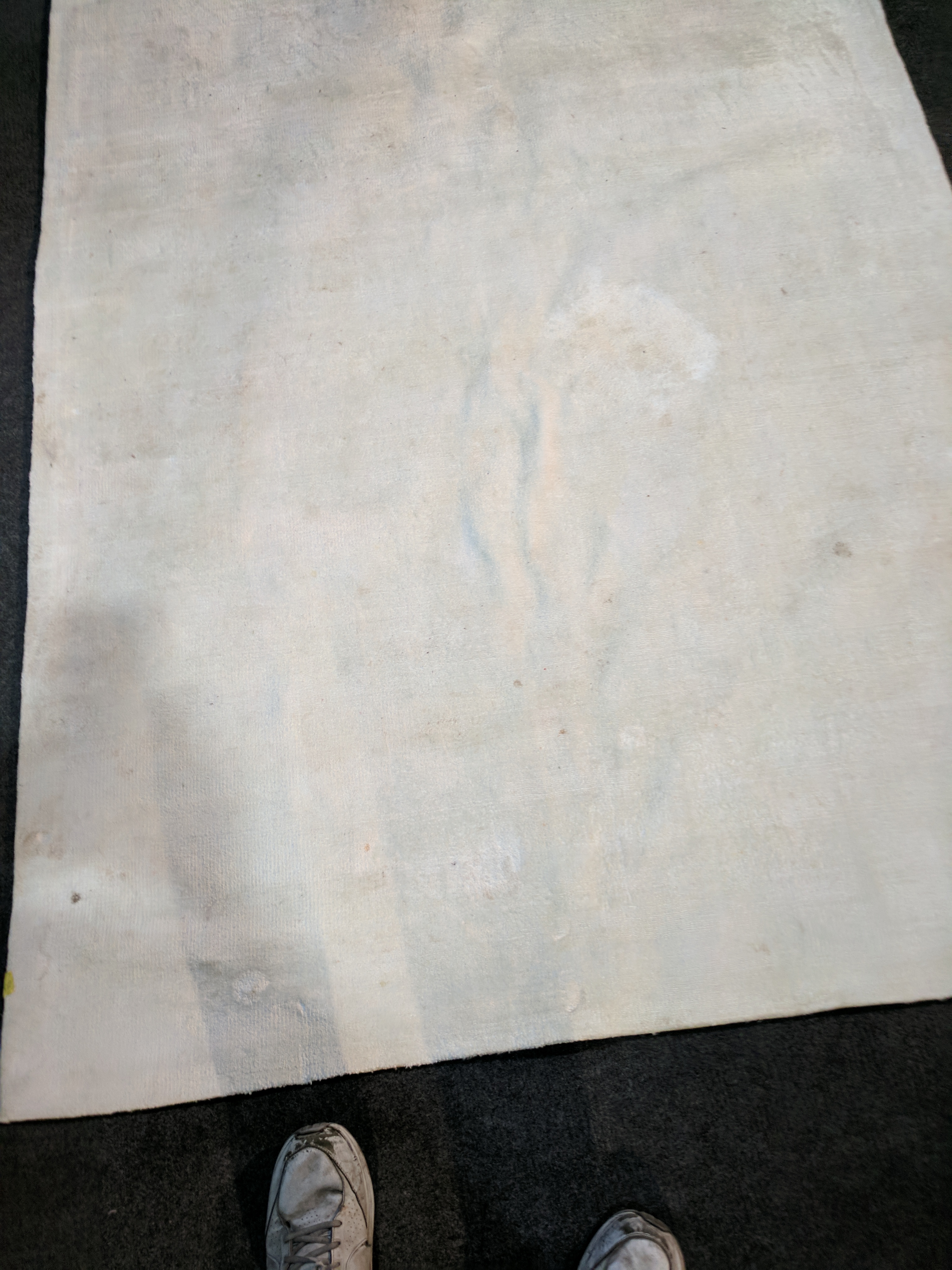

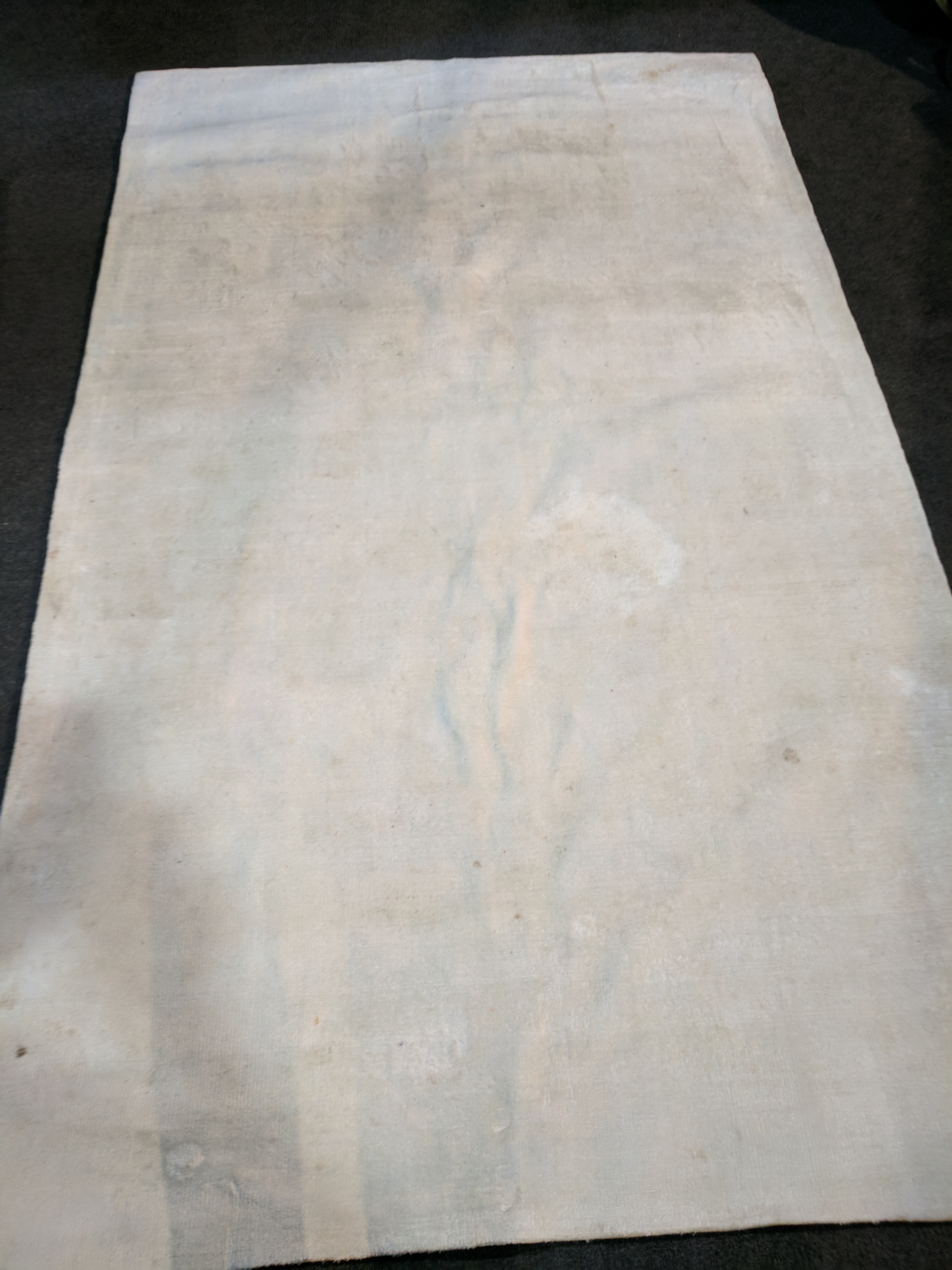

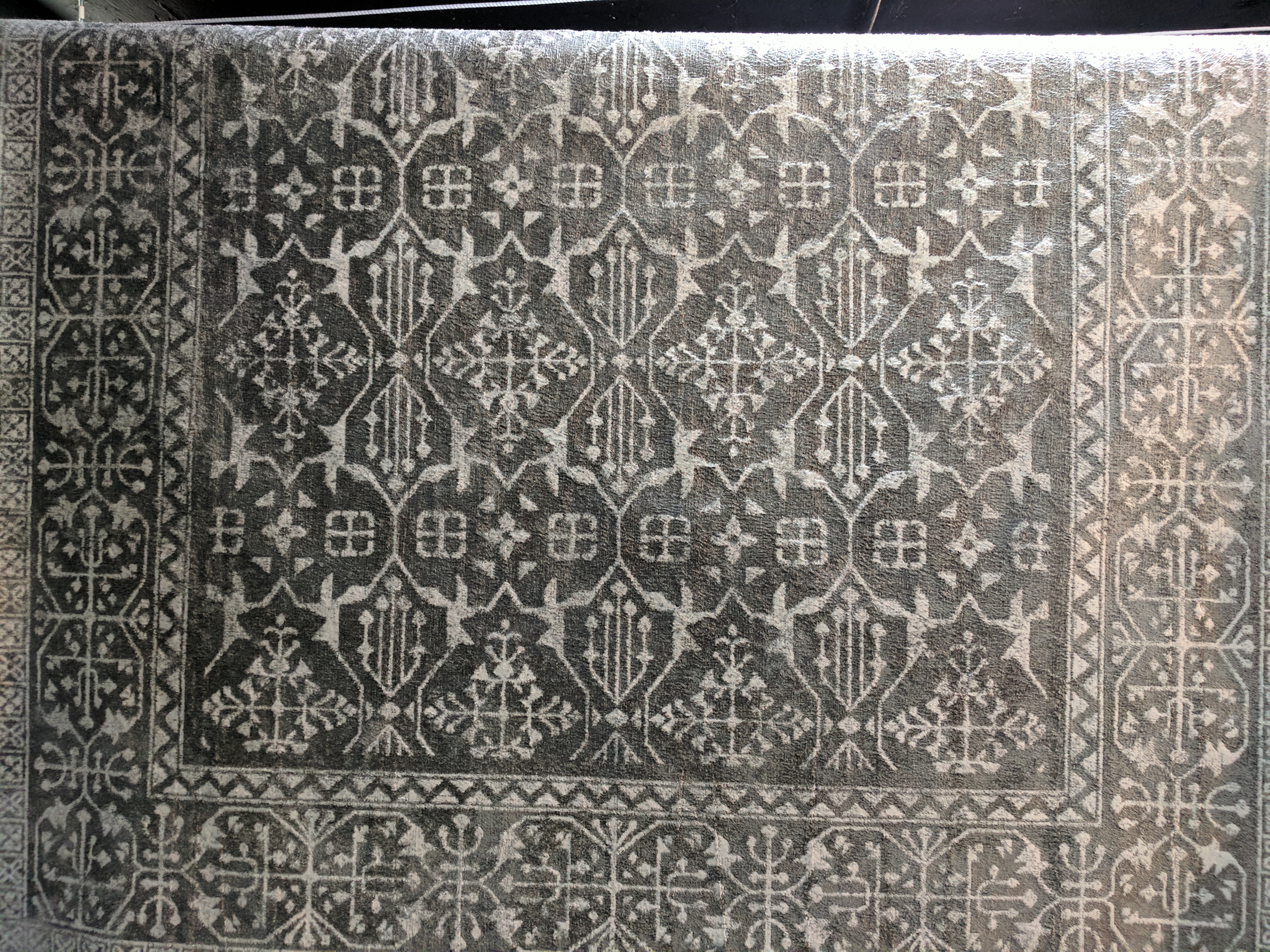

Here is a viscose/cotton rug that the customer has me permission to destroy. (That's how I word it to the customer and they understand they have to pay me to fix or fook their rug). I presprayed it with Prochems fine fabric prespray, let it dwell for a bit. Then shampooed with a shower feed floor machine using Prochems fine fabric shampoo for cotton. Rinsed using a wand and groomed. You can see the textural changes and matting but better than it was and when it dries, we can groom some of it out. Most viscose don't clean up as well and most, we could not use a shampoo machine.

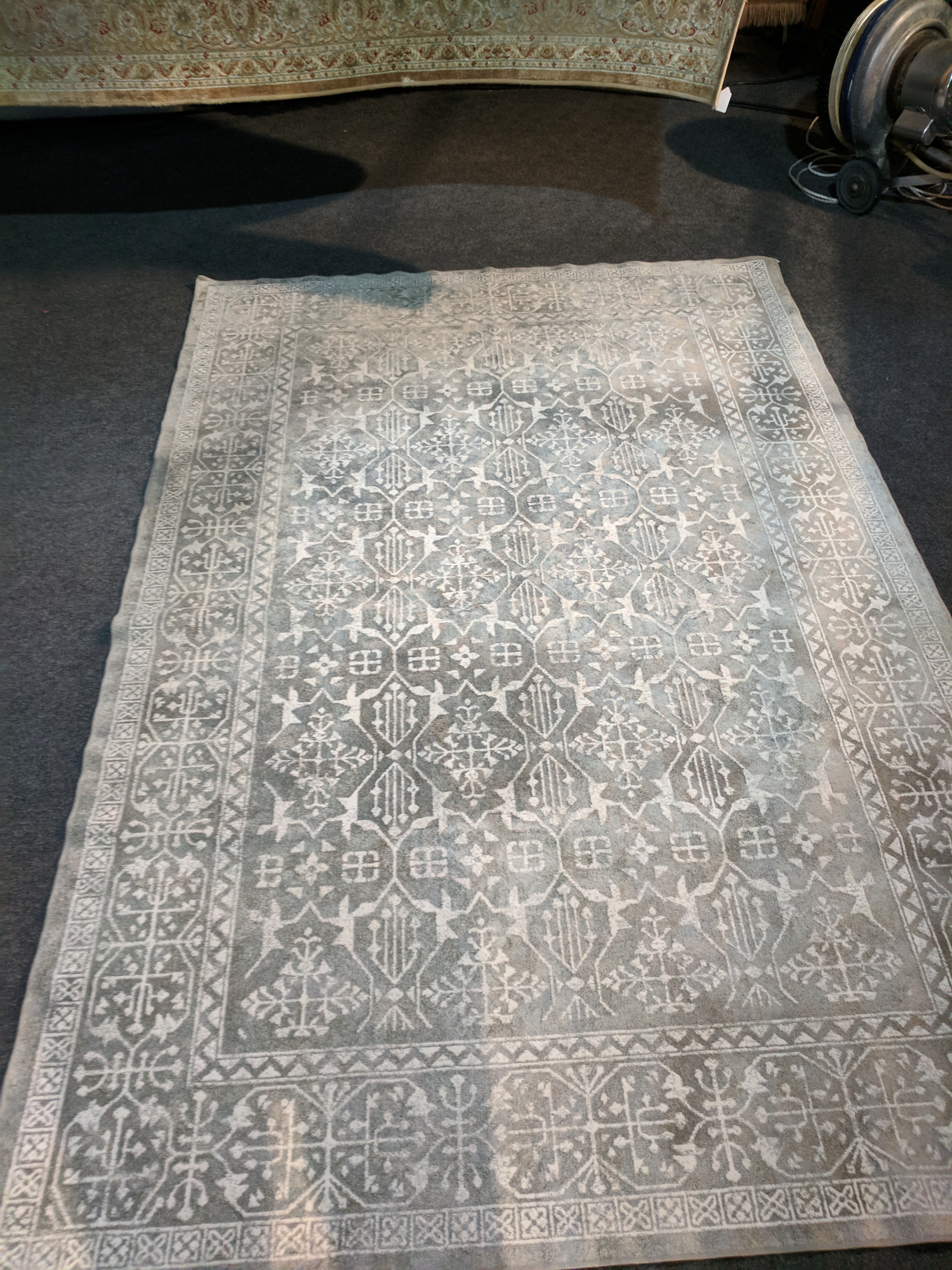

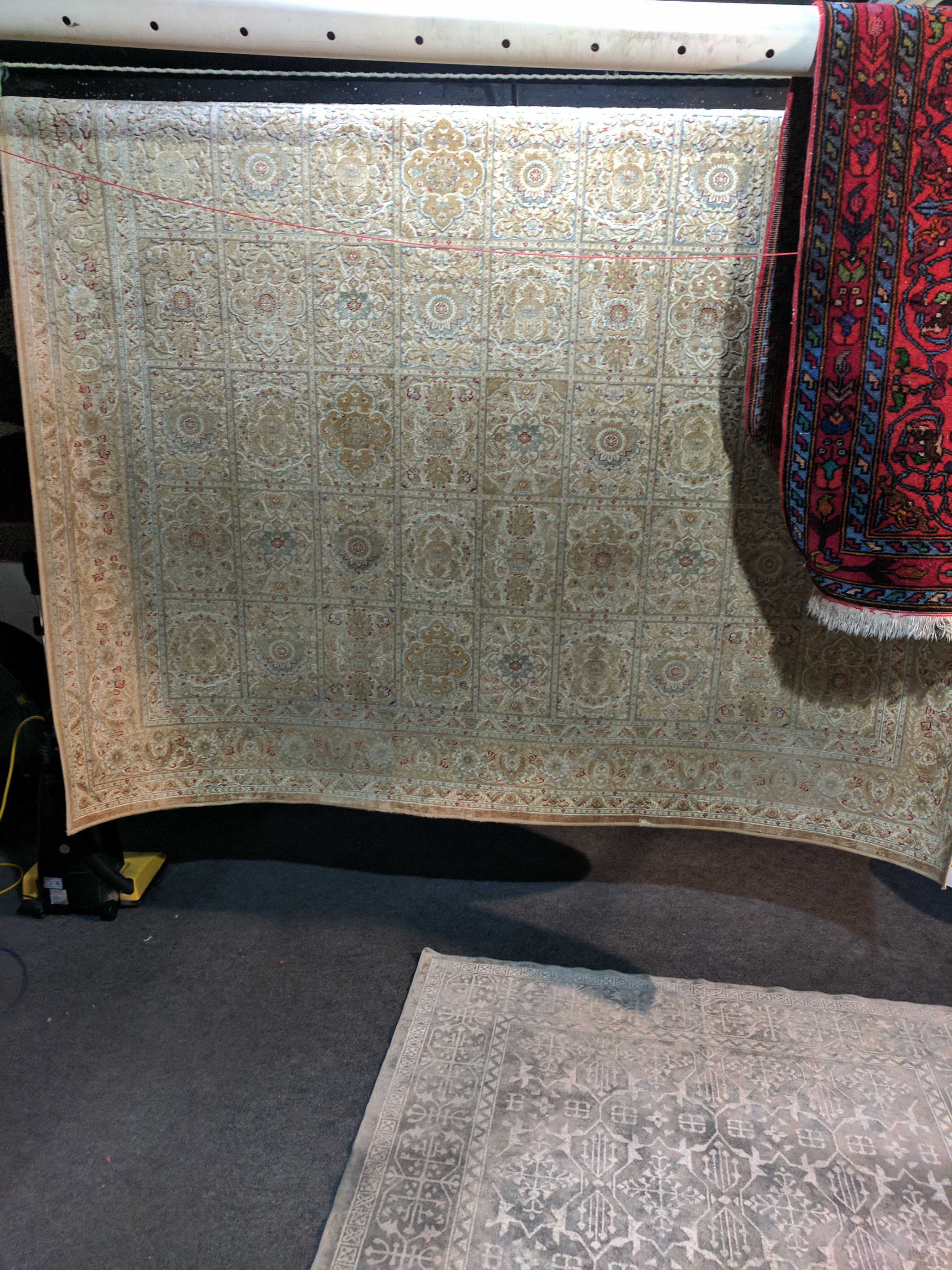

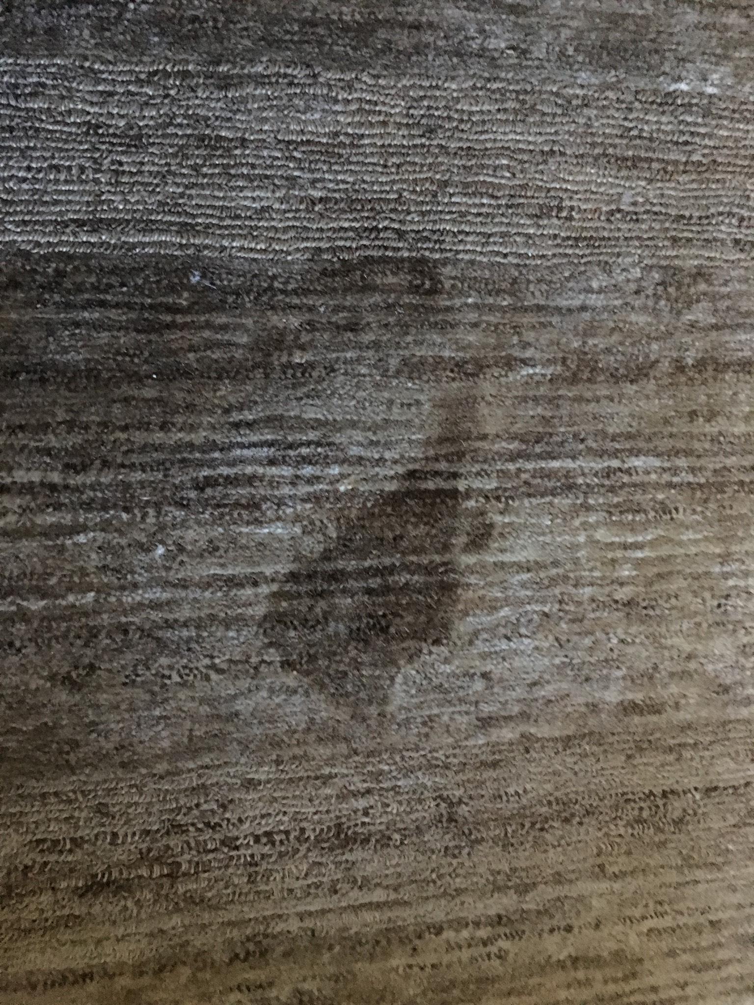

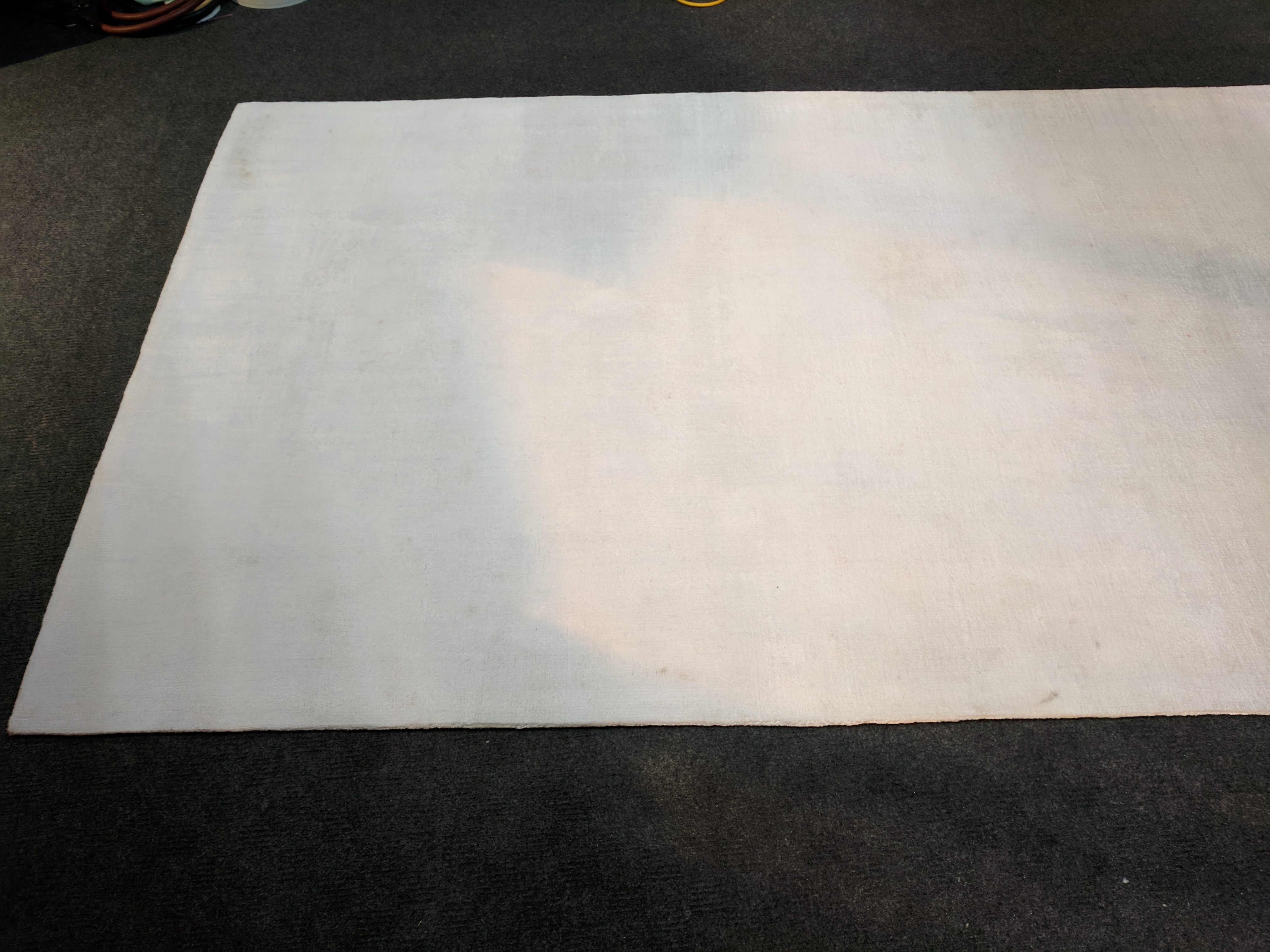

Here are a couple more viscose rugs that we cleaned at the customers risk. The brown one is an 8x10, fairly thick. You can see some matting but overall not too bad and some of that will come out when it drys. The smaller grey one is paper thin and had a buttermilk stain on it. We used a mild prespray then rinsed with a wand using lukewarm neutral solution. Deodorizers with Benedict. I think it's very acceptable however, I have had similar rugs distort, mat and have severe pile reversal. As long as the customer is willing to accept the risk, I don't mind cleaning them. The more I do, the better I get.

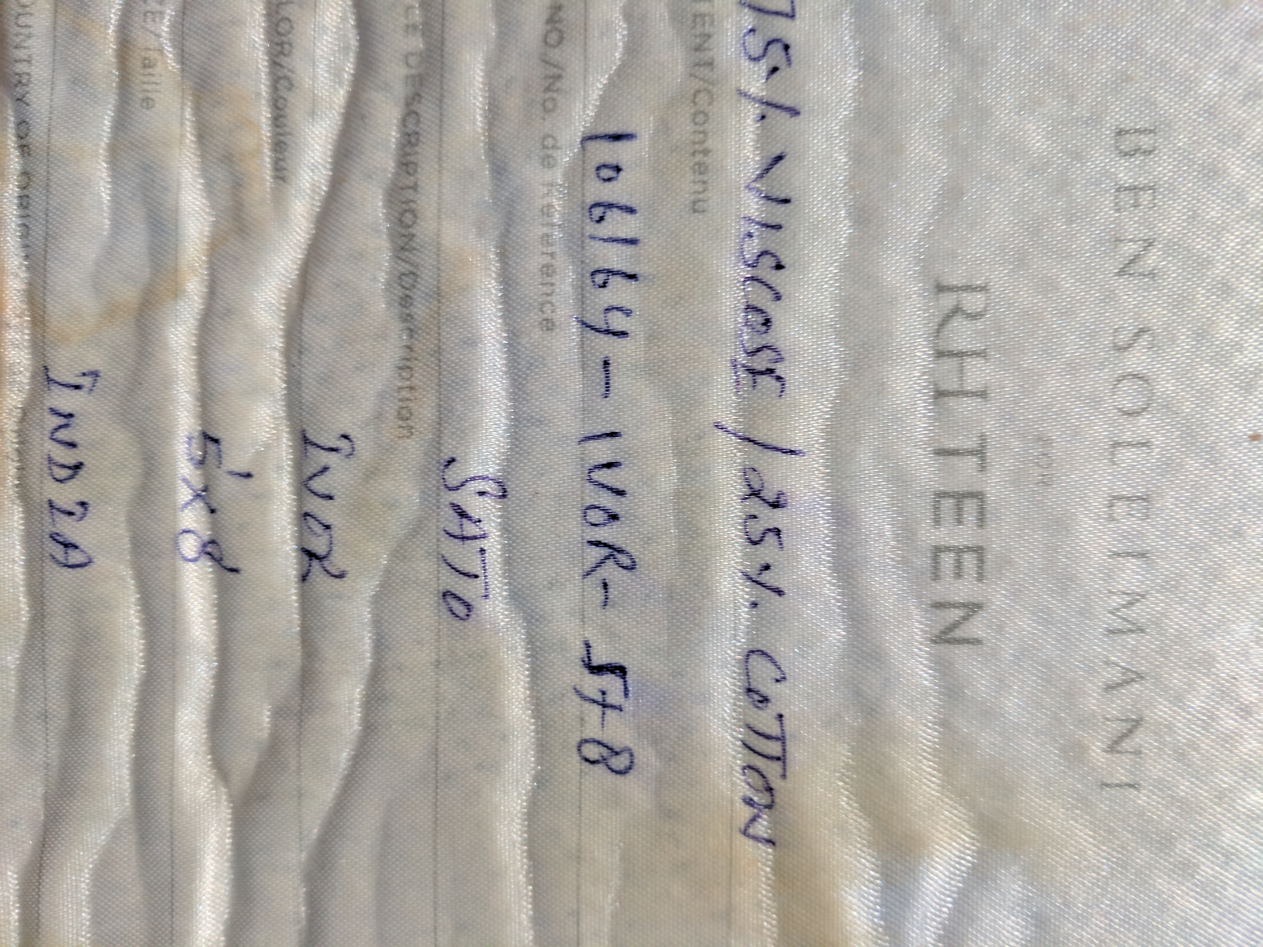

If the label says 'Ben Soliemani' you know two things: it was expensive, it is unbelievable crap.
img_20171224_140313-jpg.76546
Hand-loomed rugs that have this backing might be the worst. The latex is likely to wick up if you wet clean, and if they get any normal foot traffic they will come apart in about 18 months time. Often rows of tufts will come our when pre-vacuumed.
Identify hand-loomed by breaking the nap open and looking for a weft fiber between the tufts. Tufted and knotted rugs won't have that.
