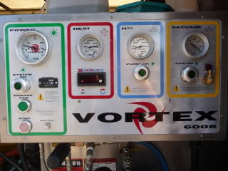

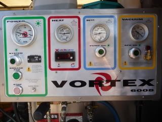

the front of the panel is the same as mine so locating where each switch is will be easy....I printed off the picture that you posted from the other thread and I will take it out to my truck and start using it and tracing everything back and see what I can come up with.......it will probably take me a few day because of running my truck and a few DR appointments that I have got to go to...next time it happens...don't pound on the panel....lightly tap the stop switch and see if you can here it click.......and let me know......for shits and grins..check the high level float there has been a few time that the pressure in the tank has blown mine up and killed the machine......stay tuned..

Mike I need the Electrical system diagram from your book..it looks like this...............
as you can see......this...(yours)...
and this........ (mine)............
are 2 different animals.....and there is no way I am going to be able to trace yours off of mine with out the drawing....
