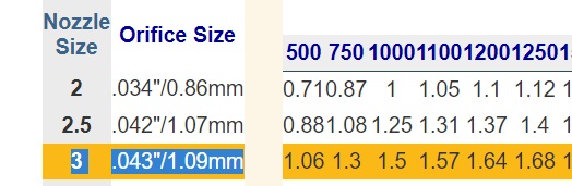

Correct me if I am wrong but the numerical value of what flow you are running is based off how many gallons per minute will flow out of a given orifice at (I think this is right) 4000psi.
correct, but believe the psi/flow rate calc used by jet manufactures is at 40psi
If I recall without googling, an 01 jet flows 1 tenth GPM @ 40psi
but not sure if it's lineal ....cause I don't "think" an 01 jet flows 10gpm @ 4000psi

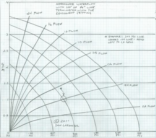

Don’t listen to those meatheads above. Just follow the chart to the specs on your water pump on how much gpm it can put out
Reactions: FyreLyter
14,624
I need you all to help me understand "flow" as it relates to carpet wands. I understand that higher flow results in more water, but how much. When you say "my wand is 9 flow" what do you mean?
Can you tell use what machine you’re using on that wand?
(corrected for friction loss by Dan G)

We refer to flow as it relates to the size of jets you have on the wand. 3-11003 jets will give you a 9 flow. 2-11003 jets will give you a 6 flow and so on. Has nothing to do with GPM, it's just the size of the jet or jets.
Reactions: steve_64
I guess in the sense that we refer to it......meaning not usually having any idea how much....or at any standard pressure
but that last # in the jet size it what it will flow in gpm @ 40 psi. Each of those 1103 jet would produce .3gpm at 40 psi (not particularly useful info for our application)
increasing with psi.............as per chart above
