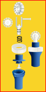

Please call the Grout Wand Company and ask them why they insist on using non Viton O rings on a tool designed to apply solvent based products.
I can't tell you what a treat it is to get half way through a 2000 ft tile sealing job and have your brand new applicator fail. There are two O rings on the plunger that swell up and cause the wand to let the sealer drip out non stop.
I have gone through way too many of these wands due to this exact problem. This could be eliminated with .20 worth of Viton rubber.

Larry Cobb needs to be the first one to call those guys. His sealer kills that stock rubber.

The cap assembly has a simple acme thread pattern, and the stick relies on a flat rubber washer, so it's "possible" to make a custom loooong hollow handle and machine to match those threads. Then you could just buy the POS o-ring leaking plastic replacement heads and be at least one step ahead, and a LOT more comfortable.

I've already done it !
I complained to Hydro-Force after we discovered the problem a couple of months ago.
I asked them to install Viton o'rings for better durability.
Most of our customers are using the wheel applicators.

Hydro-Force?
I'm pretty sure I bought mine in a hardware store somewhere?
Larry, how hard can it be to match the orings?
