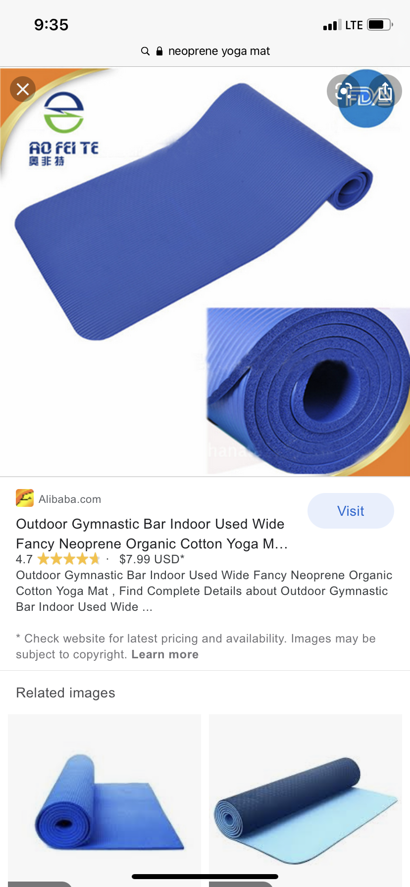

This is a great idea.Go get a neoprene yoga mat....
Cut to suit....View attachment 105382

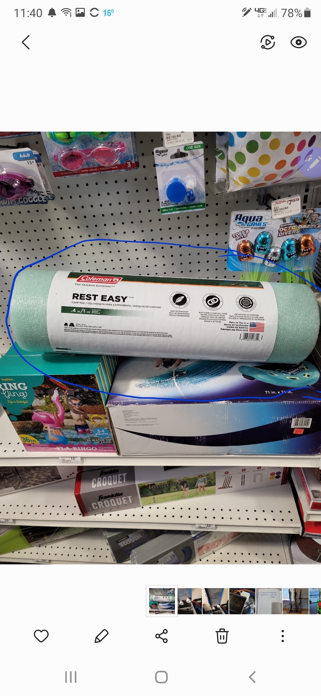

Your looking for one that has a smooth surface on one side.... almost like a smooth rubber.... it creates the seal...How about this?
Looks like what I use.

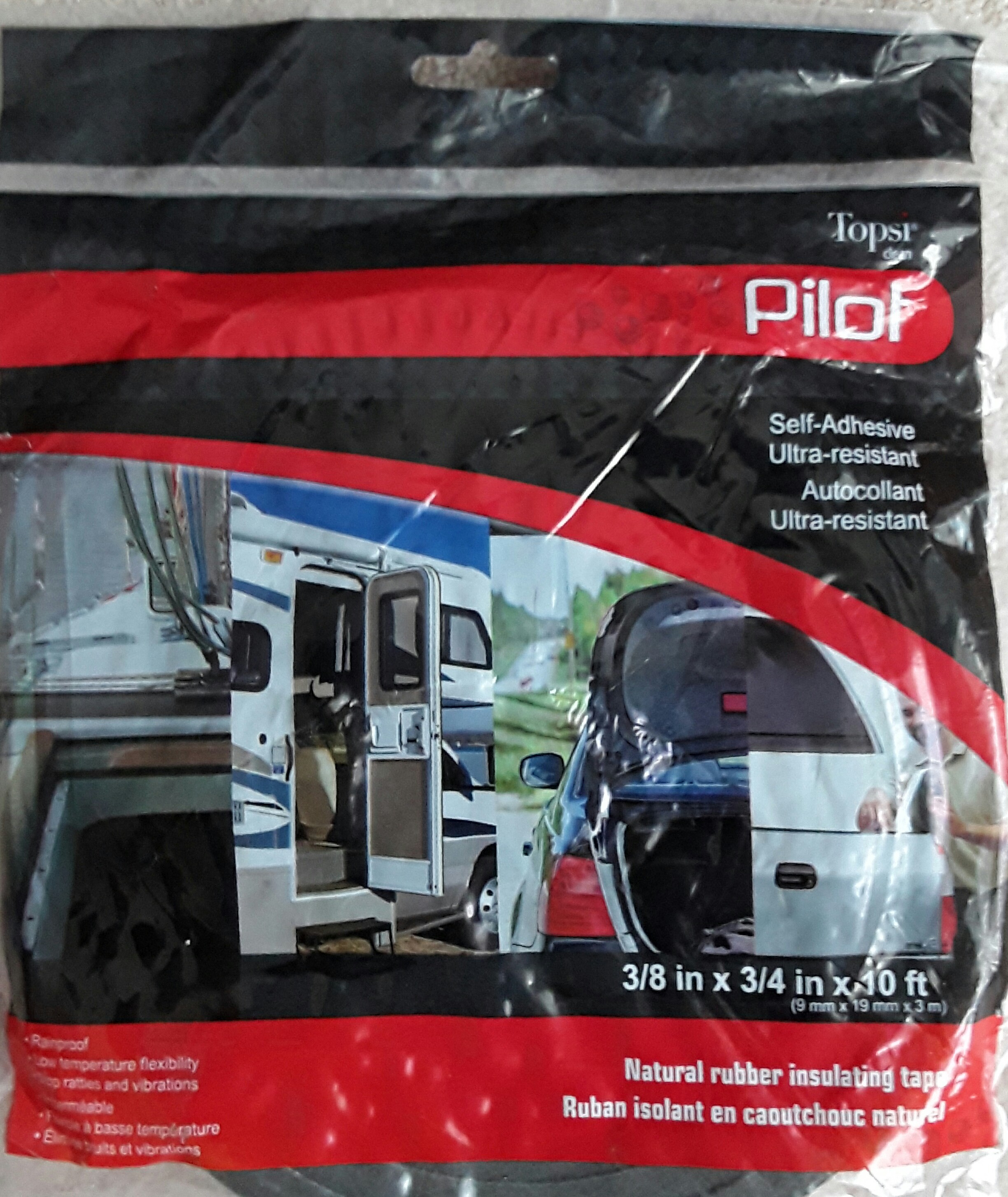

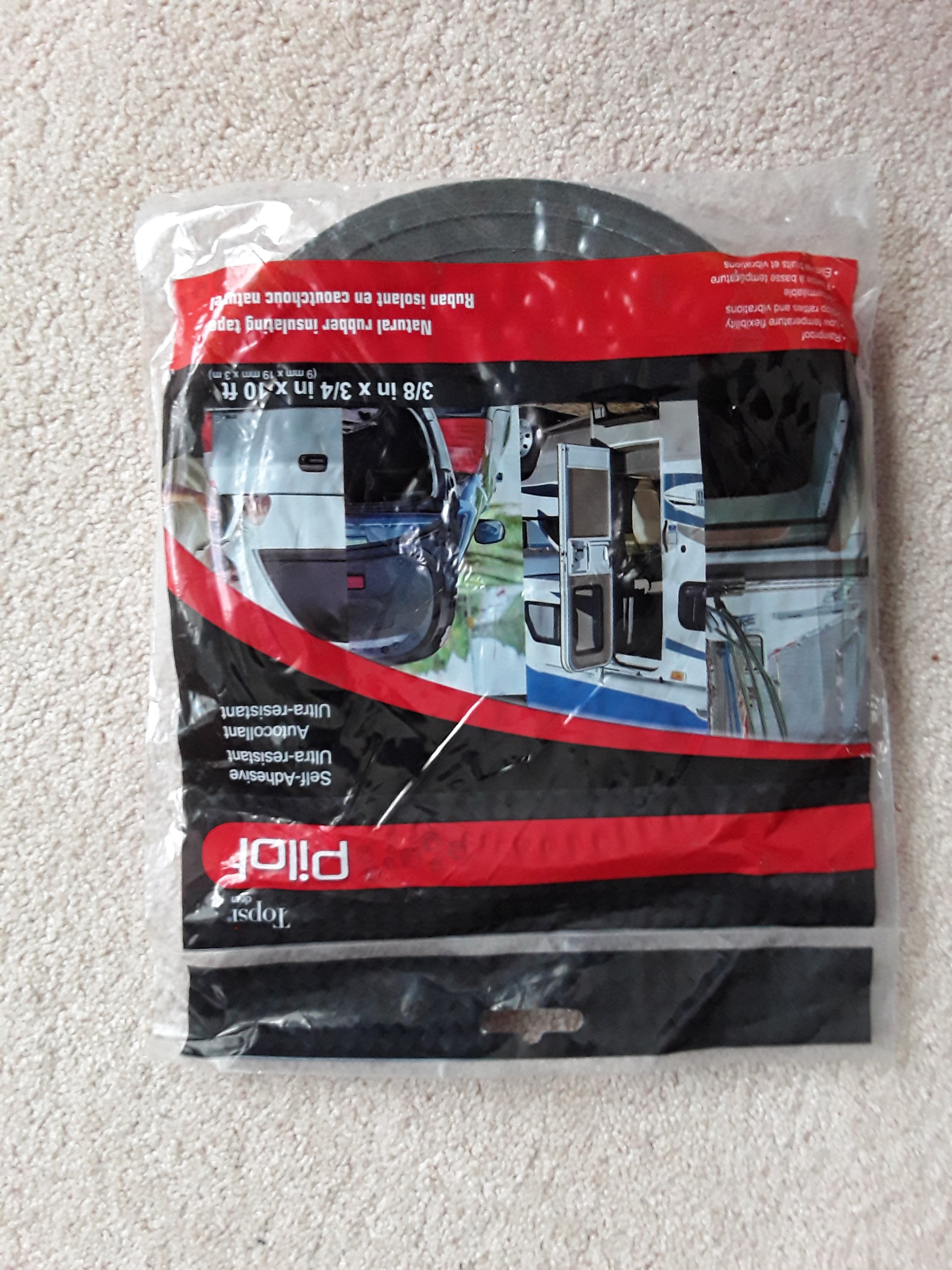

I was looking at that spray yesterday. I see Gorilla Glue makes one also.When using the truck bed seal I use 3M spray adhesive. Once you put the tape down it won't come off without tearing it.
What is the product? I need to change mine.Ya Lee
..I jus SED that!
Cides the tape that Tom has uses
The stickiest of sticky on one side
Just glue the Yoga Mat on and then trim it after it dries?I use gray anti-fatigue floor mat from a bulk roll at Lowes. Kinda like the above yoga mat, but probably heavier. Has lasted around five years.
Actually, I took off the waste tank lid, and the blower lid. I scrapped off the old stuff, cleaned the heck out of it, then cleaned it again with a solvent. Once it’s COMPLETELY DRY, I then took measurements of the interior of both lids. I used a sharpie, a yard stick, and traced it out for both. I then lay the mat on a piece of plywood, use the yard stick as a guide, and cut it with a new snap blade. The width was around an inch and a 1/2....Just glue the Yoga Mat on and then trim it after it dries?
That won't last long. I need to use glue or caulkRead the package. Self adhesive. Peel and stick after surface preparation.
