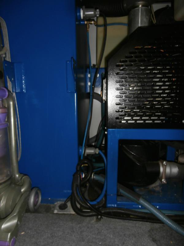

is it laid out like this....top float switch is the high level shut off...
bottom float switch is the APO on/off switch...
and the very bottom is where the APO is plumed into the tank.....
