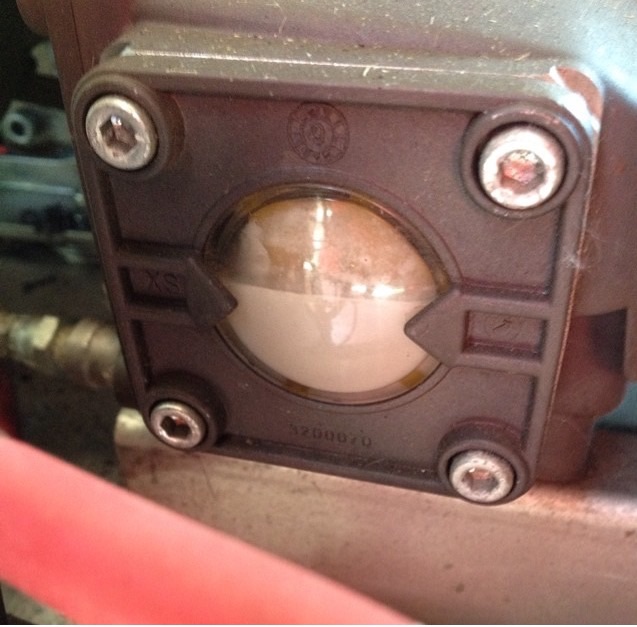

water in my cat
A
Aero Tech XT
Mike, Thank you for bringing this to our attention.
The brass seal that you have shown is actually exposed to the atmosphere....meaning the corrosion is occurring from the outside, not inside the pump manifold and from a contaminant in the water.
Here is a picture of the water pump.
Here is an old manifold we had laying around showing the seal.
so.....what is corroding the exposed brass? I would suspect its from water dripping from the vacuum hose as it gets rolled up....???
A
Aero Tech XT
Or...
The AT is not Last Step injection like I thought and this is the result of the MW 02 rinse I was using..
Yes our chemical injection system is a last step injection. The diaphragm in the chemical pump is rated for 1500 psi so it wont be effected when cleaning tile and grout. We also have the ball valve between the chemical pump and water pump so you can shut off the chem pump when its not needed.
The only way chemical can get into the water pump is if the diaphragm fails. If the diaphragm fails, the flow meter would be showing a chemical draw when your not triggering the wand.
