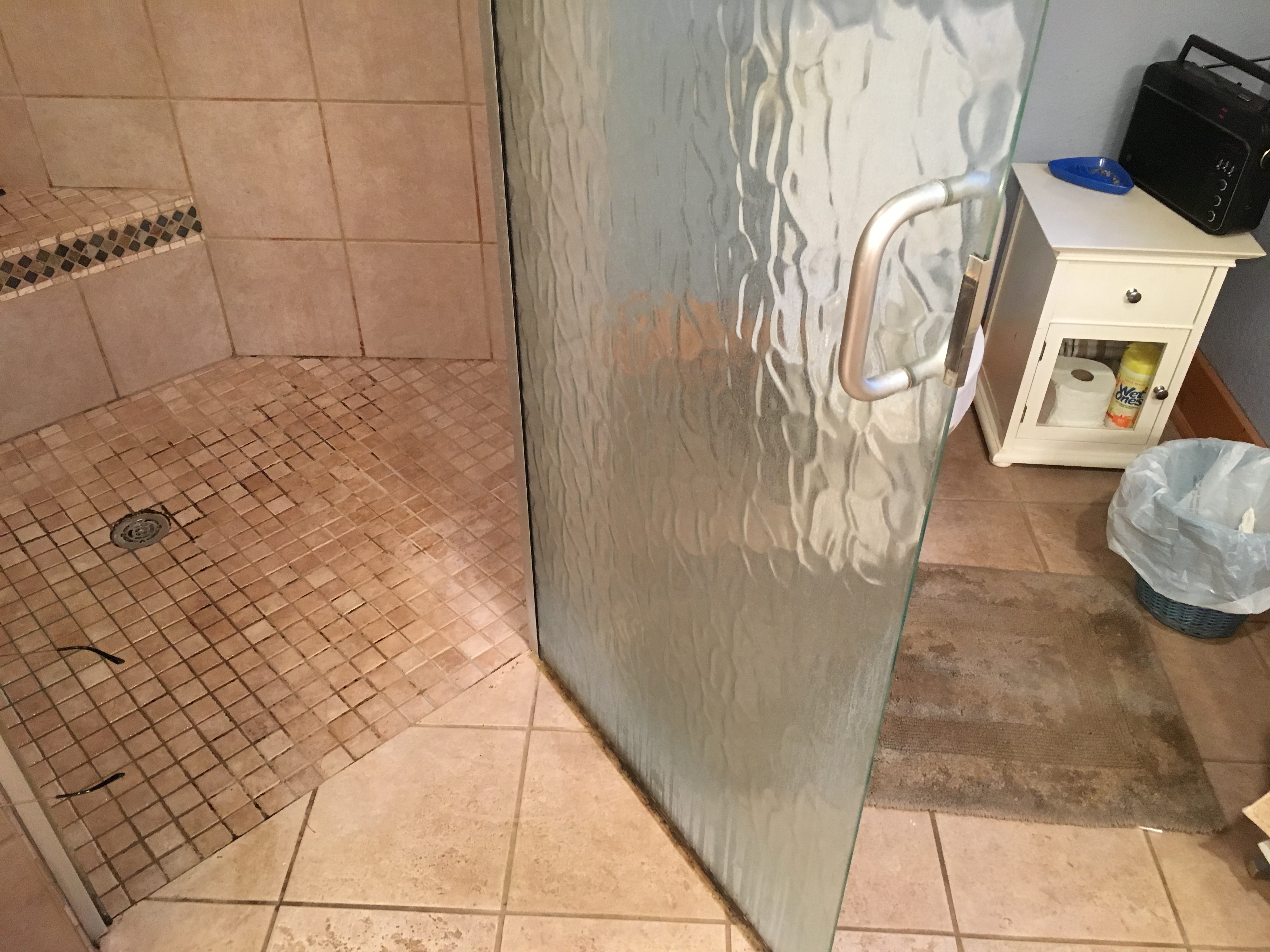

What do you use to get soap scum off glass shower doors and
14,126
Reactions: Nomad74
DAT
Apr 3, 2017
6,486
Nevada
Bill Cheryl
A PTC. Get the one that clings for better dwell time. For glass, may need strong scrubbing with op or rotary. If it a lot hard water, i have been using oneRestore, but you have to check if it is hard water otherwise it wont work. I recently used stone pro scrub..worked great

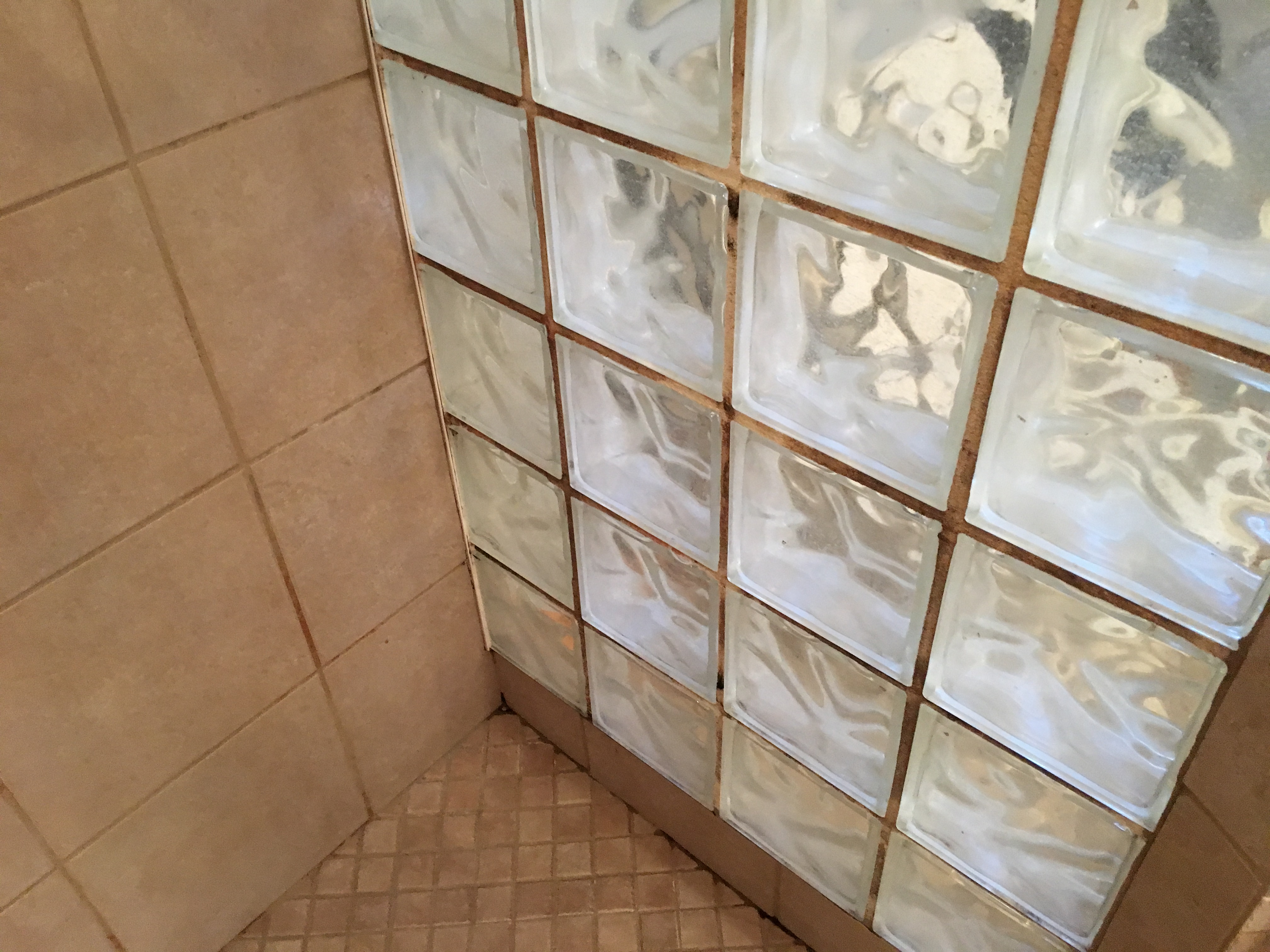

Sometimes the glass blocks aren't glass. There are plastic glass blocks...for some reason. Quick check before you throw acid on it.
Reactions: Neil E and BIG WOOD
14,126
I've just placed the order of the water stain remover and the steel wool. I scheduled this job for the 10th of January, so I'll let you know how it goes. I don't know if you saw that tile also... This tile is 7years old and has never been sealed. So I"m gonna have some major mildew stain problems also
