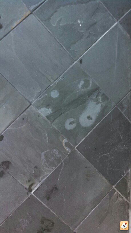

What is causing the white spots on this slate?

I would suspect moisture trapped under a finish or sealer. USe an air mover or a hair dryer blowing across the surface (not down into the stone) and see if this corrects the situation.

agree with scott slate is void of calcium so it isn't efflorescence nor is it etching from acid since it doesn't have calcium.
116,689
Efflorescence from the thinset below

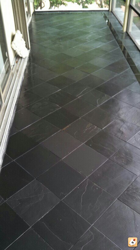

Where are those tiles installed?

Back patio of condo 2nd floor water side. :D

I didn't take a closeup of the spot after, but here it is after dry treat enhancer.
You can barely see it left side near sliders about middle of the pic.

Go back in a month (or less) and take notice..
Like I guessed before, thinset minerals...
