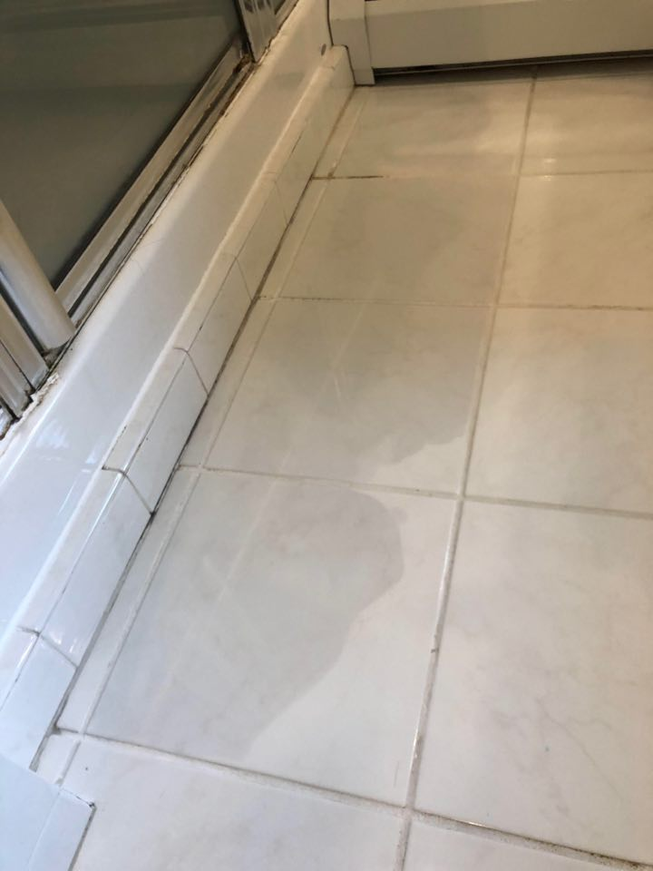

What the heck is going on here?
116,040
Not my project, sent to me from a cleaner...
Client has no clue
Looks to be water intrusion but I've never seen translucent porcelain...

Water intrusion I’ve seev it before. Shower failed or there’s leaking plumbing. Most don’t realize tiles not a 100% waterproof especially if the water gets underneath

I have actually seen that many time over the years as house cleaner, never gave it a second thought until now.

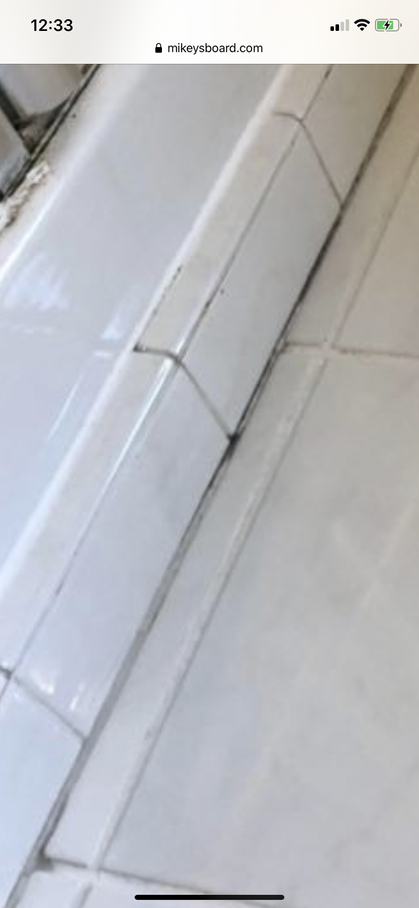

Is it a camera artifact, or does the darker color go up onto the base/baseboard heater/whatever is on the wall? (Pic #2)
If that's water below the tile, I'd like to know the condition of the substructure.
Almost looks like it’s crept up the tile in this photo aswell...
