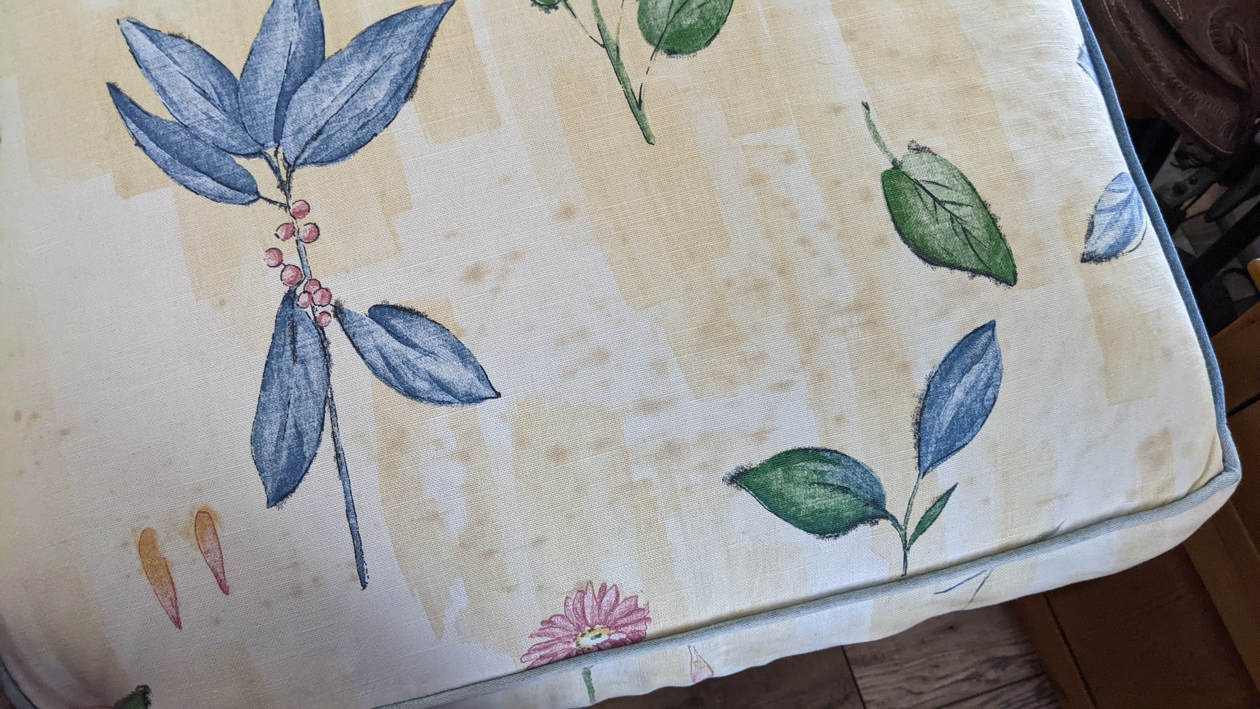

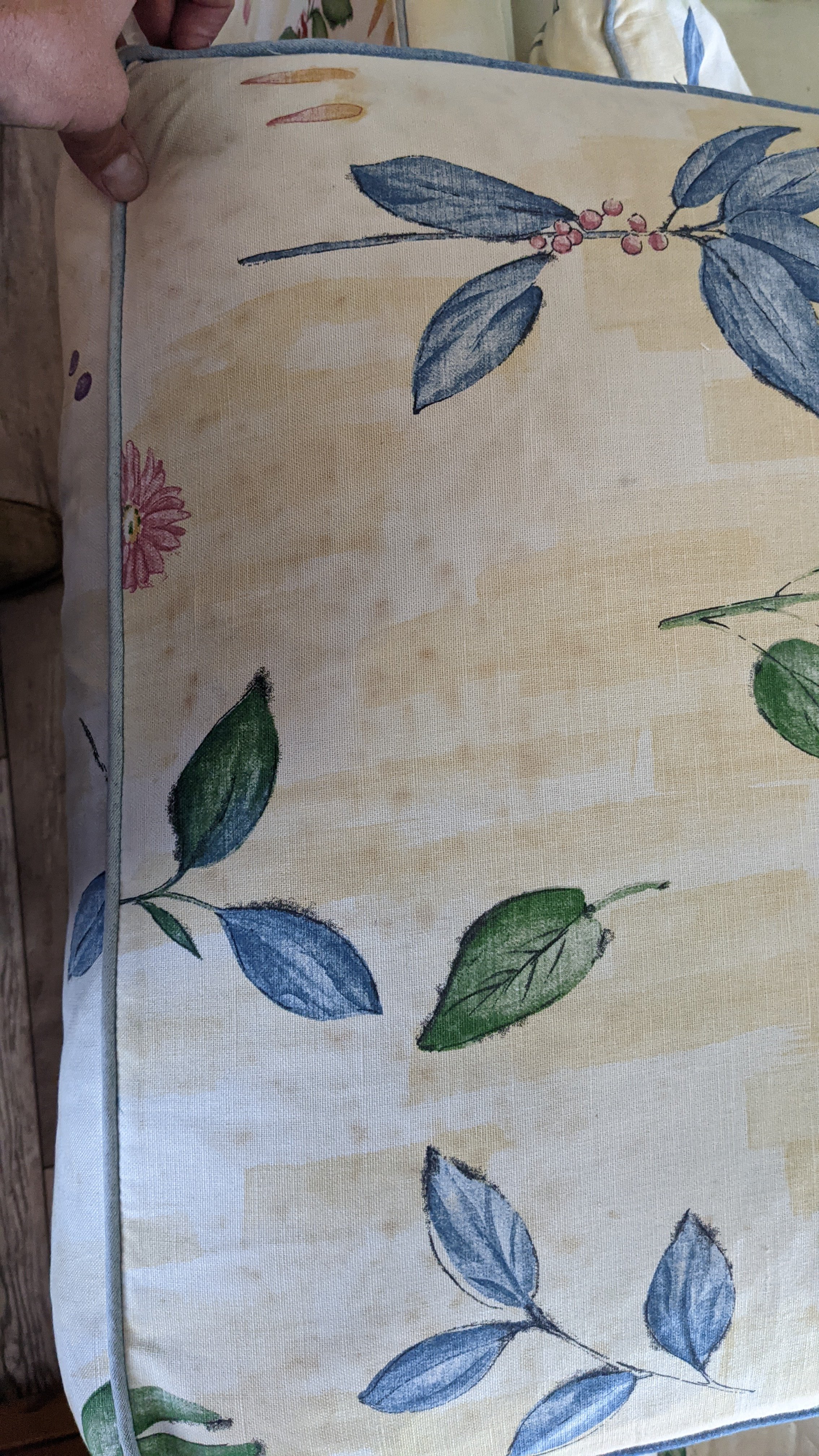

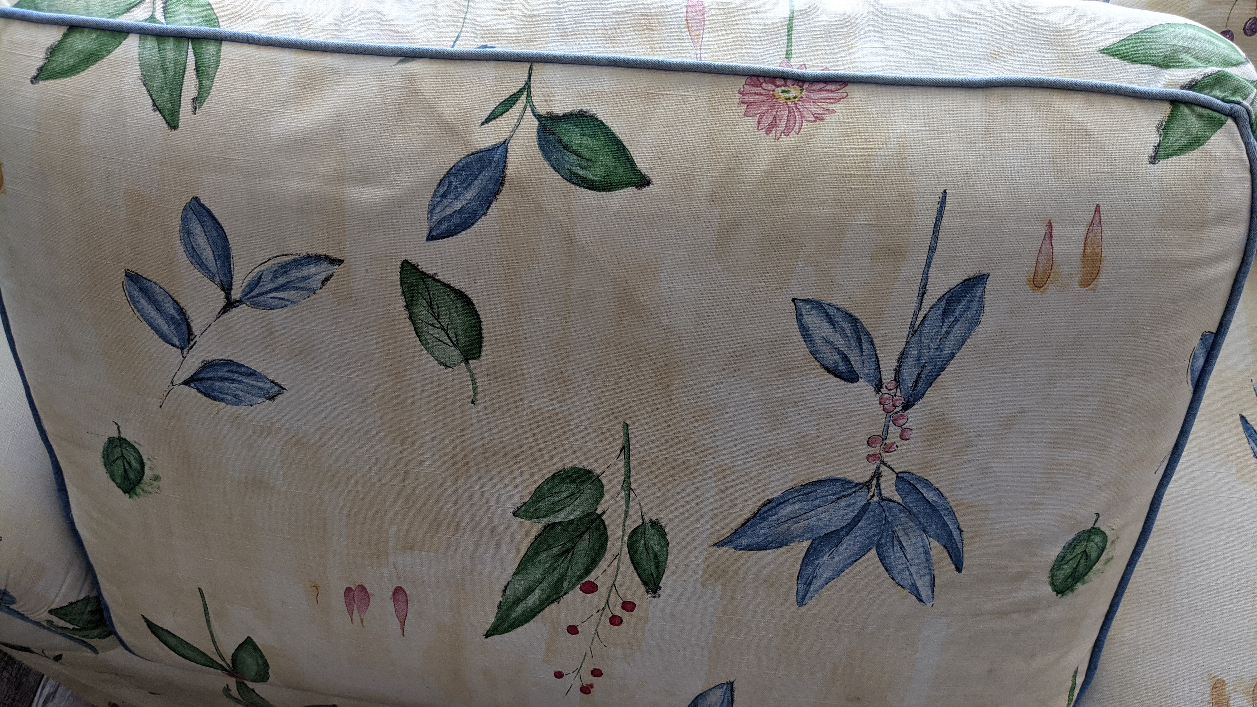

What the hell is going on here Jim?
117,232
15 years old
Cotton
Polyfill no feathers
Never been cleaned
Does not live in front of a TV set...
12,834

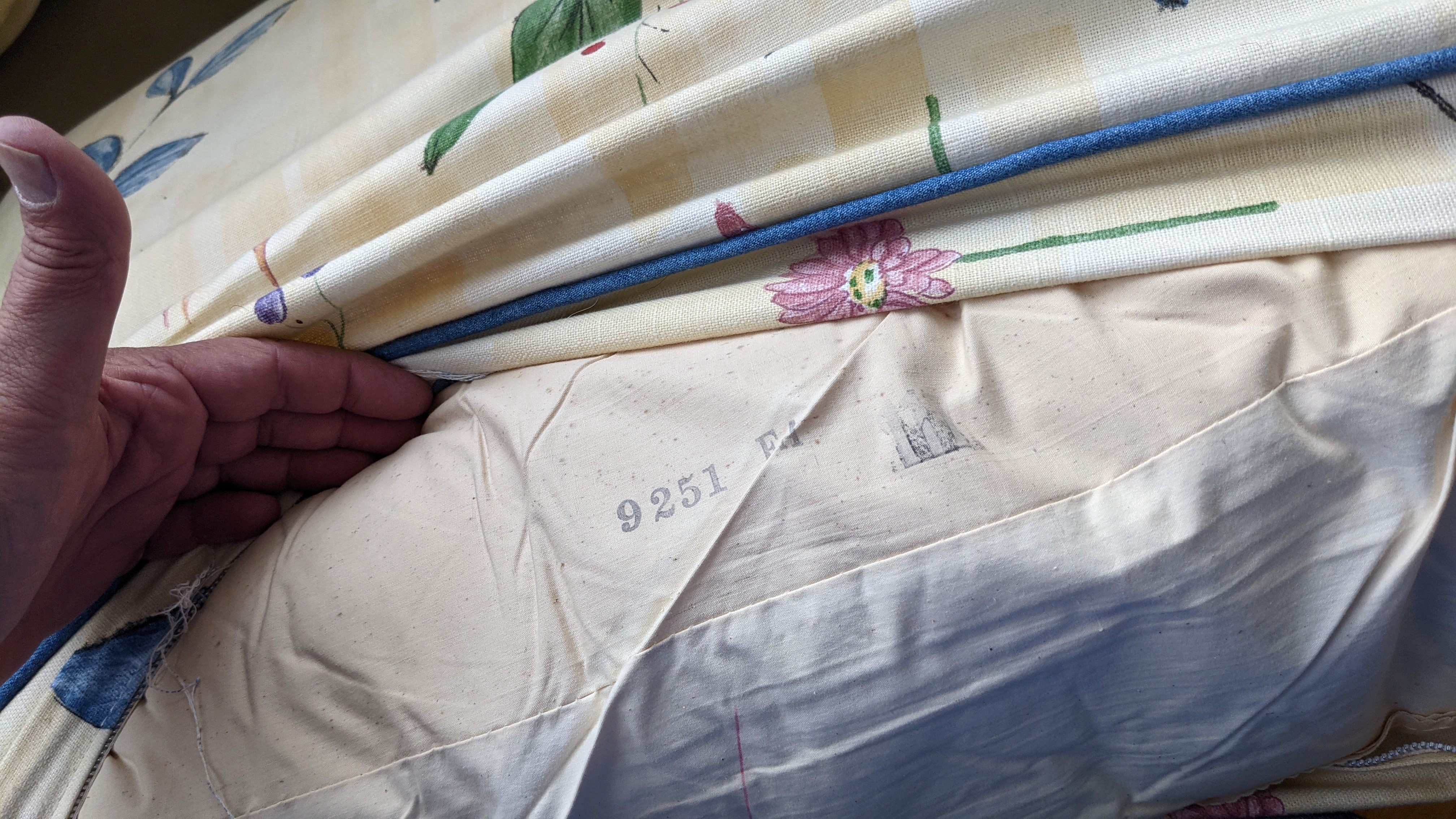

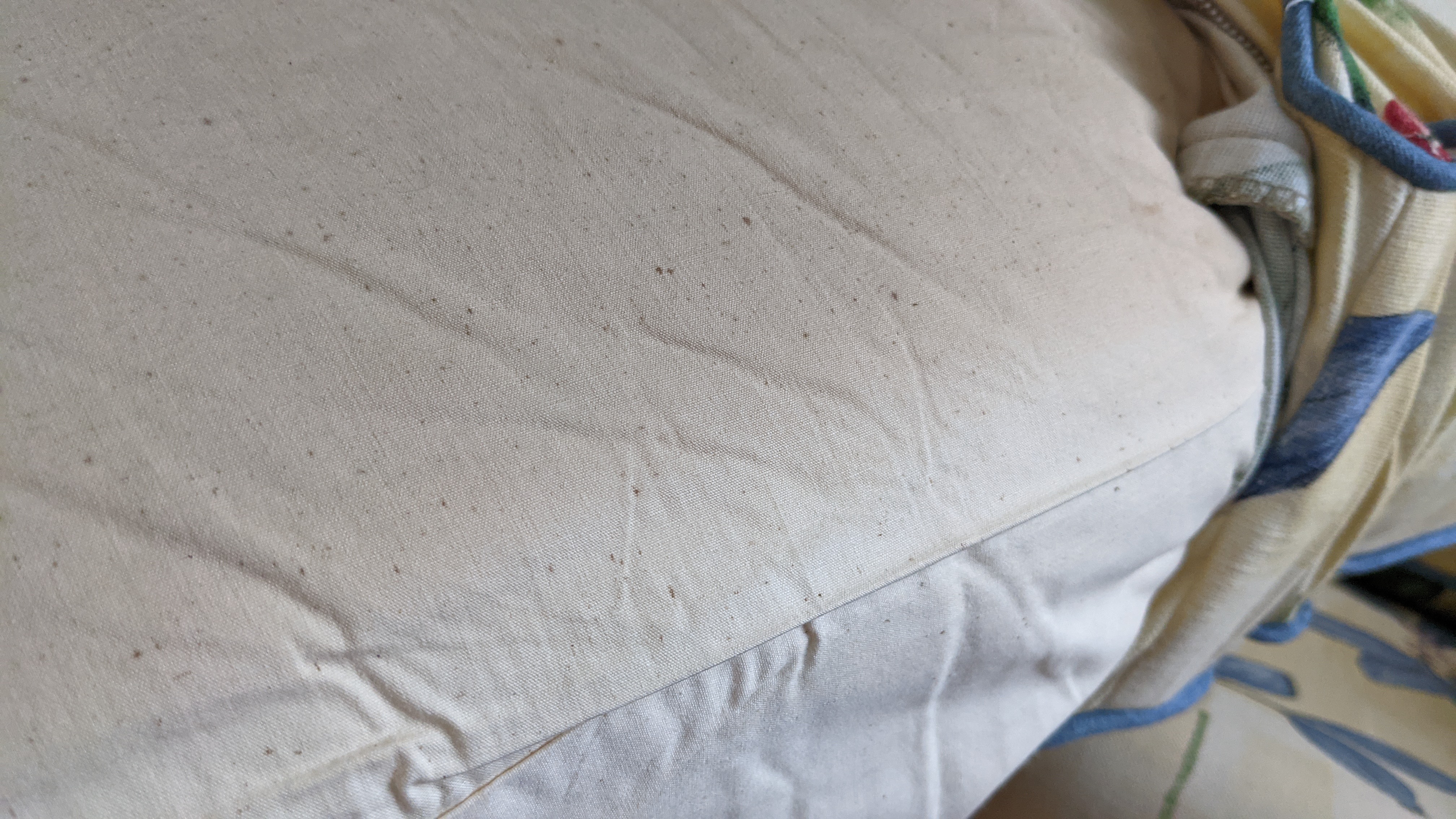

The spots have the appearance of flame resistant treatments, and both upholsterers and manufacturers have been known to use flame retardent ticking even if not required.
But those long parallel brown streaks scream "somebody tried to clean it".
So one or the other or both.
You were, of course, wise to not do it.
Did you ask them if it was sprayed with protector? Is it possible they applied a water base protectant on their own?
24,146
fire retardant treatment is my guess. Like Fred said, I first thought it was Haitian cotton seeds but if it's poly, then I would go with the retardant, especially if its from the 80's or 90's
28,263
somebody cleaned it. That's mainly cellulosic browning. Fred could be right about those dots though.
